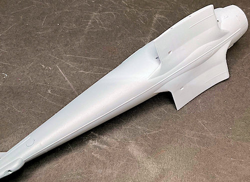

Hi Bertl,
As you know, LFG Roland engineers developed and patented a technology for manufacturing fuselages under the name Wickelrumpf.
This consisted of two layers of long plywood strips wrapped diagonally around a mold and covered with linen fabric both inside and outside.
The fuselage halves were separated along the centre line, like the British De. Havilland Mosquito of WW2.
Not many photographs show a covering strip along the fuselage centre line joint.
However, it seems strips were fitted to seal the joints and it looks as though they weren't very thick.
I may use tape, thin plastic card or possibly a decal on decal strip.

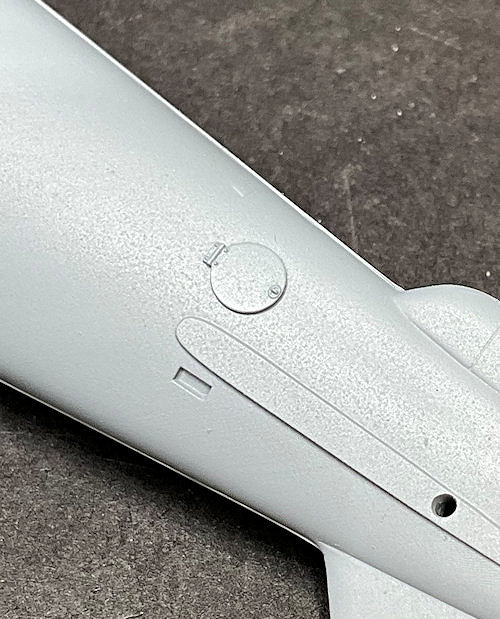

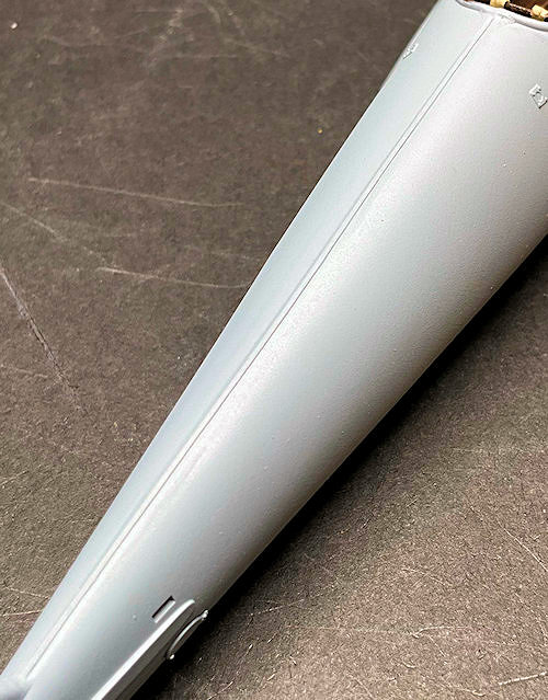

Hi all,
The fuselage sealing strips were added using sanded down 'Plastruct' 0.5 mm strip.
I added 'Proper Plane Albatros hatches (RD-015) to cover the recessed panels on the model,

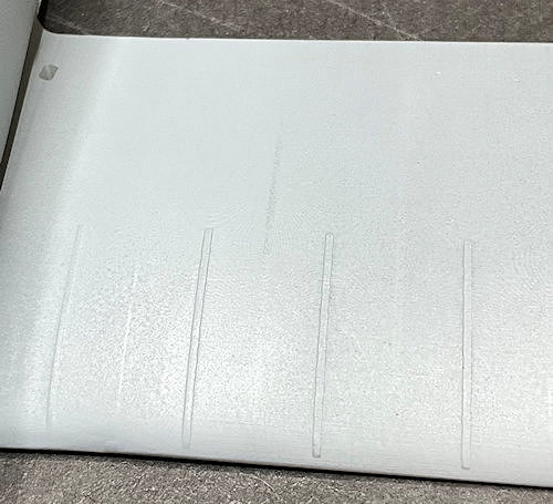

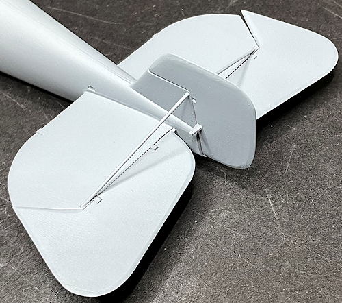

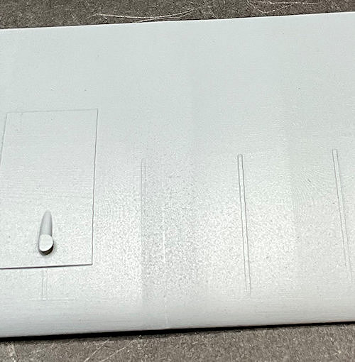

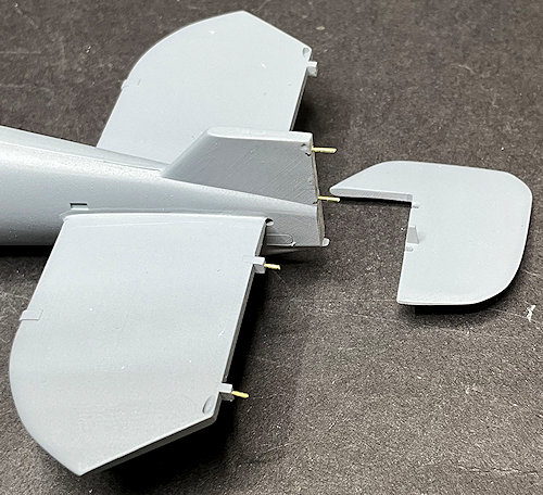

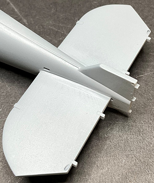

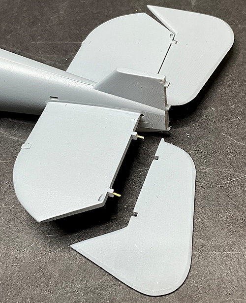

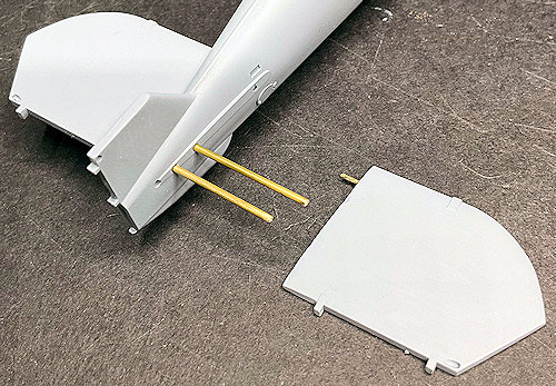

The underside of the upper wings and the top surface of the lower wings have raised rigging point stubs at the interplane strut locating holes.
I chose to remove these rigging points and replace them with photo-etch rigging anchors.
The two tailplanes are supported on the fuselage by two metal rods.
However, these rods are located at the rear of the tailplanes and allow movement of the tailplane leading edges.
This can cause the tailplanes to not align correctly with their fuselage mating surfaces.
To prevent this I added a 0.8 mm diameter locating rod between the front end of the tailplanes and fuselage.

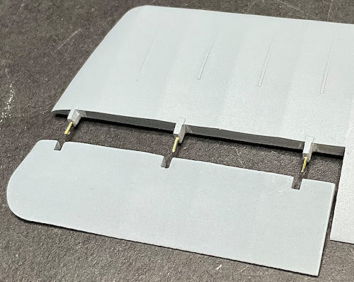

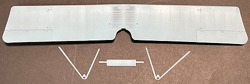

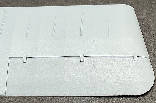

Hi all,
The upper and lower wings and tailplanes have been fitted.
Each was secured fully onto its support rods using thin CA adhesive.
'Mr. Surfacer' 500 was then brushed over the joints then sanded to blend the joints with the surrounding surfaces.
Finally, a grey primer was airbrushed over the joints to check they were blended.
I've also added 0.5 mm diameter support rods to the ailerons to give them extra support,
« Last Edit: April 24, 2026, 04:51:58 PM by Mike Norris (UK) »

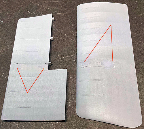

Hi all,
The elevators have had support rods added.
The top rudder hinge on the fin was damaged, so I removed both hinges and added rods instead,

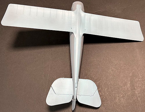

Hi all,
Tail flight surfaces fitted, including the tailplane/fin support tubes (replaced with formed Brass tubes).
Now it's onto preparing the rigging points prior to painting,

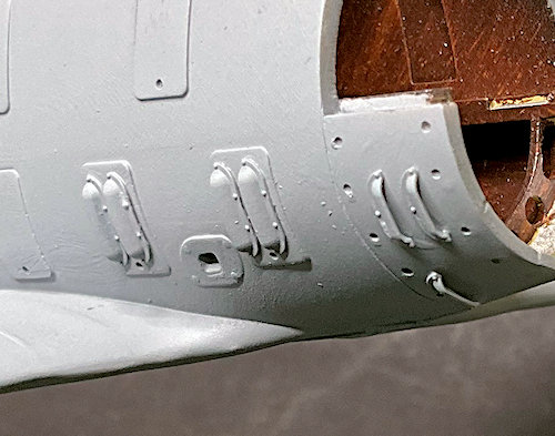

Hi all,
I've started fitting the replacement cooling louvres on the fuselage and engine cowl panels.
The louvres are the 3D printed ?Proper Plane? louvers (RD-011).
Although they are intended for the Albatros D.V/D.Va, they fit well to the Roland.
Secured onto the model using 'VMS Fleky? CA adhesive (Slow), which allows time to position each one correctly.
However, it does require seven sets of the louvres to cover the Roland,

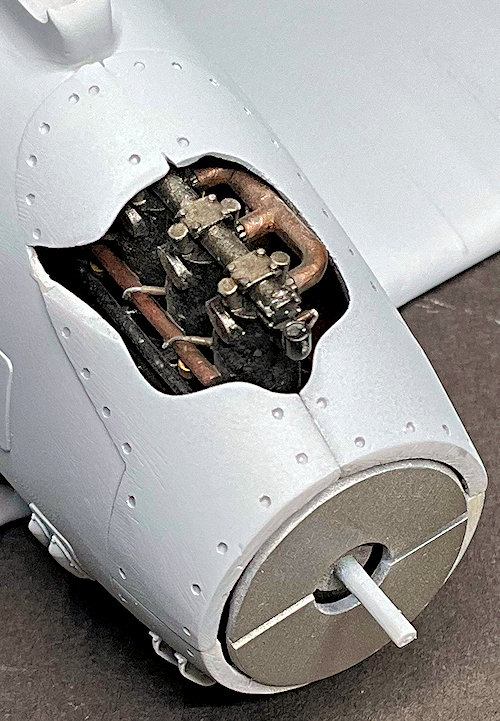

Hi all,
The engine and cowl panels have been fitted.
There was some slight misalignment between the panels themselves and the fuselage.
However, sanding the surfaces to blend them required some reinstating of removed surface detail.
As you can see, very little of the engine itself can be seen if the cowl panels are fitted,
