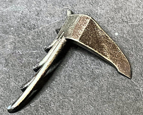

Regards the fuselage louvred panels, it seems I fell foul of research fog.
I've now been in contact with the author of the Aeronaut Book' - The Bulgarian Hunters: Roland D.II & D.III in WWI (by Mitko Mitkov).
Mitko is somewhat of an authority on Bulgarian Roland D.II and D.III aircraft, so I bow to his knowledge.
It seems only six Roland D.II aircraft, all built by Pfalz with Mercedes D.III engines, were supplied to Bulgaria.
Photographs of the Roland aircraft being destroyed in accordance with the peace treaty clearly show five louvered panels on the left side of the D.II fuselages.
Also, the aircraft I'm modelling shows the same panels on the fuselage right side.
Therefore, I'll re-instate the panel I removed in error from the fuselage left side,

Interesting photo giving a vague idea of the fuselage underside between the wings, which is not convincing in this kit as in most others, including Pfalz types.
You do a really great job here but you cheat with the louvres as they are for Albatros!  ;D
Regards Joachim
Regards Joachim
Hi Joachim,
Yes the louvres are intended for the Albatros DV/DVa.
However, they are more or less the correct size as replacements for the kit printed louvres,

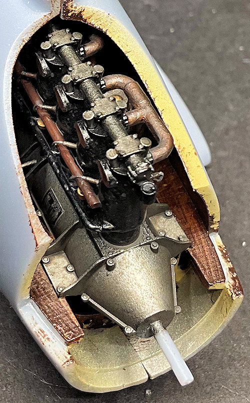

Hi all,

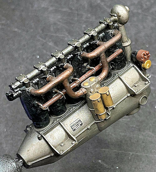

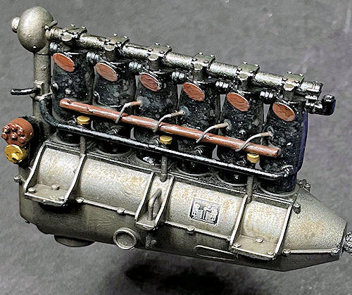

The basic engine is finished.
Normally I would add all spark plugs and ignition leads from the magnetos.
In addition, control cables/rods etc.
However, as can be seen, not much of the engine will be visible once it's fitted into the fuselage.
Therefore, I've only added spark plugs and leads to the first four engine cylinders, as they will be visible.

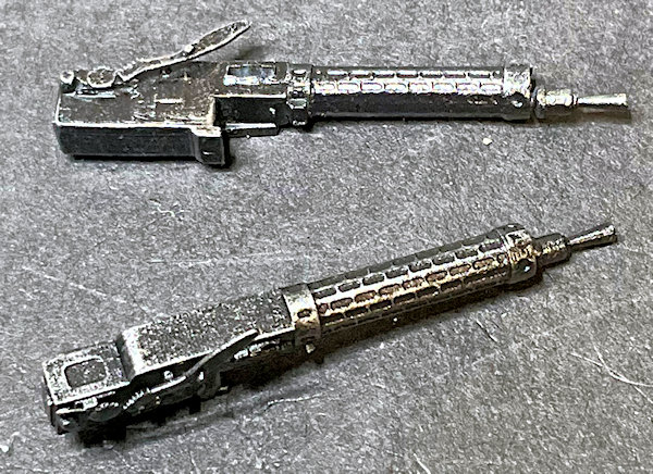

Also the engine exhaust pipe and both machine guns are finished,

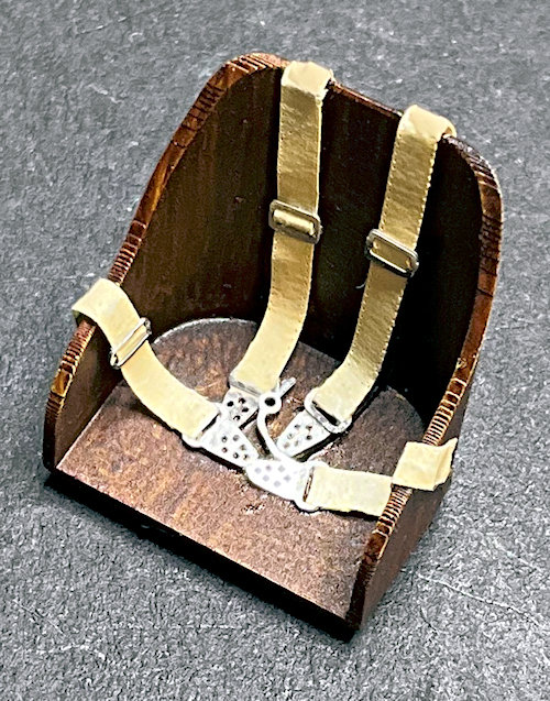

Hi all,

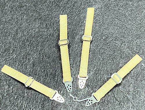

The pilot's seat is printed to include the four harness straps.
However, these appear to be too thin, so I chose to replace them.
I used a spare HGW Models harness set of the appropriate type.
These were secured over the printed straps using thin CA adhesive,

Very nice work so far Mike. That engine looks really good. I applaud your decision not to include unnecessary detail, it's an approach I too have adopted.

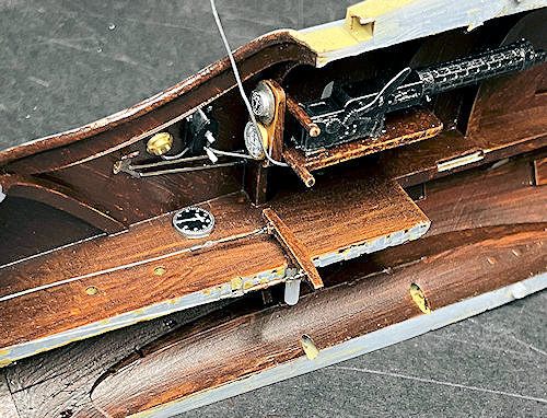

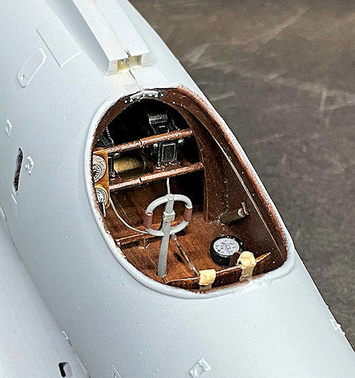

« Reply #27 on: April 21, 2026, 06:18:20 AM »

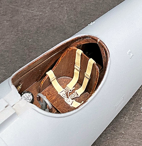

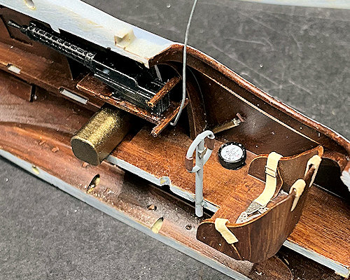

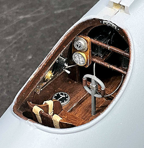

Hi all,

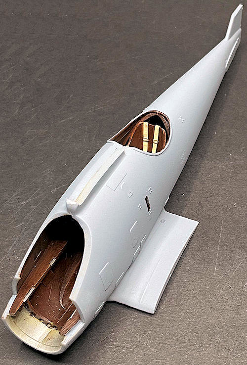

I could not find any information on the cockpit for the Roland D.II.
However, a report was written by Capt. F. Wells on a Roland D.III aircraft at Thessaloniki Aviation Park in 1919 and is contained in the book Bulgarian Hunters: Roland D.II & D.III in WWI?.
The report contains details of the cockpit of a Roland D.III.
Although this was from a D.III aircraft, its possible that some, if not all of this equipment was fitted in the D.II version.
Therefore, I chose to represent some of that equipment in the cockpit along with the kit supplied parts.
I've added:
Floor mounted compass.
Floor mounted fuel tank contents gauge.
Starter magneto and switch.
Throttle/spark advance levers and control rods.
Machine gun trigger cables.
Starter magneto and switch cables.
Rudder bar control wires and turnbuckles.
The gun trigger cables and rudder control wires will be final fitted after the fuselage halves have been joined,

Very nice work indeed Mike. I really like the added details, they bring the cockpit to life.

« Reply #29 on: April 22, 2026, 04:06:47 AM »
Hi all,

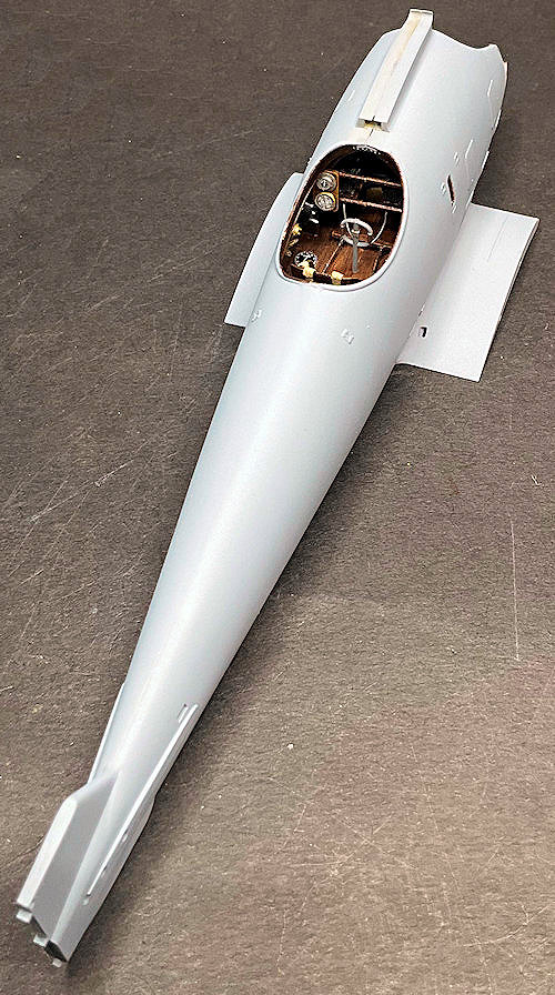

The fuselage is now closed up.
Fuselage joint has three locating pegs so the fit was aligned.
CA adhesive used as its resin and very slight Mr. Surfacer 500 used to fill some areas of the fuselage seam joint.
Sanded and primed ready for painting later.
