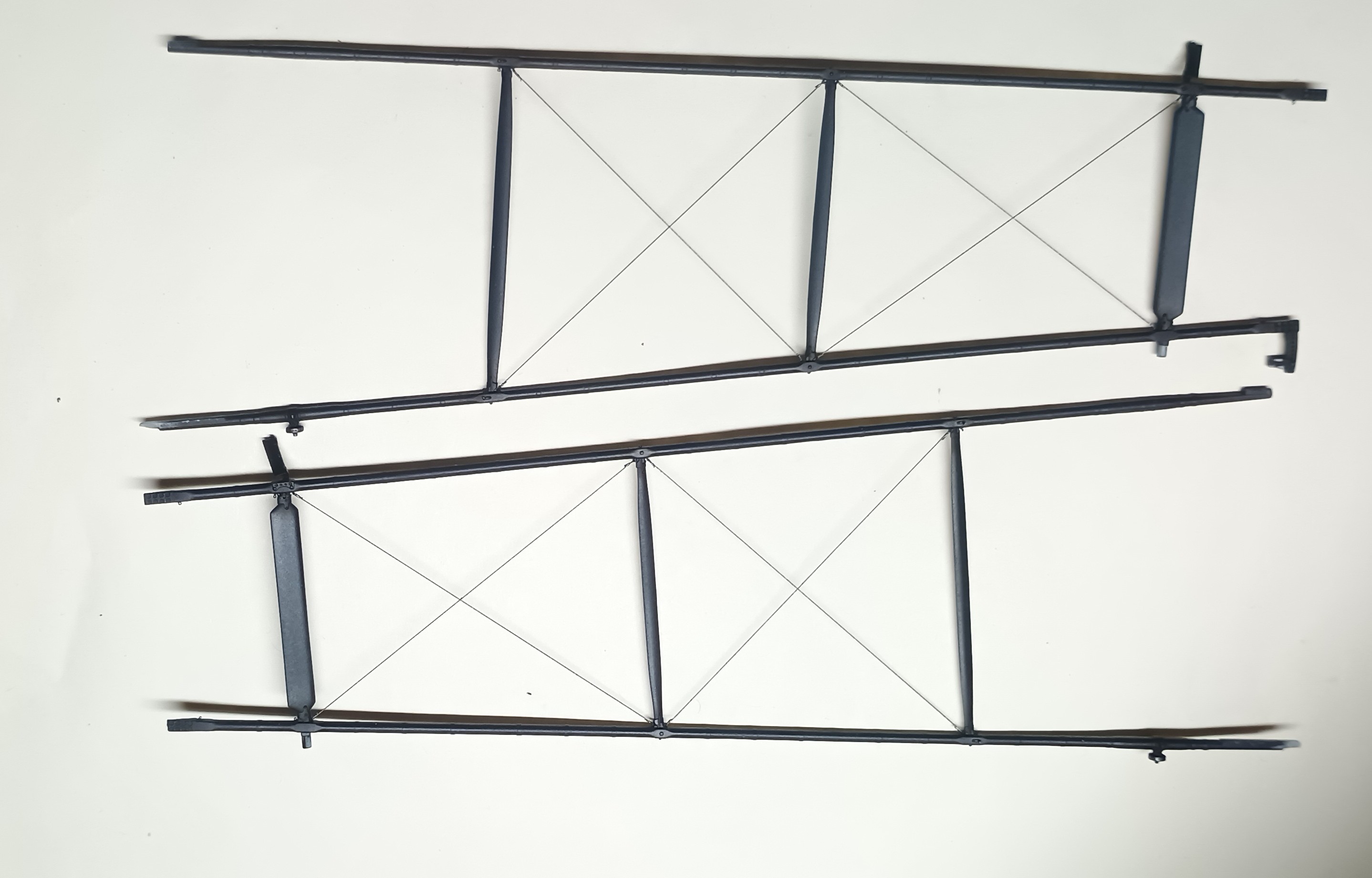

Today I attached the outer wing panels, second pairs of interplane struts and rigged 8 incidence lines.

Re: Multi-Seat 2026 GB - RAF FE.2b A852 Night Bomber WNW 1/32
« Reply #48 on: May 01, 2026, 03:05:47 AM »
Hi Przemo,
Excellent and clean work, as always.
I have a question. In the previous FE.2b (Jess) for the incidence lines i think you used combination of eyelets and tubes.
Now I see clear lines. What material is used and how did you attach it?
Spyros

Hi Spyros. Many thanks for your kind comment. My first Fee was built some 15 years ago, when I used brass tubes for rigging. They may give an impression of turnbuckles but it was not intended. Fee had the RAF streamlined wires, no turnbuckles on the majority of rigging. Now I am using the polyimide tubing for securing the lines. And I continue to use the 0.12mm monofilament fishing lines, only that now I paint it with steel colour. Also the preparation of eyelet rigging stations is shown in some photos earlier in this thread.

More weekend progress - started working on tailbooms, prepared the tail skid and made the replacement for kit flattish PE representation of turnbuckles for rudder/skid cables.

Can I ask about your rigging with turnbuckles? It looks like you are using Modelkasten which is threaded through the turnbuckle glued to itself and then neatly trimmed. Is this how you do it? I think it looks very realistic.
  • Posts: 5668
« Reply #57 on: May 04, 2026, 06:53:13 PM »
Wow, this is a stunner! Superb work.
Thanks, Nigel.
I am actually using a darkish monofilament fishing line of 0.12mm. I attach it to the eyelets or eyes in the turnbuckles using the tube method - more precisely I use a polyimide amber tubing with 0.279mm internal diameter cut to very short sections, about 0.5-1mm long. It is the method I described in the Rigging for Everyone presentation available in this forum section.
