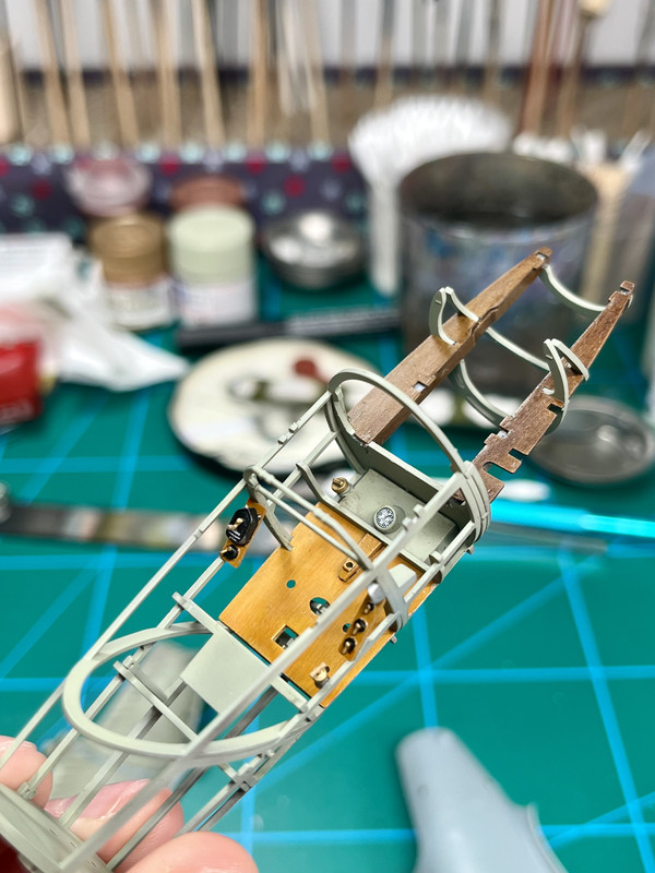

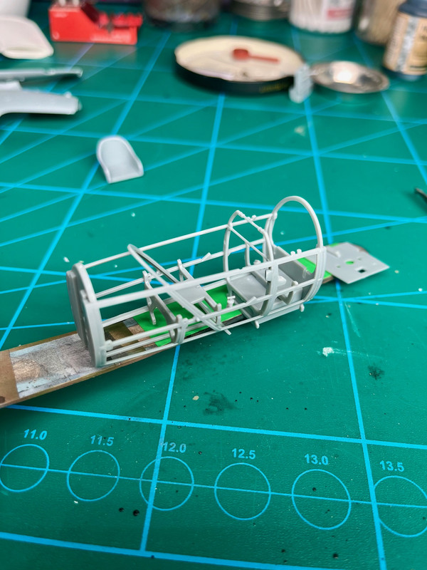

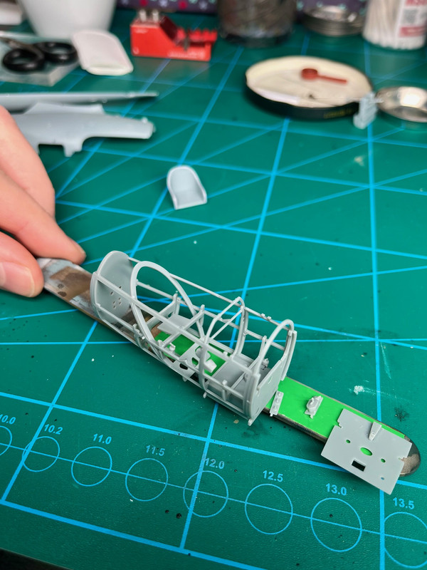

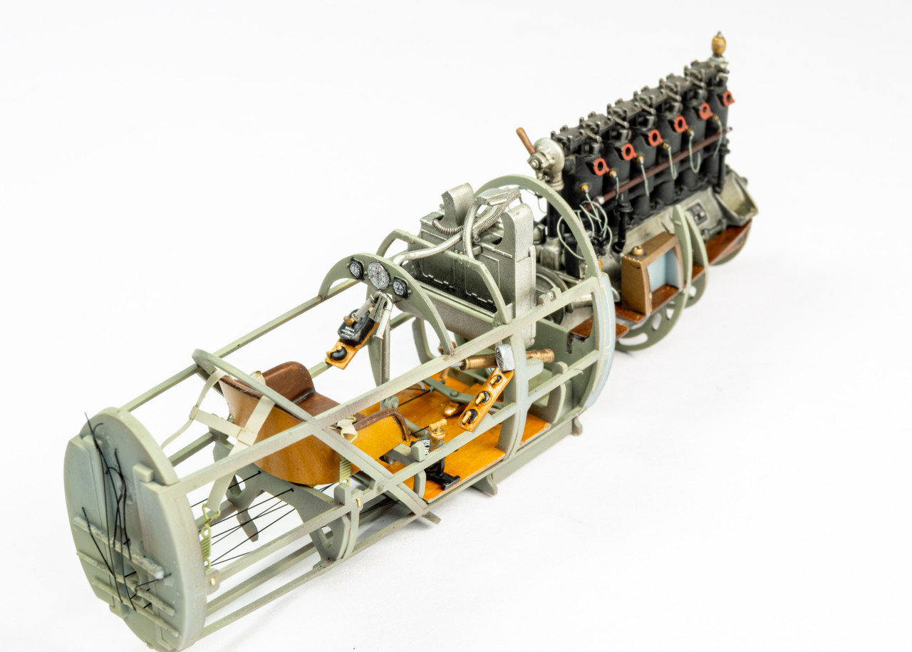

Working on the cockpit of the Pfalz it's very clear that the tolerances are very tight! Usually paint is enough to make the parts not join up... In this case even without paint some parts don't fit without a little trimming and adjustments.
The fit is something I had issues with in the past working on Wingnut kits. Just have to be so precise, so i'm doing a lot of dry fitting.
The Pfalz does not have a lot of internal rigging, so the frame can be built and painted as one piece.
I modified the floorboard so I can paint it separately and install later - should make it easier!

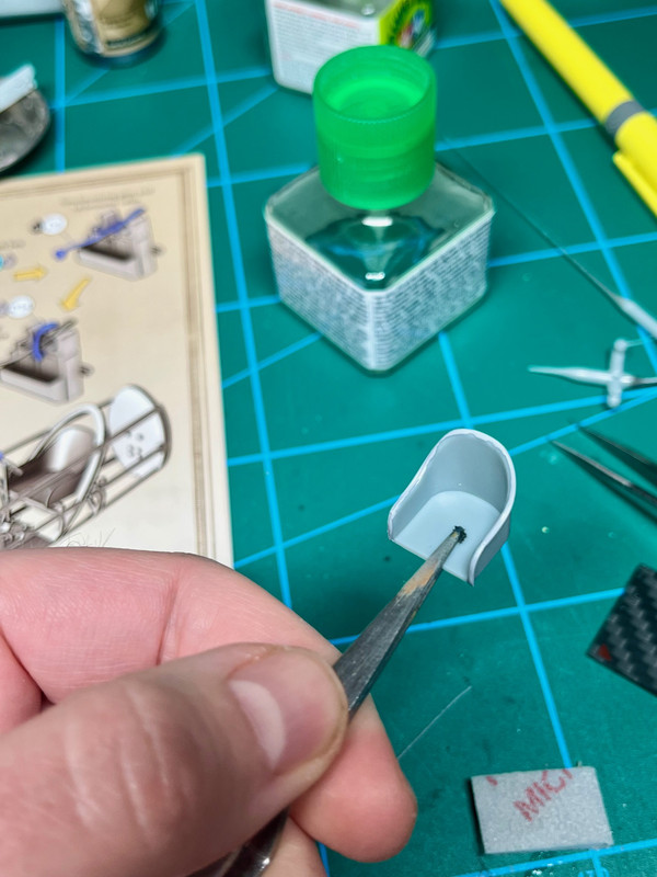

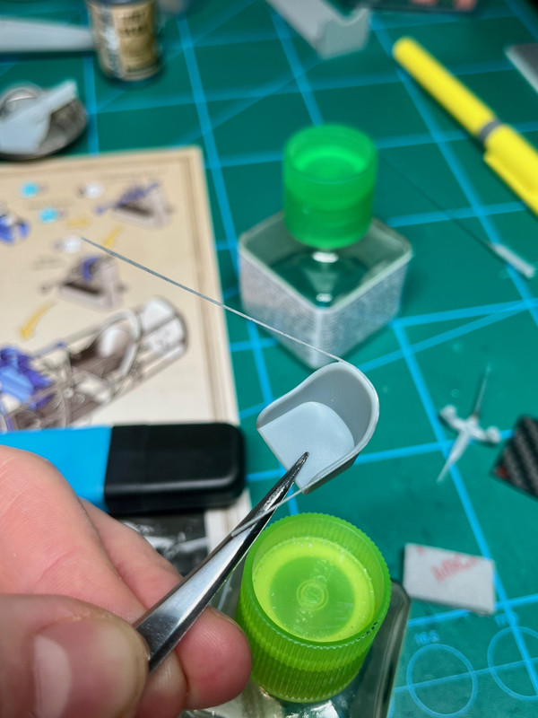

In the Pfalz book - Gary mentions the coaming is missing on the seat. He uses solder wire and CA glue, but I thought it was easier with stretched sprue and Mr Surfacer.
Should be getting closer to the first paint stage.

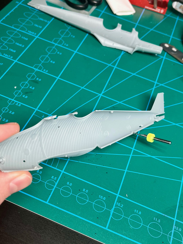

A quick note about the fuselage. The locating pins are such a tight fit that you can barely get the fuselage together. Think I'll remove all the pins.

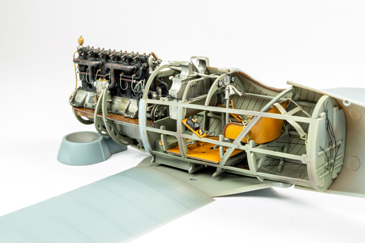

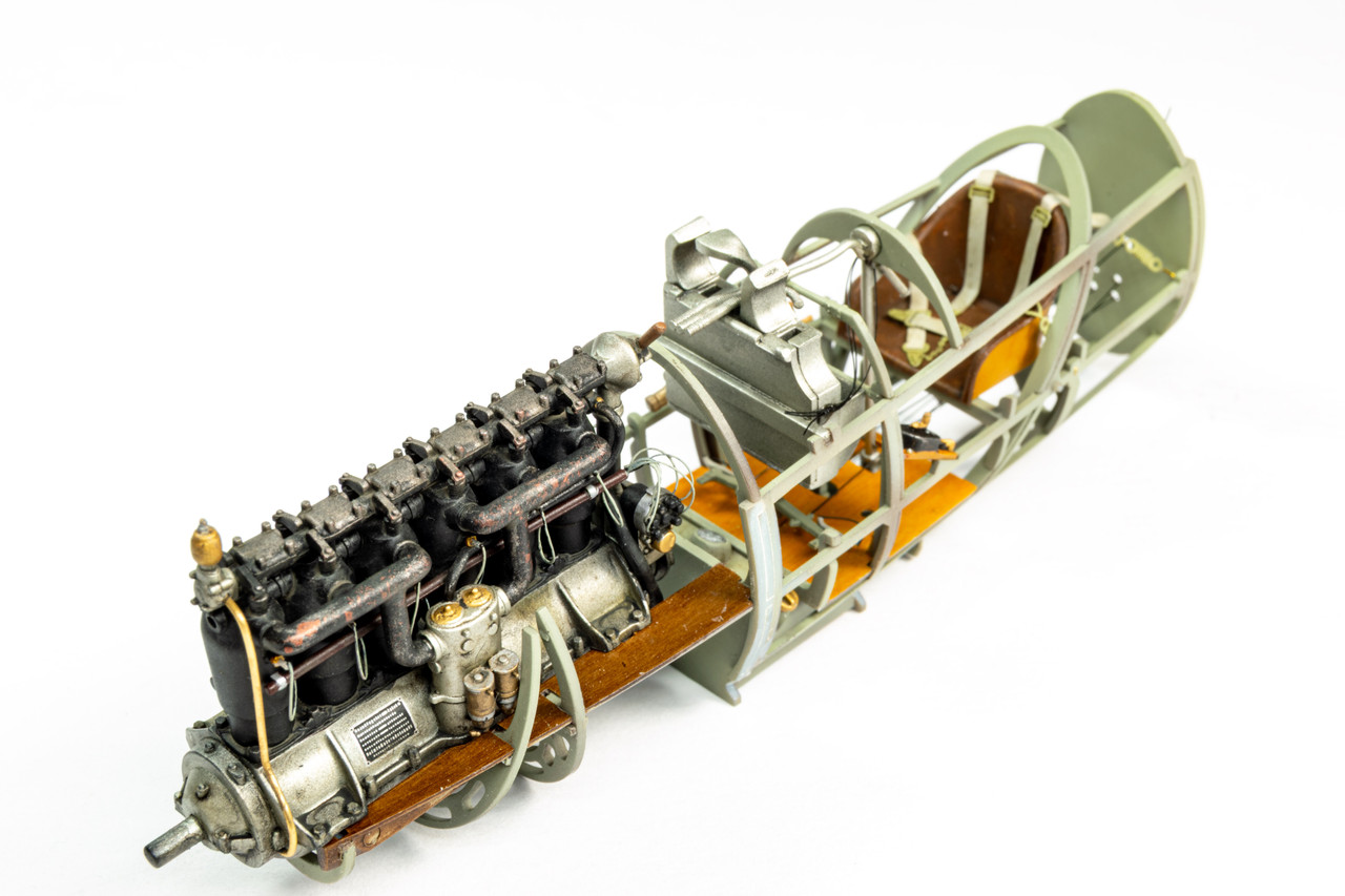

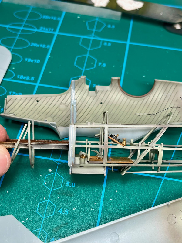

​I got some paint on the cockpit! The Pfalz was almost 1 color inside, but I opted to paint a bit of wood for some interest.
The fuselage cannot fully close, it seems like the part between the engine and main cockpit part is causing a bit of trouble. Think ill have to sand it down a bit.
For some more visual interest I painted the wood in the engine area a different color.
I am slowly added a bit of weathering. Just letting it dry in between sessions.
Funnily enough most of this will be invisible after closing the fuselage 😅 That's also why im not perfect with the parts facing away from the cockpit opening.
From my last 3 Wingnut build I've learned - to much paint and messing around only causes fit issues 😬

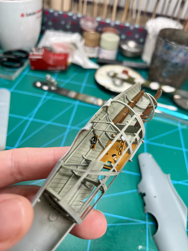

Dryfitting the fuselage
A gap that can be squeezed a bit, but need to be improved. Also not how little can be seen.
Current interior.
Seat etc still need to be added.
//Ben - @AngryJazz_Models

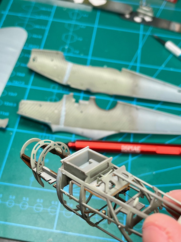

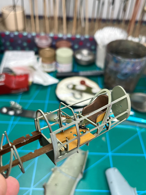

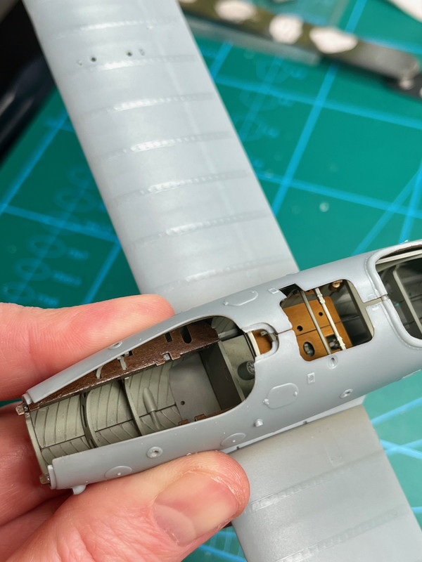

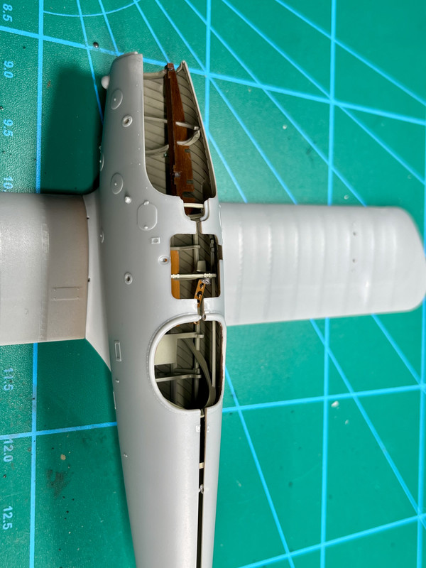

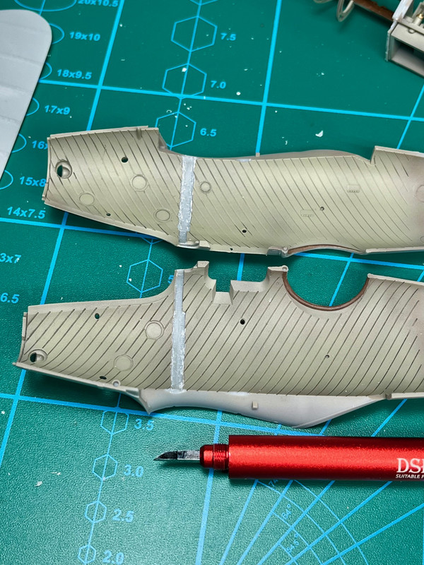

A quick build update for anyone else who may have a little fit issue. Did a few adjustments - not all may be needed, but it seems to work for me.
Main issue was the front section between the engine and cockpit could not close up well. I had a long session with a lot of dry fitting.
Drilling out the locating holes a little solved the fuselage not going together easily.
One section of the forward bulkhead(?) sorry don't know the right term for it..
But anyways its almost 1mm wider than the pre made fuselage cut out.
I took a chisel and made more room. Make sure also to deepen the original cutout at the top - it needs that extra room.
Bottom of the cockpit gets pushed up a bit by the fuselage bottom piece(the one with the bottom wings).
I cut 1mm of the from bulkhead(?) at the bottom.
The fit is much better now and clicks together well.
Only when the bottom piece gets added the fit moves a little again. I have not found this last "sticking" point yet and om not willing to thin the fuselage any more at this point.
I will add a small 0,5mm piece of plastic card and call it good.
Note the adjustments may look a bit rough here, but i'll clean them up a bit and honestly it's in places you won't see after you close the cockpit.

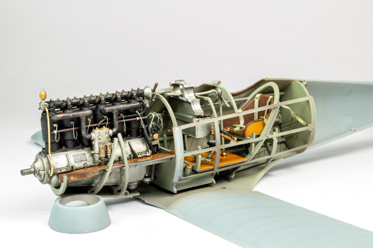

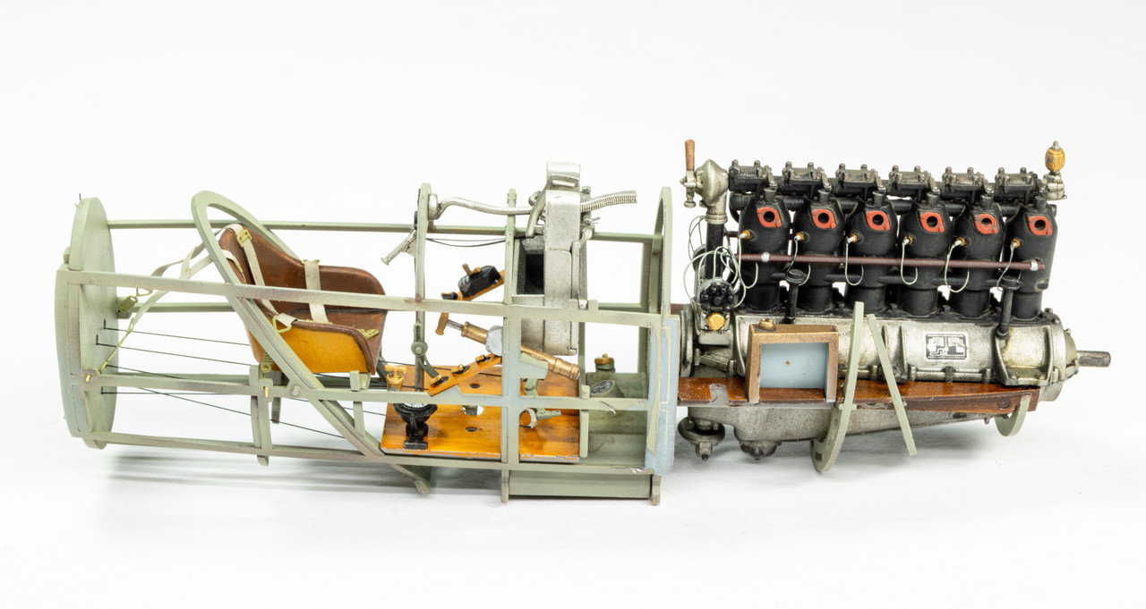

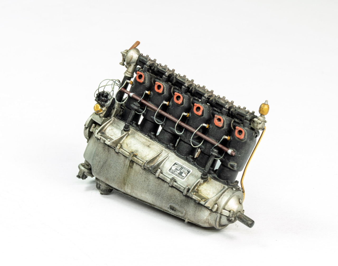

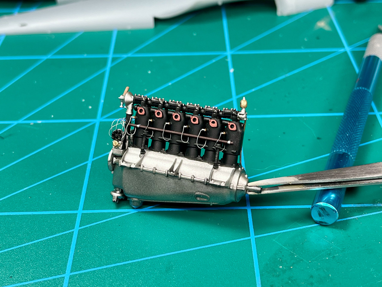

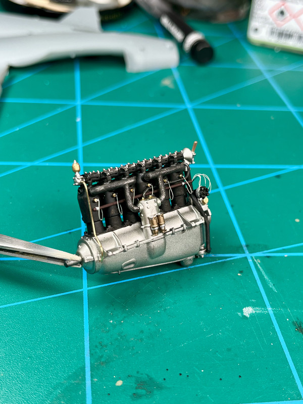

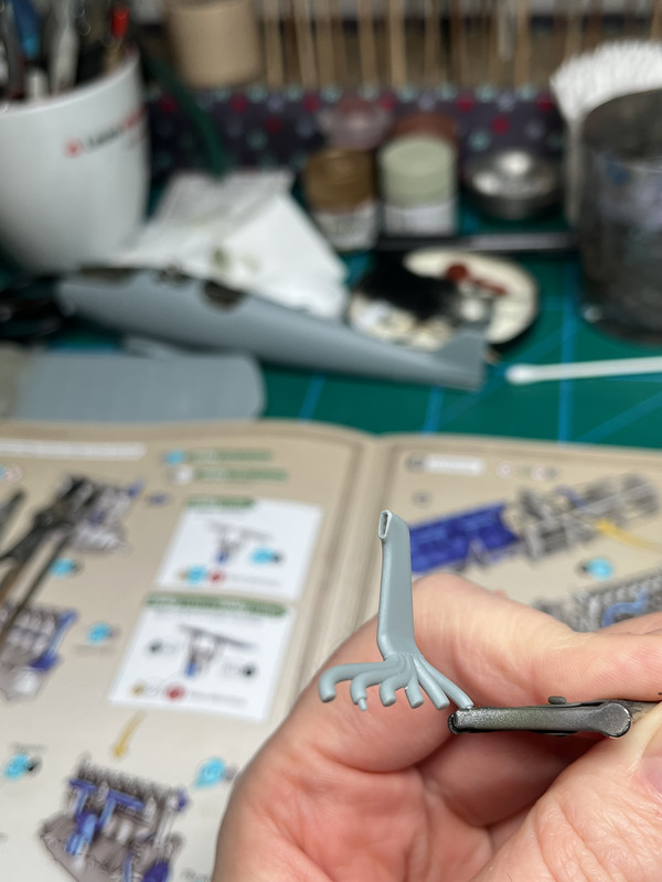

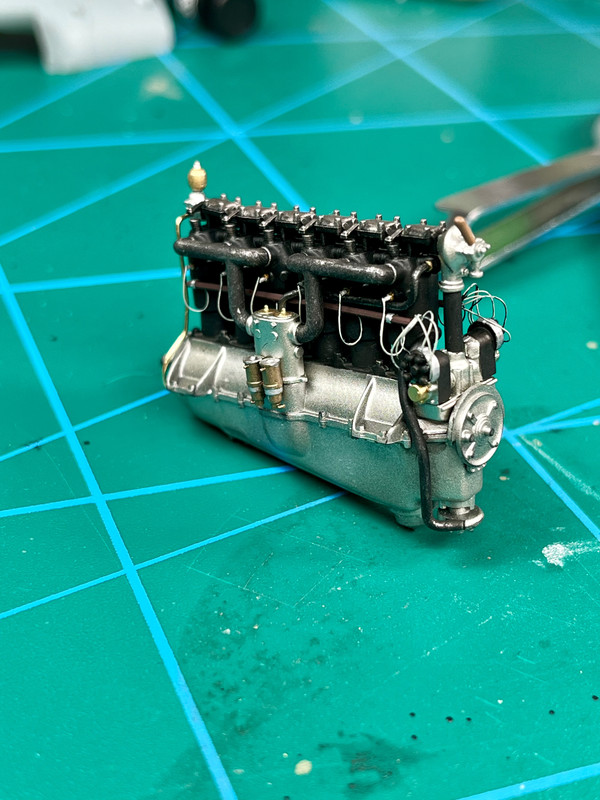

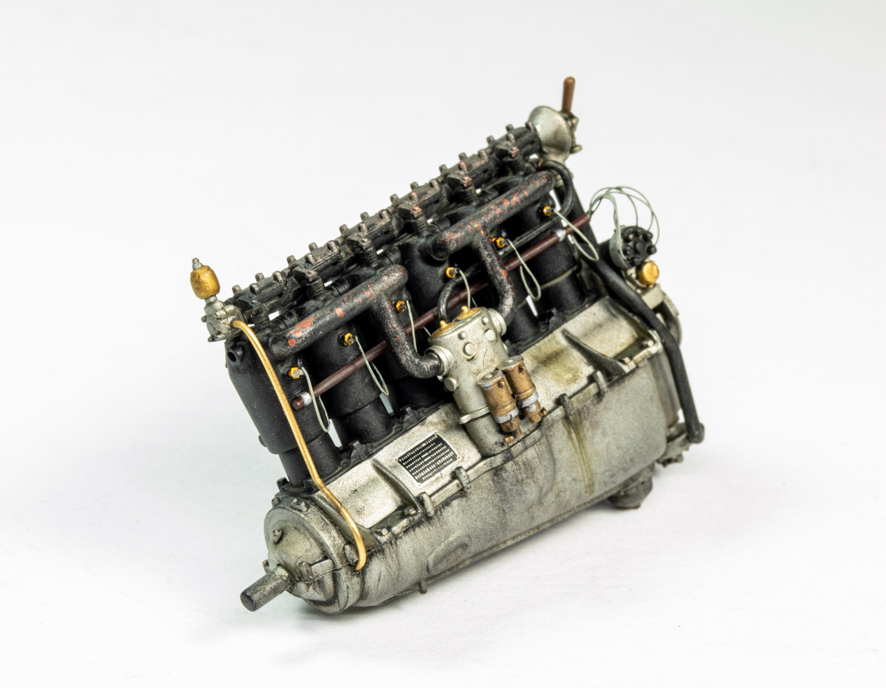

Working on the engine.
Just a lot of small stuff that all adds up... Hopefully...

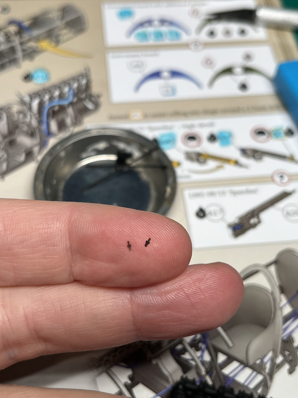

Added some 3D printed spark plugs. Just some random ones from way back when I used to own a printer.
Drilling out the exhaust
Engine done - now time for semi gloss varnish and start to really weather and grime it up 😄
Added the spark plugs, wires for the plugs and magnetos + pipe from the air pump to the front of the crankcase(?).
Sure looks busy for such a small part of the model!

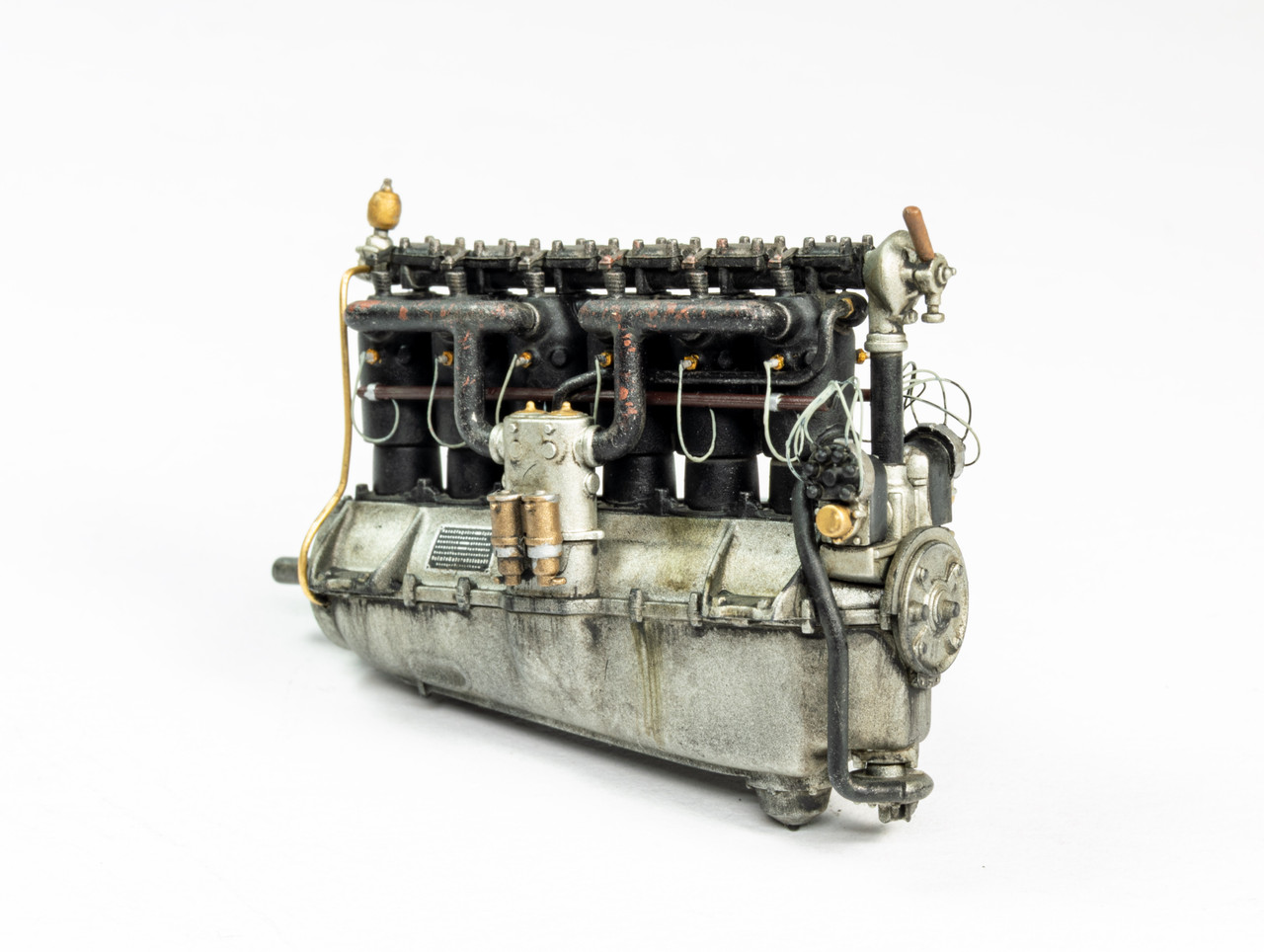

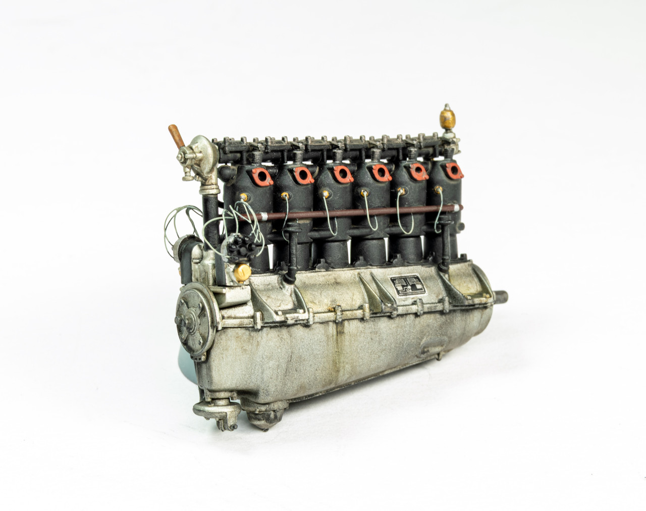

The weathered up engine - looks much more interesting now 😄

The engine looks gorgeous!

I also drill out the locating holes on the fuselage, I have found that makes a big difference to the quality of fit. I tend to build the entire fuselage tub and then sand down the outside of the tub in any areas where it is fouling the fuselage, that way you don't damage the fuselage finish. All kits suffer from this to some degree.

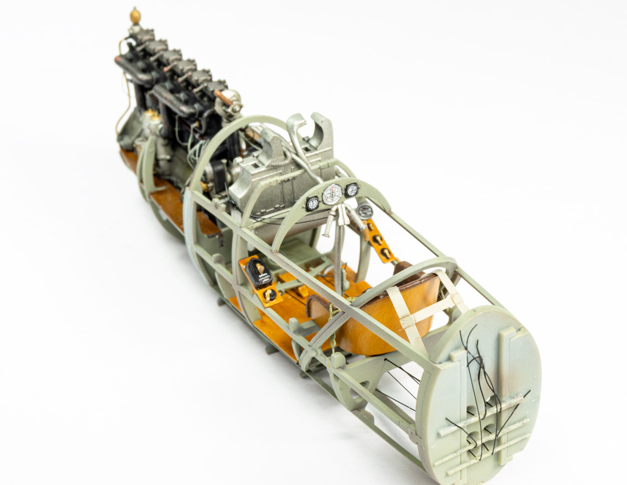

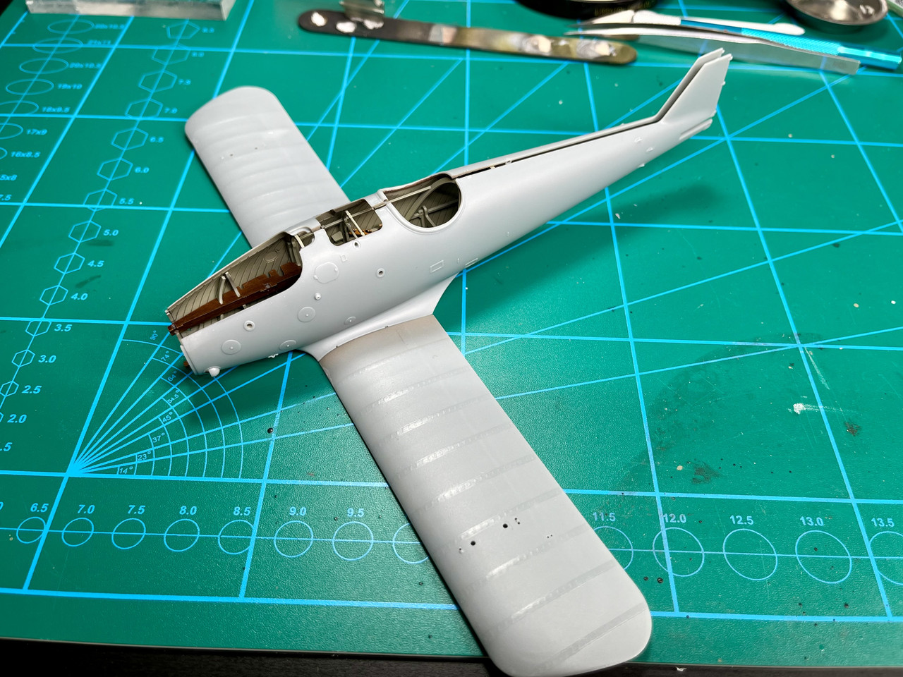

And thanks for the tips both of you. If all goes well i will be mounting the lower wings tonight so it can get time to dry.

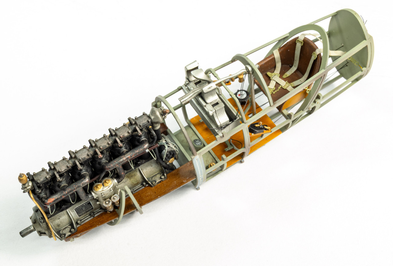

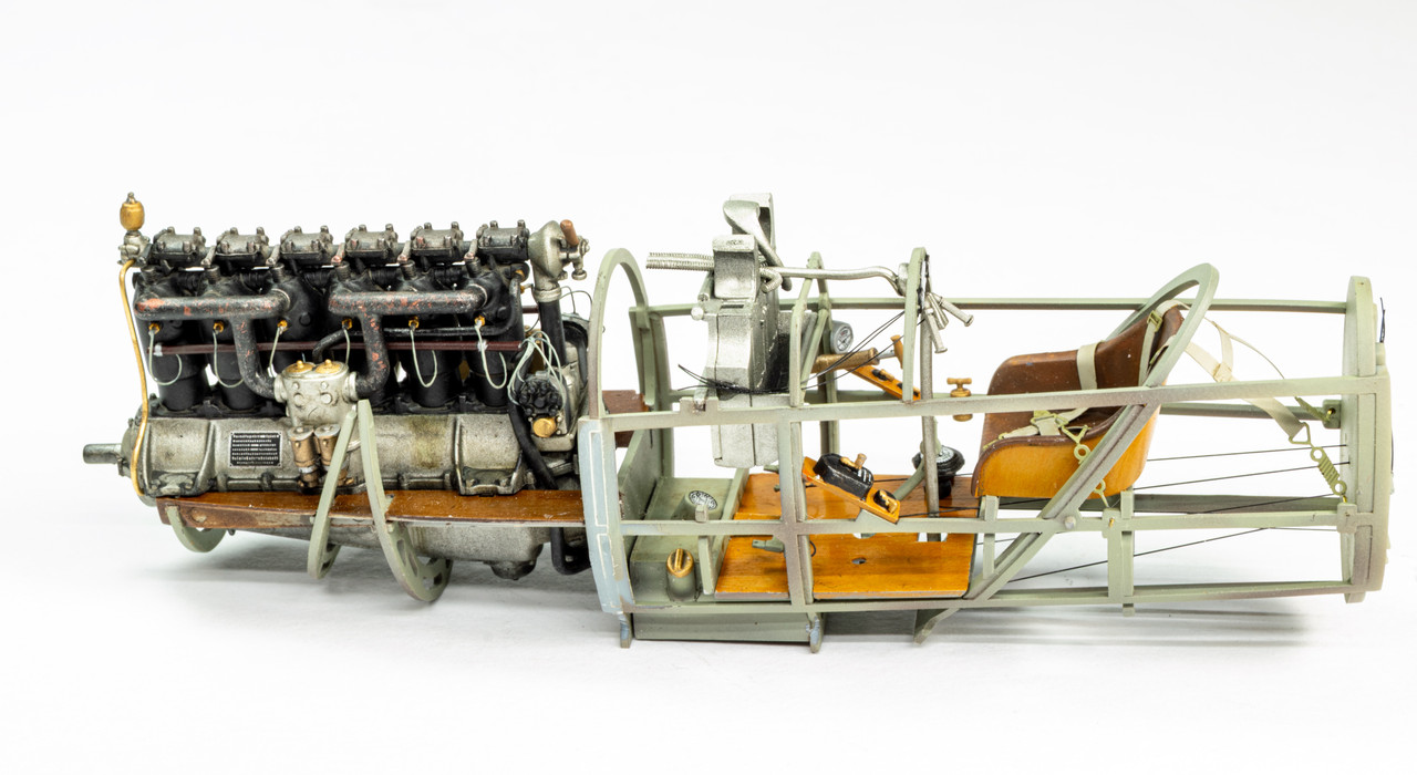

In the meantime pictures of the finished cockpit.
