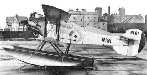

The subject of my next project is the Parnall Peto floatplane. What I hear you ask? I too was a little baffled when a fellow modeller asked if I would build one for him in 1/32 scale. He had seen my Short S 38/HMS Africa model and it reminded him of an experiment carried out by the Royal Navy in the mid-1920's with aircraft carried by submarines. Briefly the Royal Navy had 18 very large (K class), submarines built during WW1; three others were completed as M class vessels. The original M class had a 12 inch (305mm) cannon mounted on the fore deck but after M1 was lost in an accident in 1925 the other two were withdrawn from service, the cannons removed and replaced by a hangar. The Parnall Peto floatplane was designed to be put into the hangar and launched from a hydraulic catapault so that the submarine had an independent aerial observatory. Experiments were successfully carried out but sadly M2 sank with the loss of all hands in 1932 and the project was subsequently abandoned.

HM Submarine M2, launch of Parnall Peto (N255) in about 1930.
https://www.youtube.com/watch?v=-PGXyxZV62M
M2 was one of three M Class submarines.
In 1927 it was converted to carry a seaplane in a hangar and in 1928 a catapult was fitted to assist in launching the aircraft.
The aircraft carried was a Parnall Peto two-seat reconnaissance biplane.
Both the submarine and seaplane were lost on 26 January 1932 when the submarine sank in an accident.
