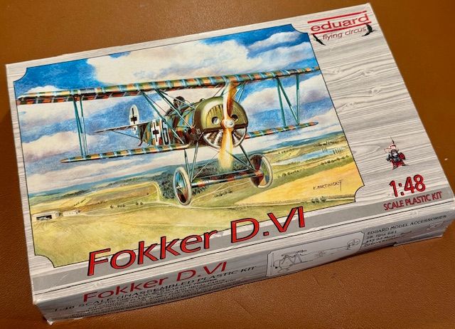

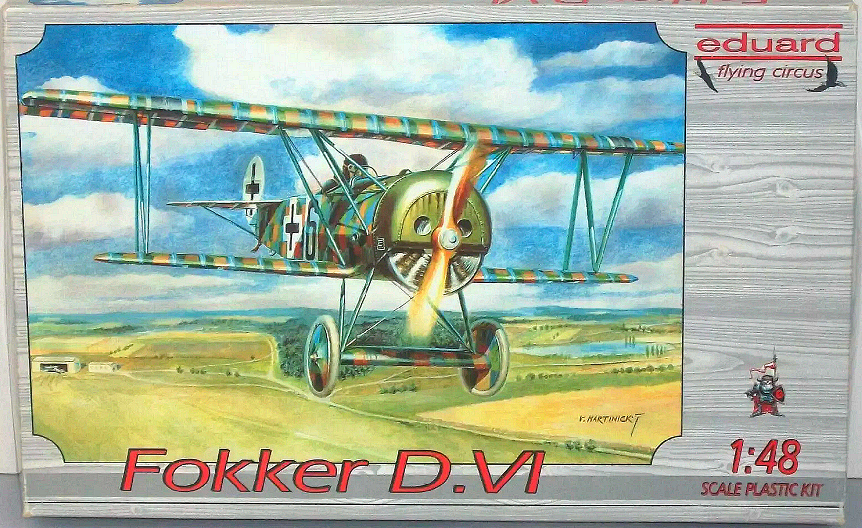

« Reply #12 on: May 31, 2025, 06:37:57 AM »
Beautiful job Dave.
Your build inspired me to hunt up my own in 1/48 scale.
This is entirely your fault.....
« Last Edit: June 04, 2025, 08:20:26 PM by Allan31 »

« Reply #13 on: June 01, 2025, 01:52:22 AM »
Beautiful job Dave.
Very kind of you to say, Allan -
I'm delighted my build has inspired you!   Will look forward to what you can do with this old Eduard kit.
