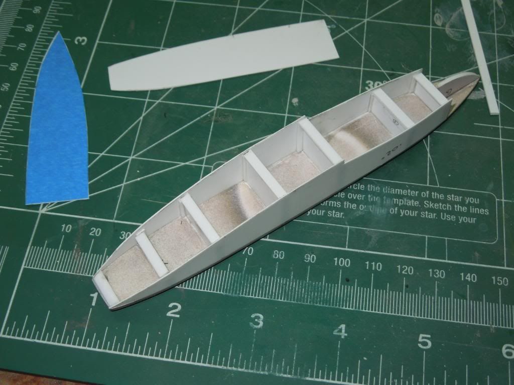

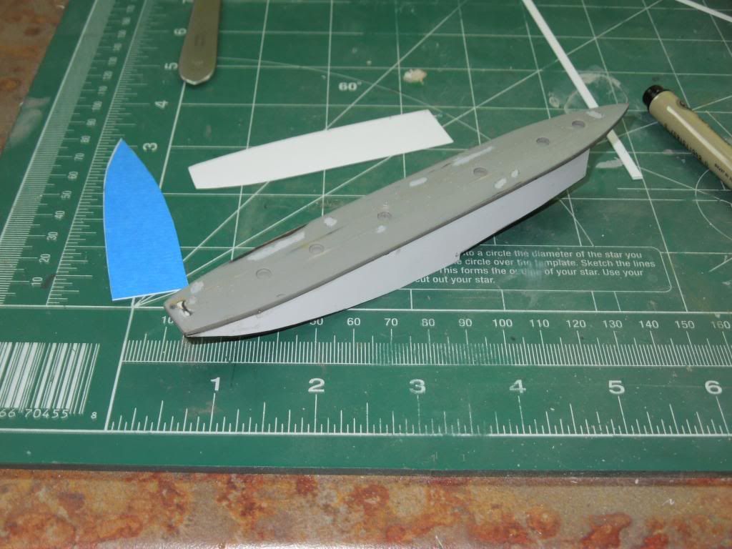

Thanks again everyone for the encouragement.
Someone asked how I made it. I used the data files plans (enlarged to 1/32) and cut out profiles from thicker card including bulheads. From there I applied a skin from .02" card. From there I did lots of sanding and used filler as needed. The most complexe shape to capture was at the rear (pointed end) of the float which was filled with balsa, then filled with bondo and filler. After much sanding, priming, sanding, priming... I ended up with the basic shape which I shared at the top of the thread. Just installing the strips along the bottom sides  and bottom right now. Then will come the drain port surrounds and walking strips on the top. Shes getting closer!
Here are a few earlier shots:

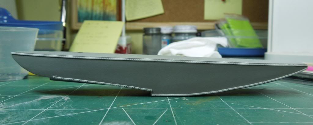

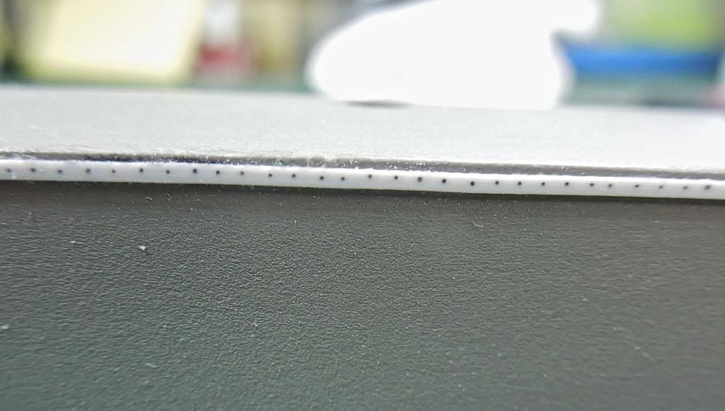

Man, I'm going bugg eyed with all this riveting!  :o
Ended up working on the trims that go on the exterior of the float both top and bottom. Boy that thin CA is tricky to work with!
Took a while to install and then rivet the strips with a pin. I would have used my BR production riveter but didn't think I was skilled enough to keep it running down the center of the strip which is only .02" wide. I put a little wash into the nail holes so they show up better in the pics.
I was also hoping to also install the wooden wear strips on the bottom and walkway strips on the top but I discovered too late that I didn't have the right size of strips in my stash. That coupled with the fact the hobby shop was closed means this is all I get done tonight.
Heres a couple of pics. It needs some cleaing up but I like how its coming.

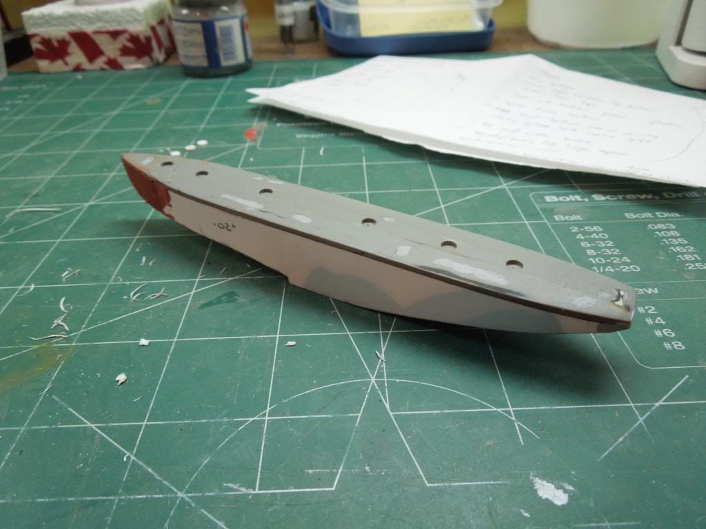

« Reply #23 on: March 06, 2013, 02:38:41 PM »
Sorry for taking so long to post any updates. Family, work, travel... it all seems to take up so much time and leave so little for the hobby bench, but I'm sure I'm not the only one who knows about all this!  ;)
I have been able to install the walkway strips on the top surface from .02" by .02" strip. Pretty finicky, but I think it turned out pretty good.
I then installed the remaining walkway strips and threw down a coat of primer. What do you guys think? It just needs the drain caps finished up and installed, then I can move onto the wings or maybe the engine.
Not sure what I'll do next, but I have a yearning to get to something that I can paint and finish.  :D
Feel free to post your comments.

Offline Chuckt5
  • Posts: 205
Re: Albatros W.4 float feedback
« Reply #27 on: March 07, 2013, 12:15:40 AM »
Thanks guys. This is my master that I'll copy in resin once done.
