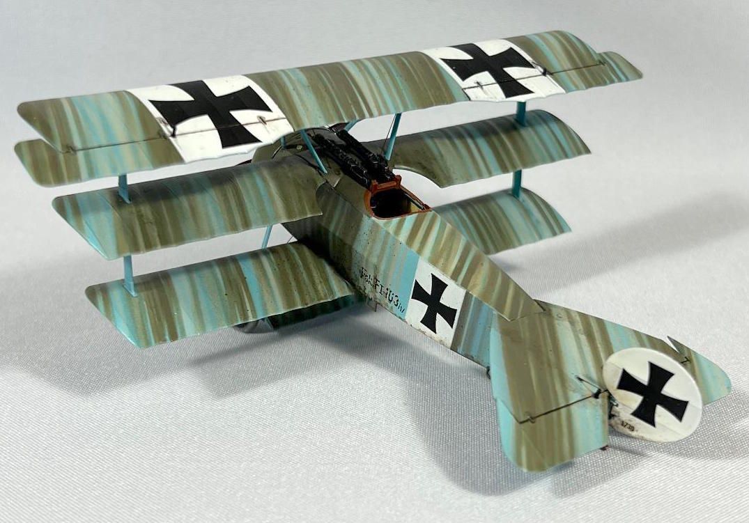

Indeed, F-101,102, and 103 were finished in the Silver/blue/green streak finish. Production a/c were light blue below, beige and green/brown above.
I used these and other eye witness accounts for my Voss/F103 build.
I don't EXACTLY remember were/how I came up with these colors for the production a/c but I found them somewhere.
Hope this helps. Scroll through the "Specific Builds" section of the Dr1, great stuff there.
