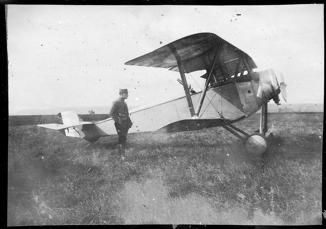

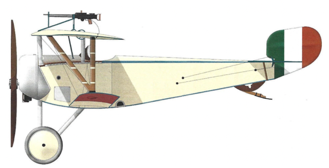

I know the Italian Nieuport 11 which, being initially supplied directly by the French company, have a very light straw yellow CDL which in period photos appears white. It does not appear shiny but opaque and in the wings in particular there does not seem to be transparency. This is clearly evident in the photos with a young lieutenant Francesco Baracca.
Photo with French nieuports:
CDL straw yellow

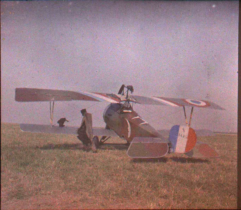

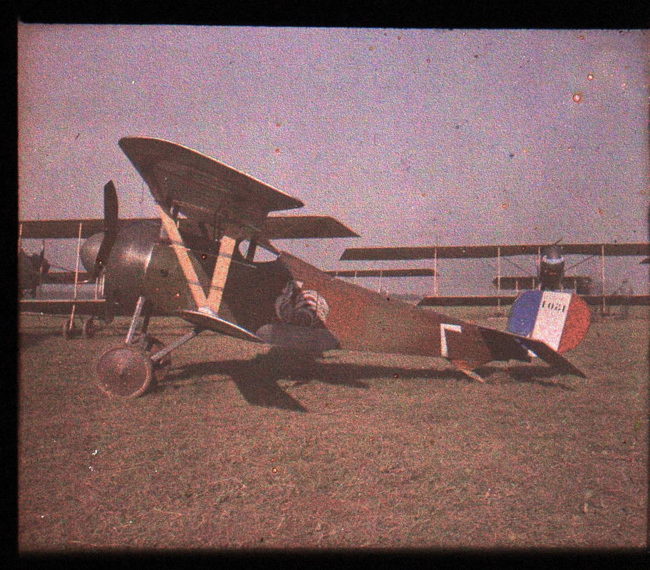

Now we know for sure, and Marc agrees that camo was 4 coloured one, not 2 like he thought before, so we did that with the latest Nie11, offering a 4 tone camo
Offline xan
  • Posts: 772
Re: Early Nieuport 11 - how transparent was the CDL?
« Reply #7 on: January 08, 2025, 07:07:52 PM »
Indeed , new autochrome appears and close the discussions
Marc wrote  a paper about this discover in Avions n?256:
But this is not te original subject.
About Nieuport CDL, it was not transparent indeed IMO...
« Last Edit: January 08, 2025, 07:13:10 PM by xan »
