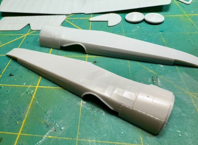

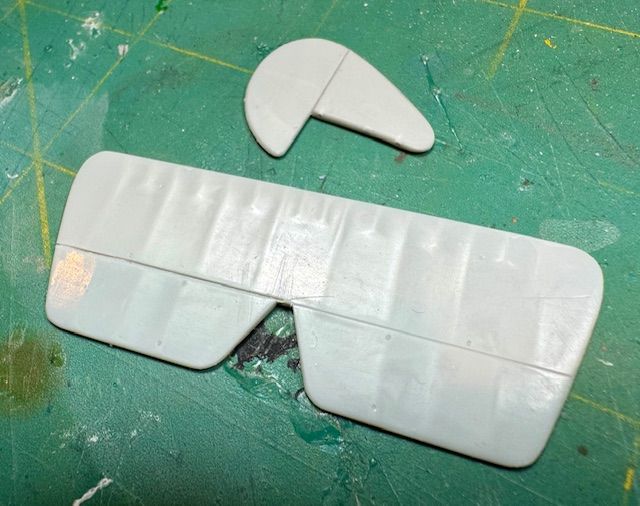

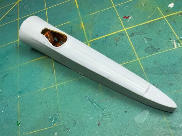

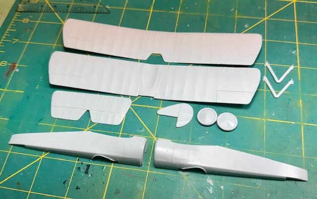

At first glance it seemed a bit flashy but nothing we haven't cleaned up before, the PE cockpit looks promising and the cast metal engine might come out nice.
Closer examination revealed almost no surface detail whatsoever. Most notably on the fuselage.
No panel lines. No rivets. No lacing. No filler caps. Seriously? And this is Eduards?....
So about a week of cleaning up, sanding, looking at reference pics has got me here.
I added missing panel lines and rivets. I added the wing joints in the upper and lower wings. Rescribed the movable control surfaces.
I have the missing 3D printed lacing. I have yet to add the little step from the turtle-back to the horizontal stabilizer, the triangle shaped exhaust behind the engine, the open space in the tail and the third cooling opening in the front of the cowling.
This is kit 8011. The very first ever Eduard WW1 in 1/48 by them is 8001, the SS D.III that I have and should be on the shelf if only because it was their first kit. I'm almost afraid to open THAT up. I will find out what kits 8002-8010 are so I don't buy them.

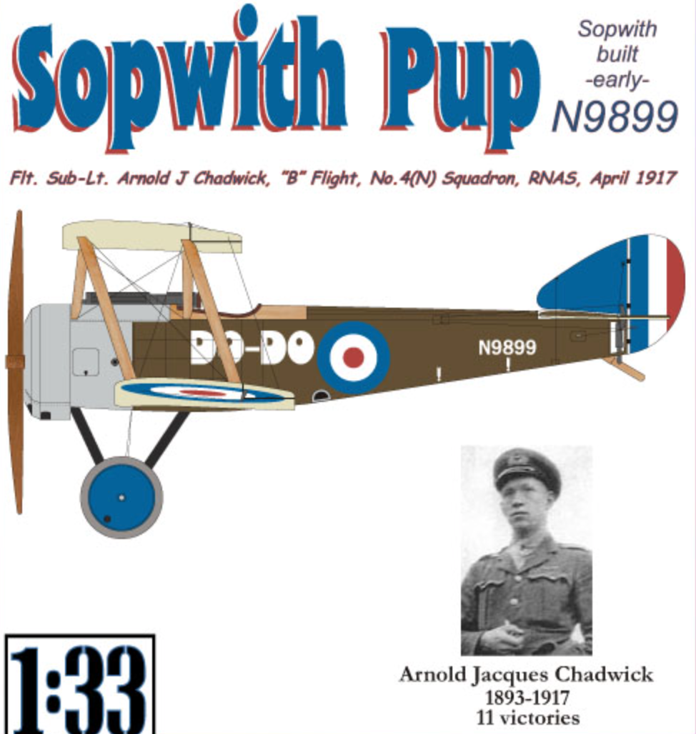

I will be using the kits decals with some added blue paint.
More soon....

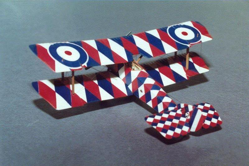

I built the Pup as soon as it came out and Blue Rider released a very cool decal sheet for a training aircraft, C242, which I just had to have. Quite thick decals and difficult to get them to lie down on complex curves, but I think the result was well worth the effort.
Unfortunately the model is long gone - but I still have a picture. (I wish someone would do this decal set for the Wingnuts Pup!)

So obviously you chose the best 1:48 pup!  :) The parts don?t look bad at all?

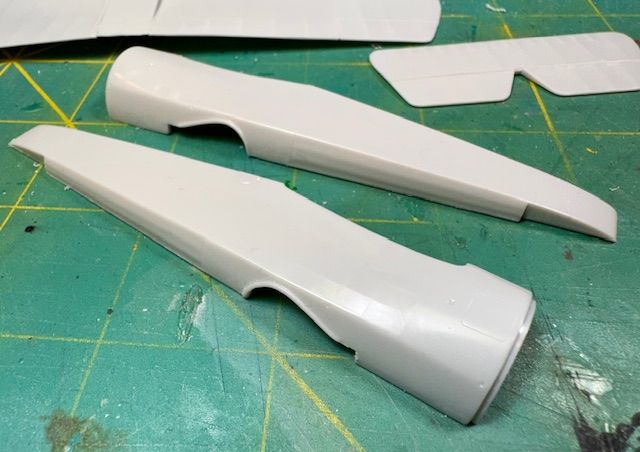

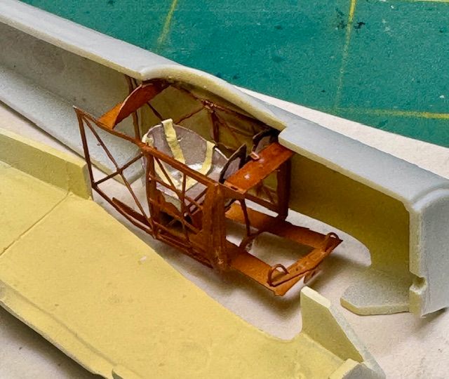

Thanks all,
Glacial progress on this with the holidays interrupting important build time.

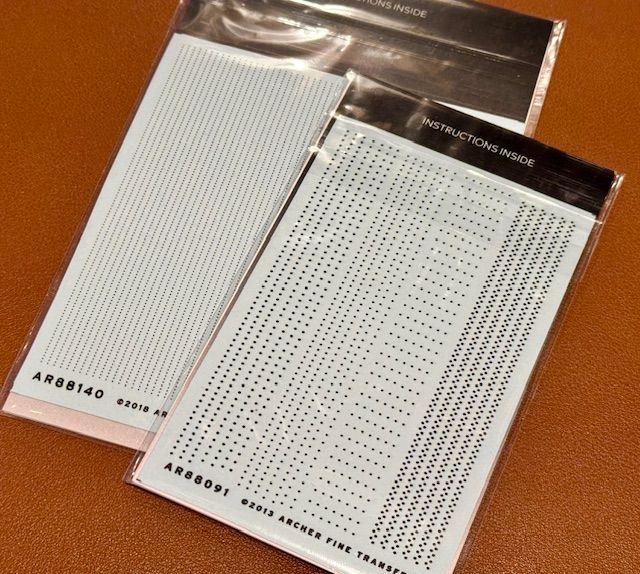

All the rigging holes are drilled, all the control line holes drilled, everything re-scored and awaiting primer.

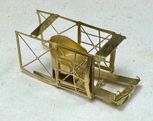

The cockpit is assembled and awaiting primer and wood effects. When that is done, I can finish the missing exhaust panel and create the missing step for the horizontal stabilizer.
Once the fuselage is closed up, I can apply these nifty 3D printed rivets and lacing.
I need to get some quality time in at the desk, more soon.

I'd completely forgotten that the cockpit internals of these early Eduards were folded brass. I now remember struggling with this on the Pup, the SS D.III etc.
Yours are folded beautifully - very straight and four-square.
And the rough-hewn parts - great to see real modelling again rather than shake-the-box click-snap kits
Great progress, Sir.

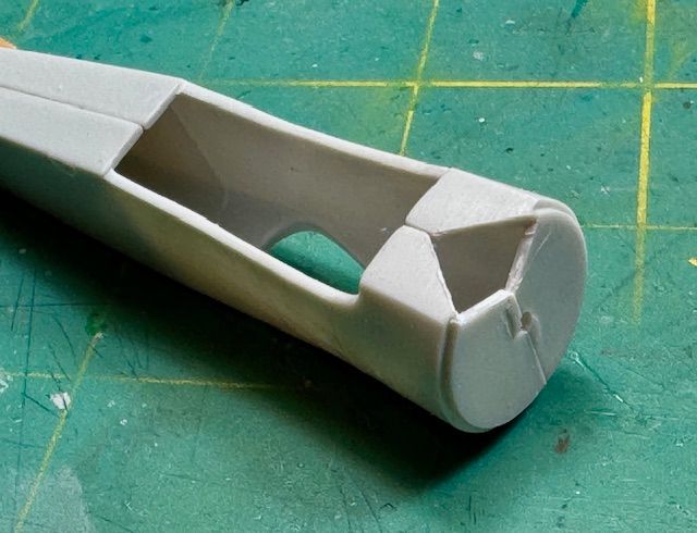

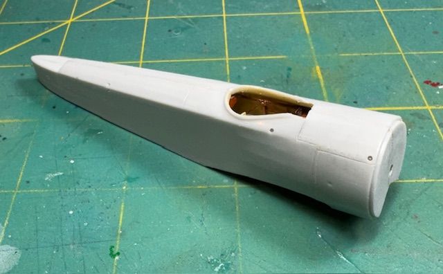

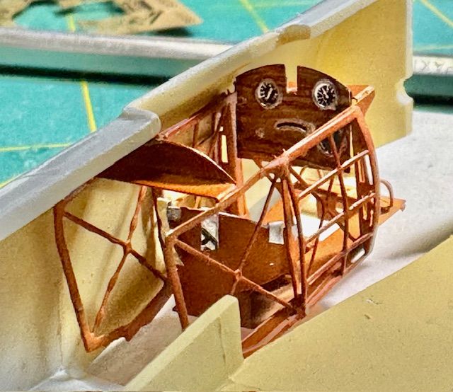

OMG......
I can't believe I have finally closed up the fuselage. More to do in there but at least we're closed up. Eduard supplied some very nice PE belts but since they are hardly seen I am saving those for a DH2 or something. These belts are just yogurt foil.

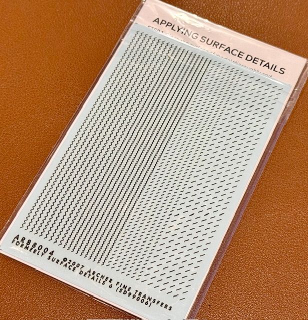

I can now start on the outside with missing rivets and stiching. I still have to add the V shaped thingy behind the engine and step in front of the horizontal stabilizer.
Jeezzz......
