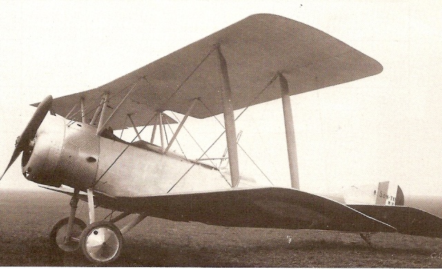

- The windshields varied. Some had none, some had a little square one in the W strut at the front. Here's a picture of a Hanriot machine and I cannot see a windshield on it: https://i21.servimg.com/u/f21/11/42/56/87/sopwit10.jpg

- Silver or CDL? Yes. Your choice. It's a subject of much discussion. Restorers at the Memorial Flight stated that the French Sopwith Strutter handbook specified aluminium dope, but many people feel CDL is likely based on photos. The photo I attached seems to have shiny (aluminium?) wheel covers but the fuselage looks a different colour.... Look at the restored example in Le Bourget: https://www.jetphotos.com/photo/5925644. You should base your model on your interpretation of your photo.....
- Tail markings - on the photo I attached of a Hanriot it says S OH-TYPE1 . Not sure what is under that.
