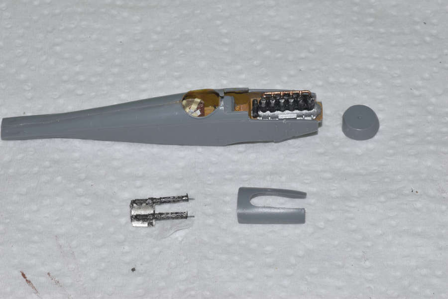

Many years ago two gentlemen formed a company call Veeday Models.  They had the audacity to produce WW1 models in a short run injection format.  What a crazy idea.  Veeday did not last long but a new company, Pegasus Models, was created.  Models that we never thought would be produced in any medium, except maybe vacuform.  Over the course of the next 20 years or so, Pegasus went on to produce 46 WW1 model in 1/72nd scale.  He ventured into 1/48th a little but his main thrust was 1/72.  He produced 1500 castings per mold.  I bought everything he produced and of the 46 kits, I built all but 8 of them.  Over the course of this year, I will attempt to build all of his kits.
This model is the Pegasus Albatros D.III and as is with all Pegasus kits, decals and metal parts were provided.  The box and parts are shown in the first photo.  By today's standards, the kits are crude, but there was nothing else on the market with the exception of Revell and Airfix.  Toko, Eduard and Roden were not even on the horizon.

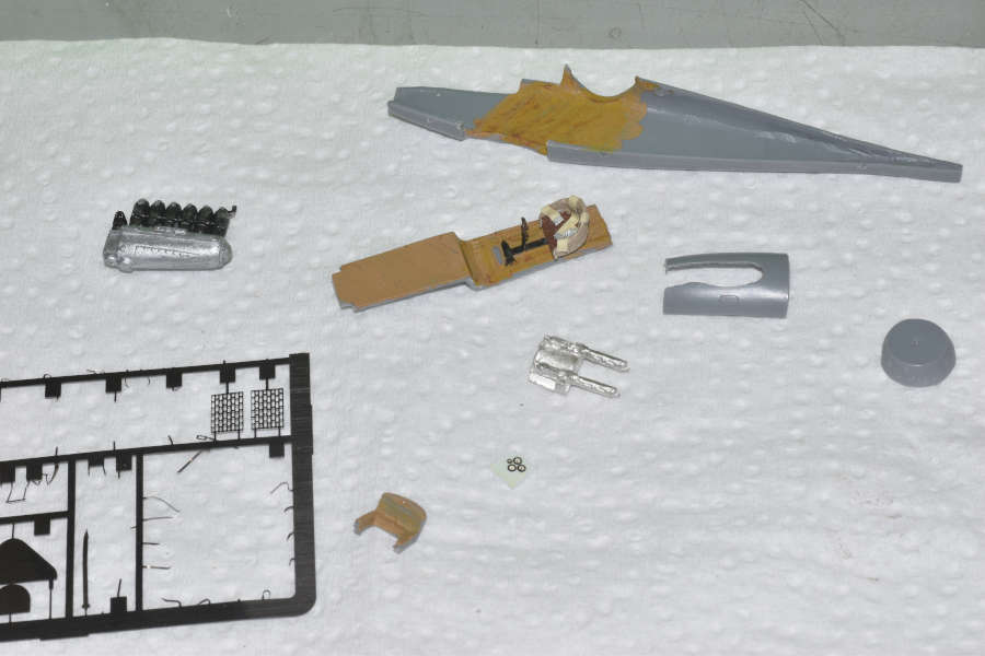

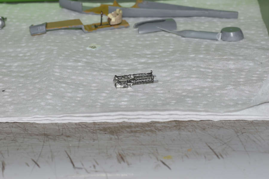

The interior was completed out of the box, adding only seat belts.  The engine came from the spare parts box for a little more detail.  The bottom of the engine was cut off so it would fit on the platform.   It was easier than cutting a hole in the platform.  The machine guns appeared to be a little stubby, so I used some Eduard barrels and lengthened them a little.  The color scheme is being researched and some of it will be revealed in the next post.  The fuselage is ready for putty work and all metal parts have been straightened and cleaned up
Dennis
