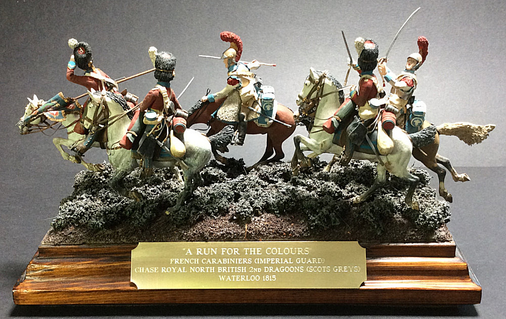

Hi David,
I'm not a great figure painter, but I like to add figures for scale effect.
I've painted 91 figures for the 51 WW1 aircraft models I've build so far.
Back in the eighties I used to make 54mm Napoleonic figures from 'Historex'.
Those were painted with enamels of course.
All of the straps, harnesses and belts etc were made from thin strips of toothpaste tubes, which then were basically lead!!
I just brush on the paints and wet blend them until I get the effect I like.
No skill involved, just time,

Just wonderful……..a labour of love!
