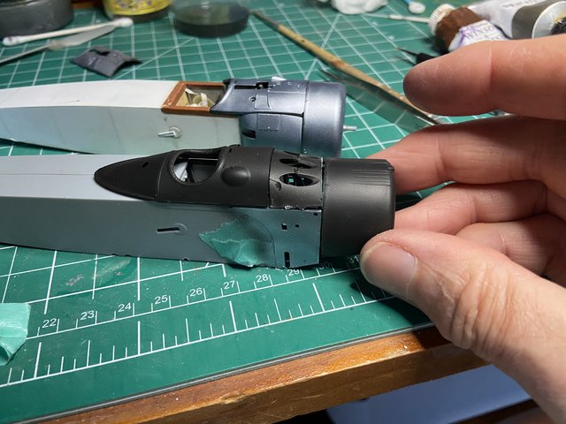

Thank you for the comments, Bertl, Rick, Nigel, and Ben. It's been almost six weeks since I posted an update; in the interim I completed the "generic" Eindecker sets and received the finished sheets from the UK:
In any graphics project there's always something of a sense of anticlimax when you see the finished product, since you've been looking at the art in minute detail for months. I've been doing graphics professionally for fifty years, but in all that time I never had to work at tolerances of 0.25mm—that's 1/128", if my math is correct?—which necessitated countless corrections and revisions. Some, but by no means all, of my proofs can be seen below (on regular printer paper, NOT decal material, I should add):

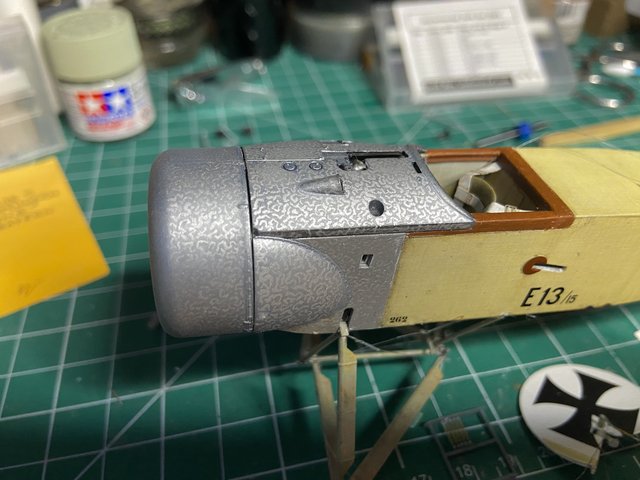

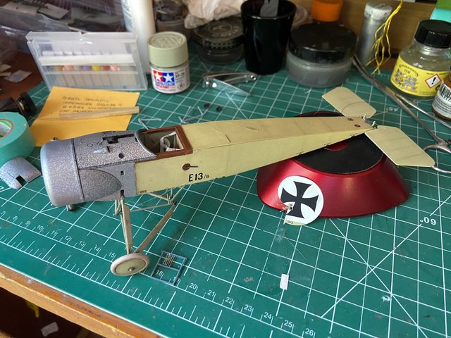

In any event, in between that and madly trying to prepare for a show of my landscape paintings—my "day job"—I've been able to get some work done on the E.I model, which is finally up on its (as yet unglued) undercarriage, loose rigging and all:
My attempts at reproducing the sworling on the metal panels are slowly getting better, although I'm still dialing the technique in:
But since I'll be building at least two more E-series kits this year (Projekt Eindecker "warehouse" below) I've decided it's good enough to go with for this initial build.

Your sworling looks great IMO, some of the best I have seen. I'll be starting my practice efforts soon......

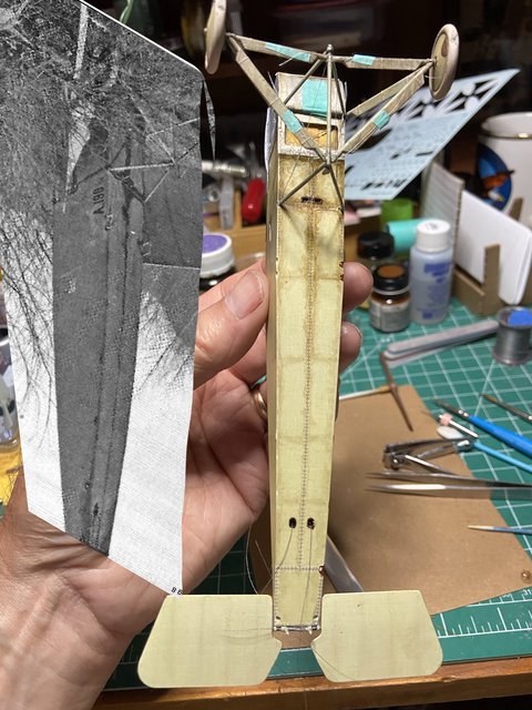

Thanks, Nigel, Edgar, and Bertl; Eindeckers have indeed taken over my life in the past nine months. I actually made some more progress tonight on the E.I, I've been trying to get the staining on the bottom of the cockpit area done so I can glue on the undercarriage and finish the rigging of the fuselage, and I feel I'm getting there (maybe one more pass with the Abteilung "Engine Grease" oil color, a gift from my son Curt):
One of my references is superimposed on the left.
Anyway, Edgar, I'm not sure if the demand for a new series of Eindecker kits is there at present, but it definitely will be eventually... and if you need decals for them you'll know where to come!

Be bold with that staining Dutch. You've got castor oil oozing from the inside of the fabric so it will be heavily stained like in the photo. I think the rear half of the fuselage looks good, but it needs to be much darker at the front part of the fuselage.
