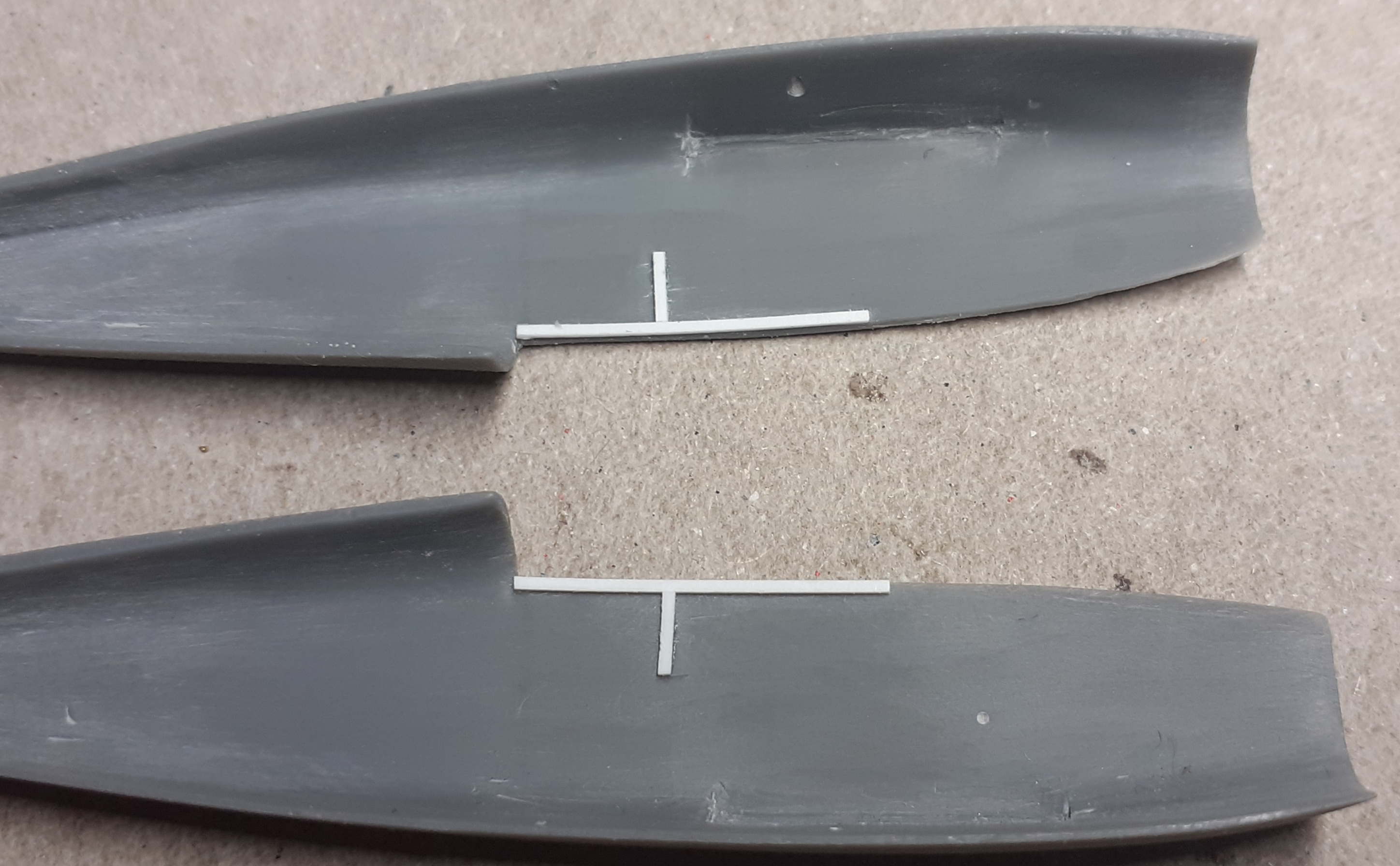

Some more work done.
Tail skid unit with corrected dimensions
Missing truss elements in the cockpit area added to the fuselage sides
The Albatros style front fuselage lines filled with CA, to be sanded and the OAW style lines to be rescribed.
And the upper wing assembled from three elements, the joints filled, the radiator is shaven to be replaced with PE.

Thanks.
Andreas, I will surely not use all that Part stuff, e.g. the turnbuckles are certainly beyond my skills.
And in the meantime, the stings are prepared
The air pump and the interupter lever retrieved from Roden engines prepared to be added to Eduard one
Final shape corrections of the tailskid
And some corrections of too soft edges
« Last Edit: December 13, 2023, 10:18:05 PM by PrzemoL »
