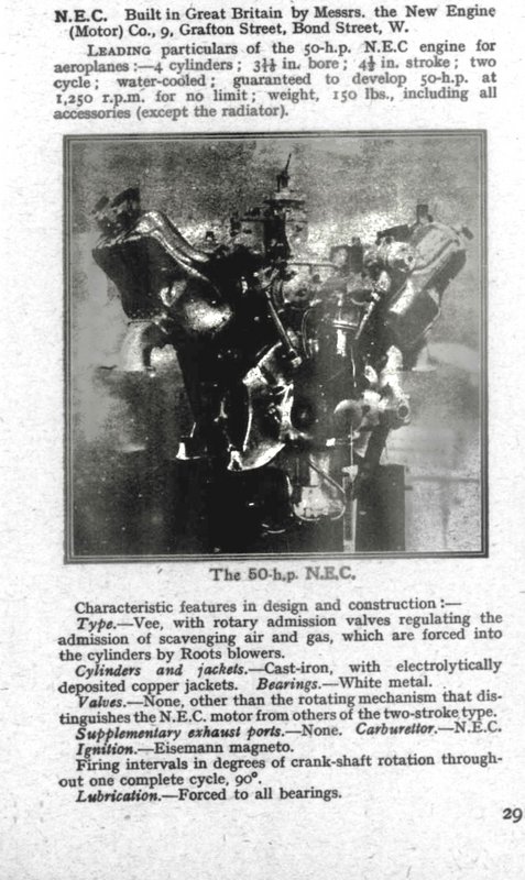

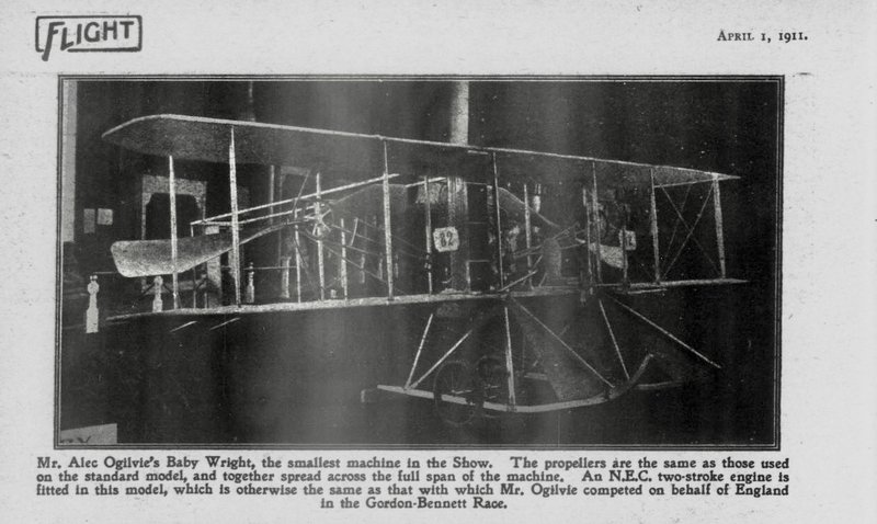

Hi Stephen, I did some poking around in Flight magazine, and in the April Fool's issue for 1911 there was an article on the 3rd Olympia Intnl Aero Exhbition that had some interesting stuff, including this photo of Ogilvie's "Baby" Wright, which the caption stated was the same as his previous year's aeroplane, except for the new two-stroke NEC:
... In the same issue, a few pages along, it had this picture of the 50 hp NEC two-cycle, which I assume is the same motor they were refering to. Trouble is that it's a four-cylinder vee, whereas you mentioned you were looking for an inline:
... in January 1910 they had an article on a 4-cyl 2-stroke 40 hp that looked to be an inline, but how that fits into the mystery I have no idea. I loved the "electrolytically deposited copper jackets" though, that'd look pretty cool.

Many thanks Berman and Dutch: I had clearly made a mistake in assuming that the NEC engine was an inline when in reality it was a V.
Dutch: the photo of the Baby Wright is very helpful, and it is clear that the NEC engine mentioned was the one used in the 1911 Gordon Bennet race. (Olgivey competed in the 1910 race in the Baby Wright but with a different engine).
