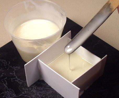

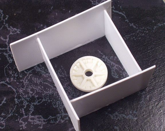

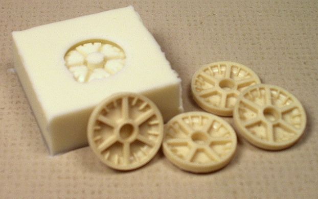

If I find something I really like and know I will want it for something else, I've taken to making a mold so I can cast it up again in the future.
I only had 1 Bf-109 wheel in 1/24 and I needed 4.
I have a set of Eduard DV wheel/tire I will need soon.
