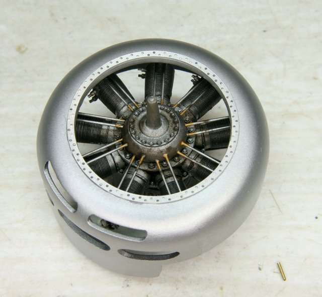

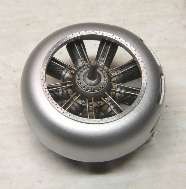

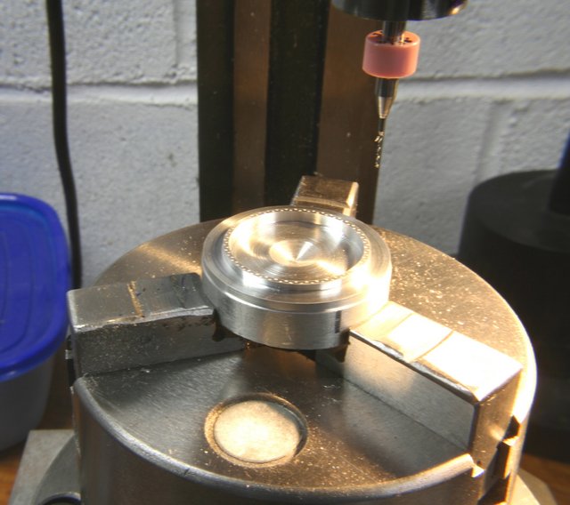

The cowling has a reinforcement ring on the front that is riveted around the cowling opening.  I machined such a piece, not having the capability to photoetch one.
Here I am drilling shallow holes to simulate the rivets.  Next I parted the piece off in the lathe.
Here's a test fit.
It was too bright, so I painted on a flat coat to better match the rest of the cowling.

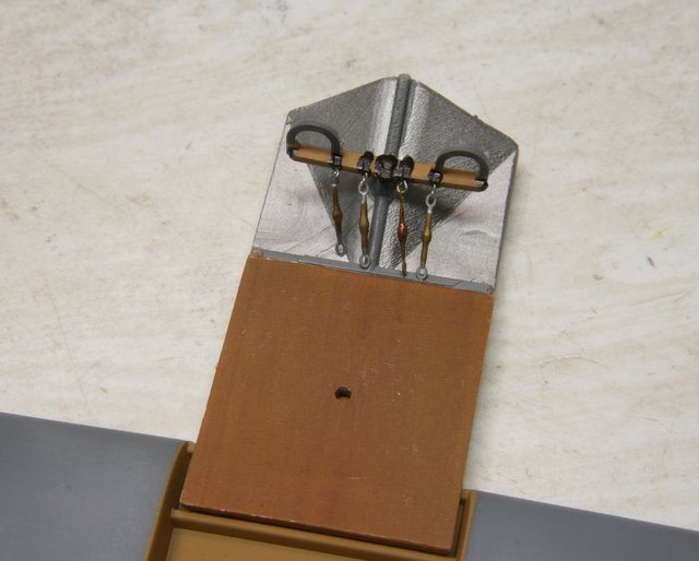

Then I went back to the interior.  Here's the rudder bar with PE turnbuckles and the pilot's floorboard.

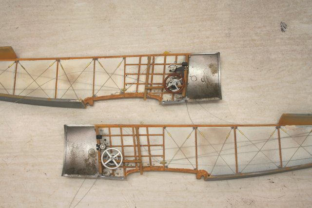

There's two details that Roden left out that I thought should be on the model - the pulley that activates the air brakes, which is visible on the observer's floor and the bottom of the control stick which is visible on the underside of the fuselage.  I milled this slot into the bottom of the fuse and will later put in a half-round piece that represents the bottom of the control stick.  It will be partially covered with a thin metal cover.
Here, I've added more interior detail - more pieces for the air brake actuator and cables for the adjustable tail plane.  Next will be some fuel lines from the gas tank.  I plan to hook up the rudder and tail skid cables after the sides are on.  Keeping my fingers crossed that this will work out.
