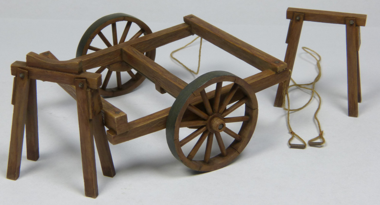

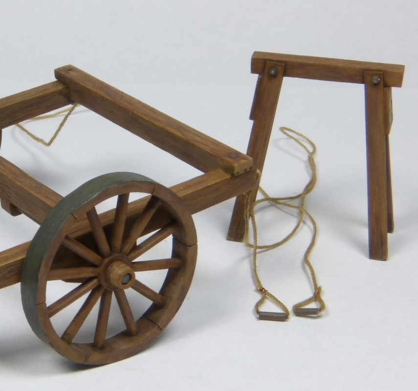

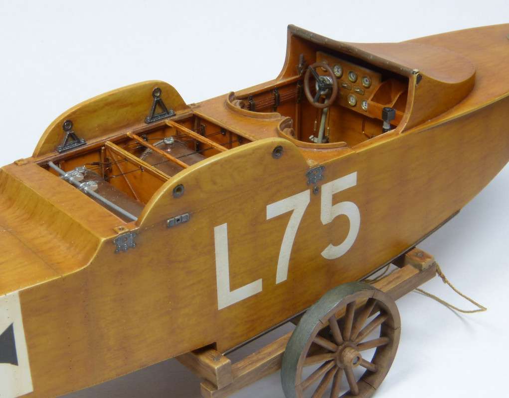

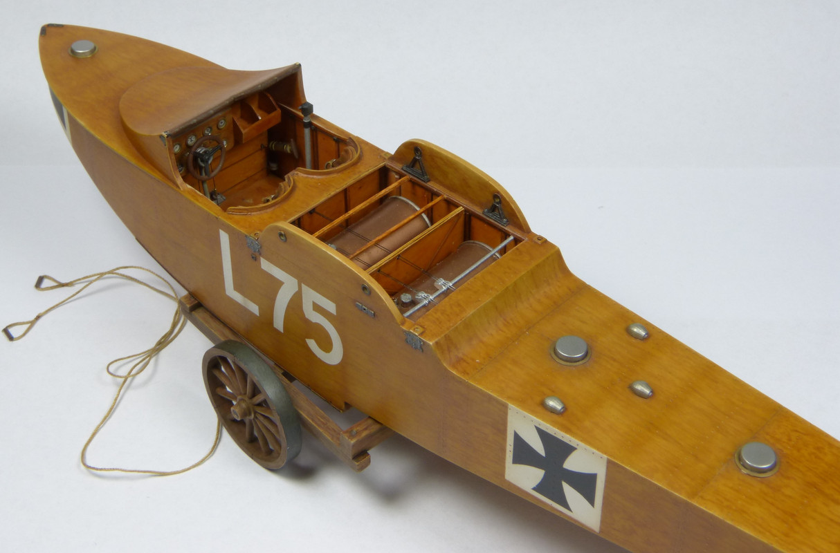

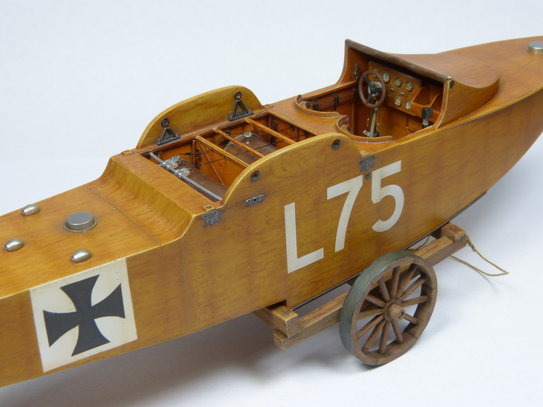

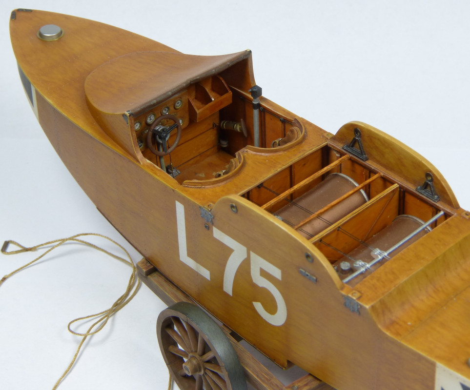

The Lohner project is back, after a long break, I decided to finish this model. The work has been going on since spring, so it's time to show the progress. I've already shown something on Facebook, but I think this report should also appear on this respectable forum. Especially since not everyone uses this garbage dump that is Facebook.

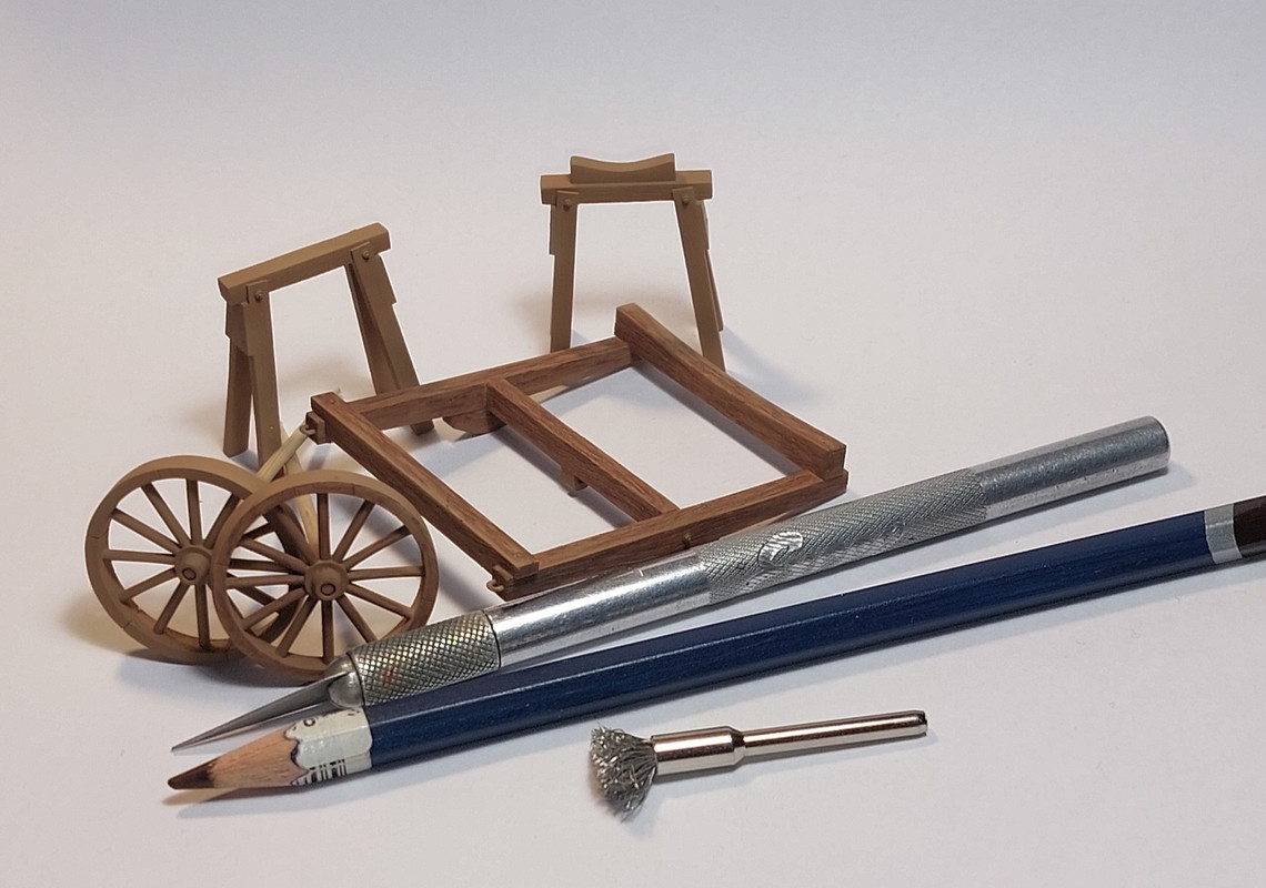

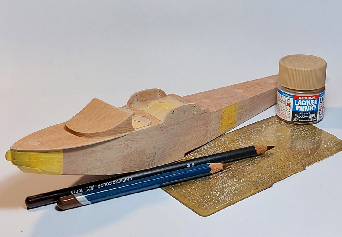

Now that is absolutely stunning! Beautiful rendition of the wood and superb detail painting.
Could you explain how you did the wood? Did you use the coloured pencils through the template?

WOW! That is just incredible.
Alan.

Re: FLYING BOAT LOHNER TYPE T 1:32 scale LUKGRAPH
« Reply #25 on: August 05, 2025, 06:21:53 AM »
As you can see in the first three photos, first a stencil, then some corrections with crayons, then a mixture of clear orange with the addition of smoke and clear yellow, and several layers of clear varnish, all from Tamiya LP

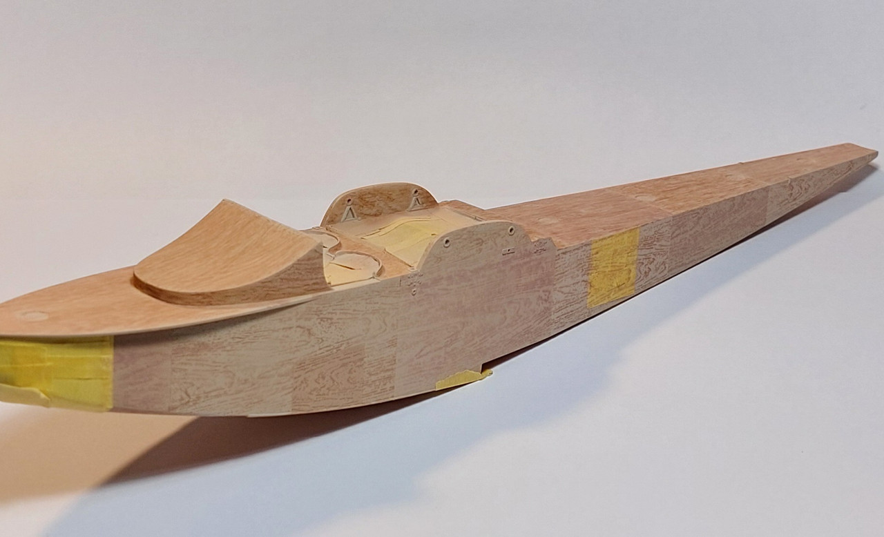

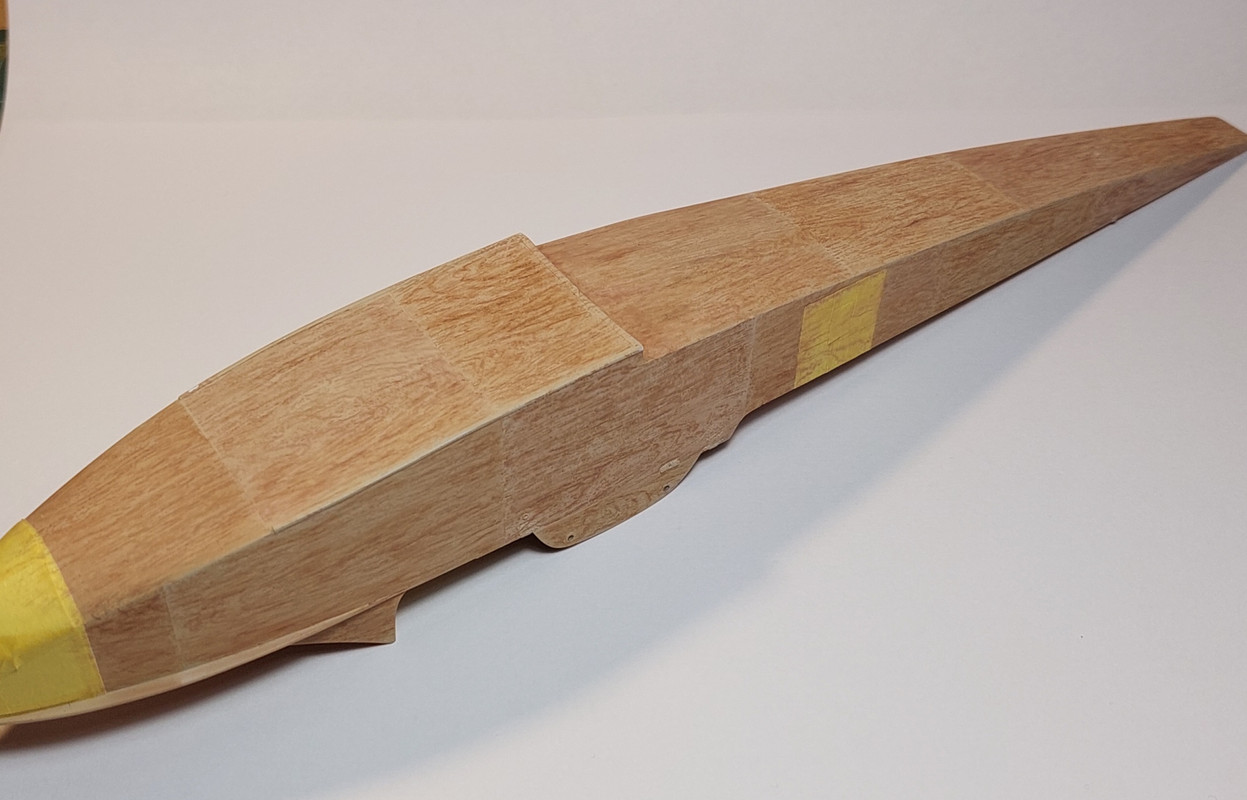

« Reply #26 on: August 05, 2025, 06:30:38 AM »

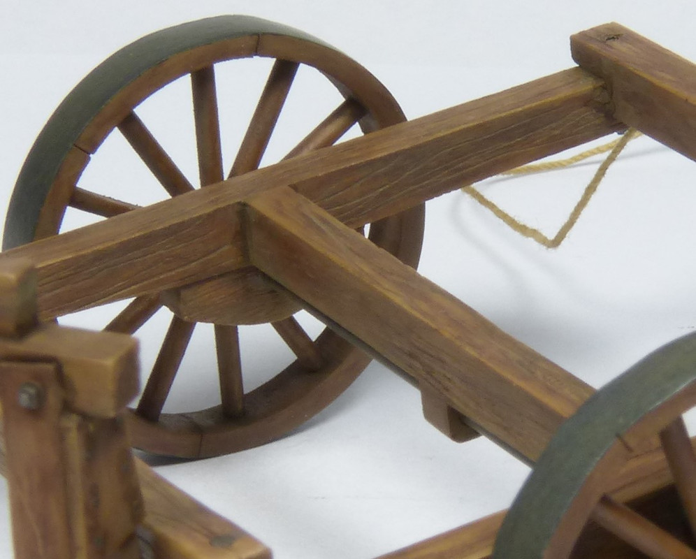

Working with wood continues
Thanks, it looks really effective. I am going to try that approach, thanks for sharing.
