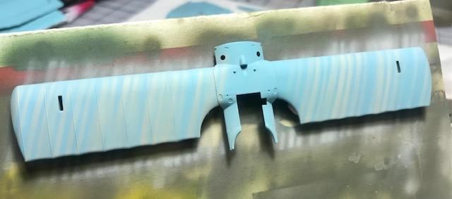

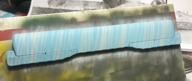

Offline Allan31
  • Posts: 775
Re: Eduard Dr1, VOSS triplane, 103/17.....I choked..
« Reply #4 on: January 27, 2023, 10:56:11 PM »
In looking more closely at the Aviattic decals, it does seem they attempted to get that silver/grey in there.
In keeping with the eye witness discription, I went with a different green, FS34087.
As someone mentioned, I'm going to go with a more grey color rather than a silver.
"Swing and a miss, strike one..."
I went too heavy with the green. This will give me the chance to dial back the silver as well when I redo this.
Almost.....
« Last Edit: February 06, 2023, 06:50:14 AM by Allan31 »
  • Posts: 1486
« Reply #5 on: January 28, 2023, 12:16:35 AM »
Allan,
        Part of the beauty and fun of doing Voss' Tripe is that we'll truly never know about the color and streaking with any authority. (Nor the cowling color.)
Do you want another monkey wrench thrown in the works? ;)

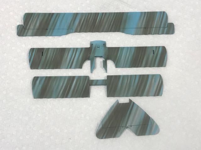

Offline Allan31
  • Posts: 775
« Reply #8 on: January 28, 2023, 01:38:16 AM »
Thanks all, it's easy enough to redo and I think I can get a little closer, more this afternoon.

Offline Allan31
  • Posts: 775
Re: Eduard Dr1, VOSS triplane, 103/17...Streaking MkII...
« Reply #9 on: January 28, 2023, 05:15:15 AM »
I know it's a subtle difference but this is better...
I got rid of "silver", why would they use that? Grey.
Added less green.
Still a little heavy on the middle wing but I'm going with this.
Mk 1...
I could still get away with less streaking but....
Onward....

Offline rasbury
  • Posts: 12
« Reply #12 on: January 29, 2023, 01:49:48 AM »
You’ve broken the code on in-scale streaking. Amazing!
« Reply #14 on: January 30, 2023, 02:22:04 AM »
You are producing Terrific results with your method! I agree with one comment you made, in particular the center upper wing, looks a bit heavier/darker streaked than the original.
