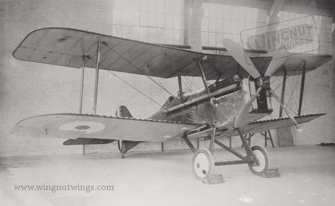

Did the upper surface color on the horizontal flying surfaces of WWI RAF/RFC wrap around the edges to form a border of the upper surface color on the lower surfaces? I'm thinking that it did, but I can't find any photographic evidence proving it.

Yes. There was a standardized length of the wrap... 1 inch maybe?

Hi Rob, an example
http://www.wingnutwings.com/ww/v98C7274C/www/products/model_kitsets/32003/archive_photos/SE.5a%20Hisso%20B607%20after%20a%20hard%20life%20at%20Biggin%20Hill.%20It%20has%20been%20fitted%20with%20strengthened%20wooden%20undercarriage%20legs.jpg

Yes, that's exactly what I was looking for. Thanks.

Although it was fairly standard, as always there were exceptions. One thing to note is that the trailing edge was sometimes included and sometimes not. In the end unless a photo of your subject exists the SE in the Link is a good example.
