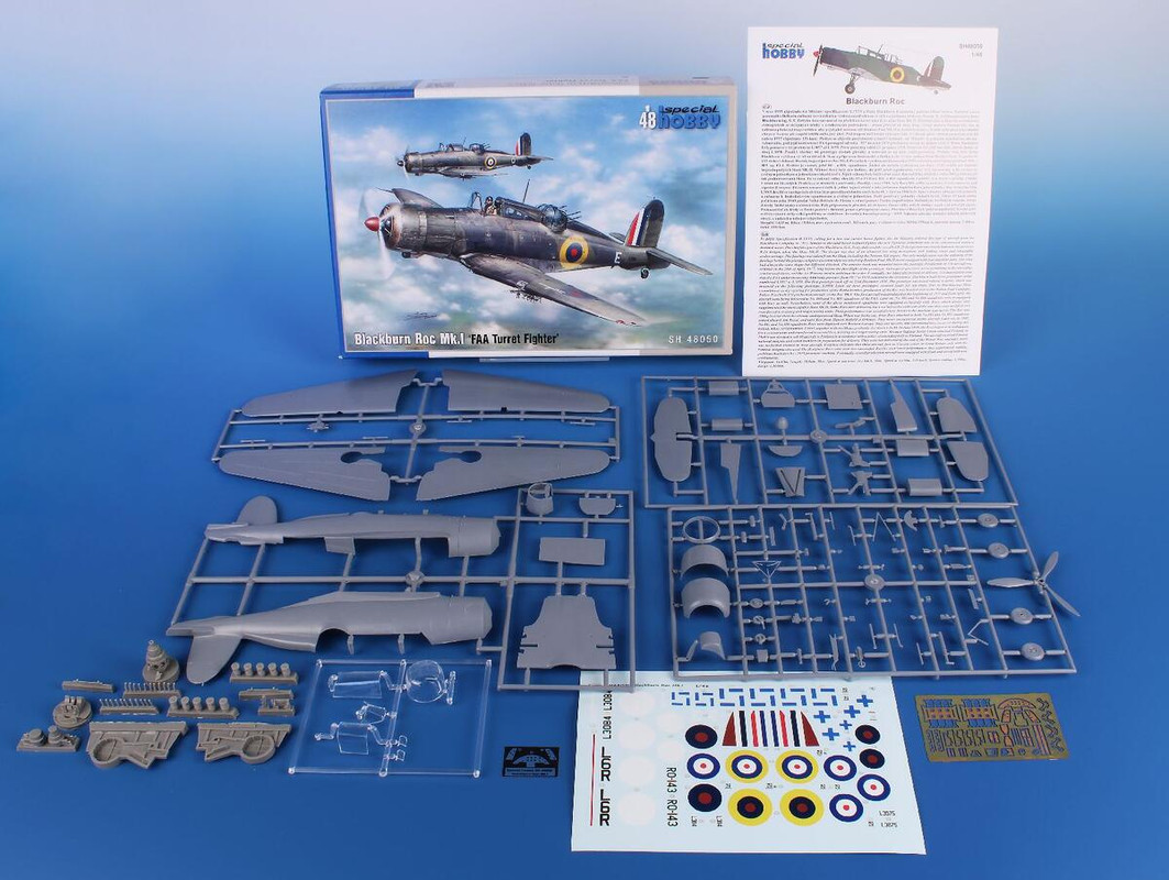

Contents: four grey and one clear sprues; twelve grey resin blocks; one PE fret; one acetate film; four decal options.

Special Hobby’s model
Perhaps befitting the type’s inglorious history kit makers have been reluctant to produce models of the Roc: a quick survey online shows only two 1/48 kits to have been produced while small-scale builders are better off with five options in 1/72 and a solitary 1/144 resin kit.
According to Scalemates this kit was originally released by Special Hobby in 2007 and based on contemporary kit in-box reviews/previews the kit is unchanged, except for the resin parts being cast in grey rather than the original tan. Even the colour scheme options are identical.
Despite the age of the moulds the kit parts have no flash and the detail – particularly on the resin parts – is still delicate and unblemished.

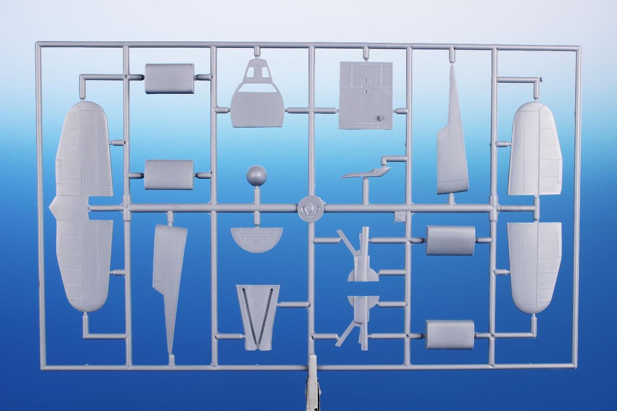

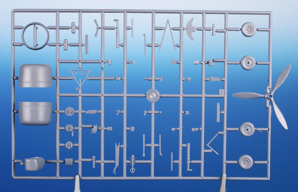

SH’s short-run heritage is on display here as butt-joins are everywhere with not a single alignment tab or slot in sight outside of the cockpit, and plenty of ejector pin towers (most of which may be ultimately hidden during the construction process, but some appear in inconvenient places like seat pans and wheel halves). Surface detail is a mix of engraved lines and raised plates where appropriate.
The wing is moulded in a surprising seven parts – upper and lower halves for each outer wing, a lower centre section, and two upper stub wing/fillet pieces. As there are no tabs or spars to assist in keeping everything aligned the wheel wells must do the job as, on first glance, the mainplane assembly looks like a job for superglue…and perhaps prayer! My guess is that the parts are separated along the wing fold lines however there is no option to do this, nor any internal parts.
The clear parts are nicely moulded with raised panel lines – this is helpful as no masks are included and these lines should make use of masking liquid a breeze.

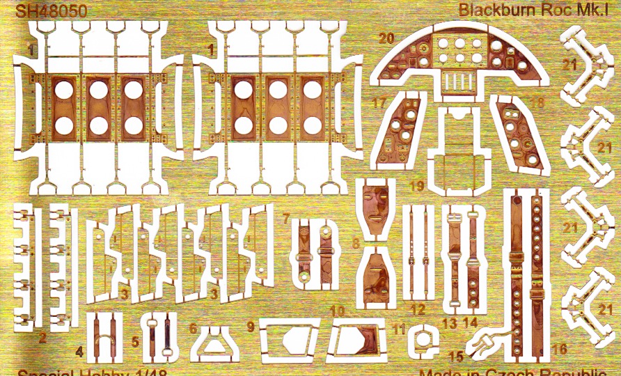

The resin parts are wonderful. These cover one-piece main wheel wells, the Bristol Perseus engine (crankcase and separate cylinders – nine are needed but 10 are provided) and a staggering 22 exhaust parts (no doubt allowing some spares for any accidents one might encounter), two large bomb racks and an assortment of parts for the dorsal turret are all exquisitely detailed, particularly the engine. The PE fret covers the instrument panels (an acetate film is also supplied for this) and seat belts, as well as the smaller practice bomb racks which will involve some delicate bending and gluing. Unfortunately, no stores are supplied for the various bomb racks – neither are locating tabs, with only measurements from the wingtip given in the instructions for guidance.

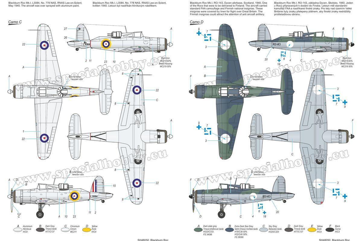

Markings:
The kit features four marking options, all Roc Mk.Is:

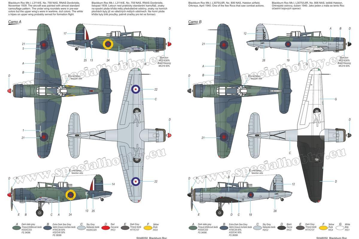

1.   L3114/E of No.759 Naval Air Squadron, Fleet Air Arm at RNAS Donibristle, November 1939. This aircraft wears camouflage of Dark Slate Grey and Extra Dark Sea Grey over Sky Grey with a Red spinner.
2.   L3075/L6R of No.806 NAS at Hatston Airfield, Orkneys, April 1940 is described in the instructions as “one of the few Rocs that saw combat actions[sic]” although does not explain further. This aircraft wears an interesting scheme of Dark Slate Grey and Extra Dark Sea Grey over a high demarcation line Sky Grey with the starboard wing unders completely in Black (port) and White (starboard).
3.   L3084 is another Fleet Air Arm aircraft, this time from No.778 NAS at RNAS Lee-on-Solent in May 1940. This aircraft is overall Aluminium with basic markings.
4.   RO-143 is a Finnish aircraft depicted at Dycen aibrbase[sic], Scotland in 1940. The instructions explain the national insignia (diplomatically printed in two parts on the decal sheet and similarly depicted here) “were covered by linen for flight over Great Britain” as the swastika could trigger British AA crews! This covering could make for an interesting addition to the model however more research is needed by the modeller as nothing further is explained.
The decal printer is unnamed except for a small “FH” logo, but they appear to be similar to Cartograph’s work in other Special Hobby kits: opaque whites, good solid colours, but some stencils are difficult to read without magnification and appear fuzzy.
