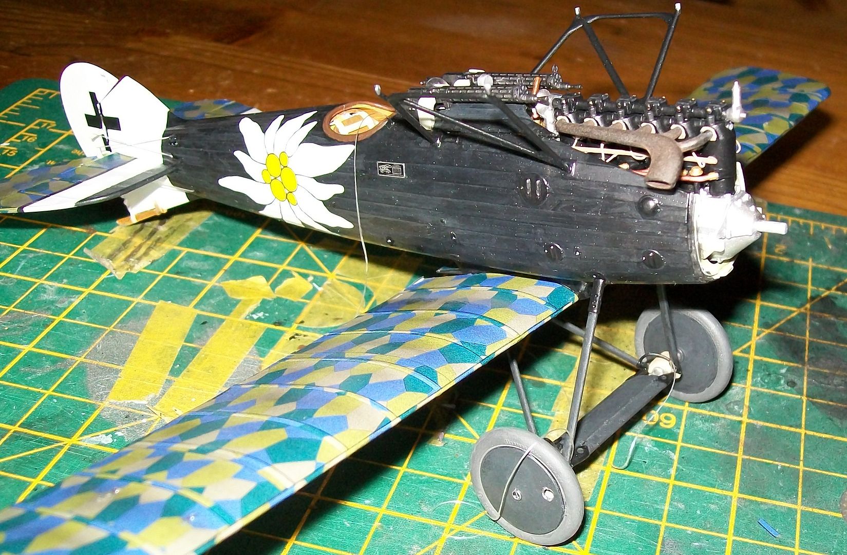

« Reply #69 on: February 20, 2013, 08:05:01 PM »
Cheers Lance :)
This pic shows the model almost complete.  The lighting was poor so the representation isn't great and the lozenge dulling isn't clear.  I'll look to take better pics under natural light later.
All that needs to be done is to do the rib effects on the rudder, attach the top wing and radiator pipes, prop and spinner and glue the undercarriage - and then rig.  The rigging lines are already attached to the top wing, and I am gluing the lines directly into the wing locations without turnbuckles.  I may make a simple turnbuckle representation with paint but I'll see about that later...

« Reply #74 on: February 22, 2013, 05:23:47 AM »
Thanks folks.  I deliberately used mattcoat with a hand brush to represent a painted surface over the original "wood" - this effect has less contrast under natural light - the matt surface is reflecting the flash too much here.
Top wing on, eventually, and rigging started.  As you may see from older pics, the cabane struts were sat nicely in place, so much so I did not glue them at first to the fuselage.  Mistake.  Having glued the top wing on cabane struts and radiator pipe first, when I attached the outer struts the movement of the wing caused the cabanes to pop out of the fuselage.  This was rectified later, but it is a bit like the old plate spinning trick!  The attachments are not perfect, but not so bad as to put the wing out of place.
In my haste to get the top wing on, I forgot to drill out the lower wing rigging locations, which are painted and decalled over.  It is a bit tricky to clear these down to virgin plastic for the CA to adhere to with the top wing in situ, without damaging the lozenge.  Never mind, one line at a time and it will be ok.  Pics to follow later.
