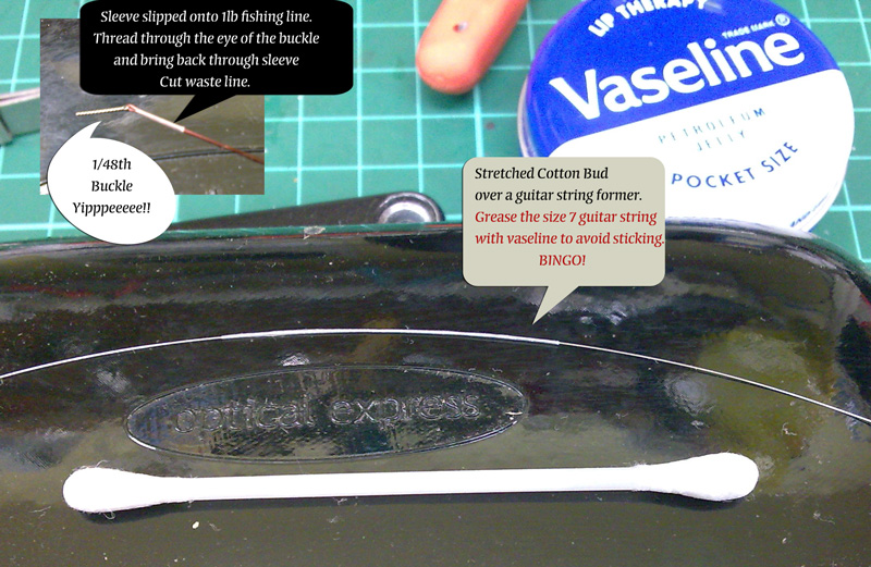

Very sharp. The ear bud/turnbuckle method - tube is heat stretched?

Thanks - yes, heat stretched handles over candle flame.  Takes several attempts to get the right size tube without becoming fine hair!  Also, I'm still fairly new to this method so taking me some time to develop a knack with it.   In some ways, I find drilling straight through a wing and pulling line through easier.   I will most likely use a combination of methods for my future builds.

Cant beat the Bob's Buckles method!
Sorry for jumping over this thread  ???
Steve,
Here is one I prepared earlier... like, years earlier! Thread the former through the q-tip tube  soften the cotton bud handle over a flame and with beating heart and sweaty palm, pull for all you're worth! Takes a weeee bit of practice, but practice makes perfect... So I'm told  ;D
Hope it helps with producing cotton bud tubes of your own. You will need to scale up the wire former for 1/32nd goodies.
Von Busy Buckle-Maker  :)

Steve -
You might look into Polyimide tubing from Amazon Supply.  The stuff comes in diameters down to where you can hardly tell it's hollow.  It's not very expensive, and compared to the process of stretching the cotton bud tubes (which I used to do) it's down right cheap.  You can get it here:
http://www.amazonsupply.com/translucent-amber-miniature-polyimide-tubing/dp/B003TLNL5I/ref=sr_1_1?sr=1-1&qid=1359148509&filterBy.feature_seven_browse-bin=5485625011
Give it a try.  I bet you'll never go back to stretching cotton bud tubes!
