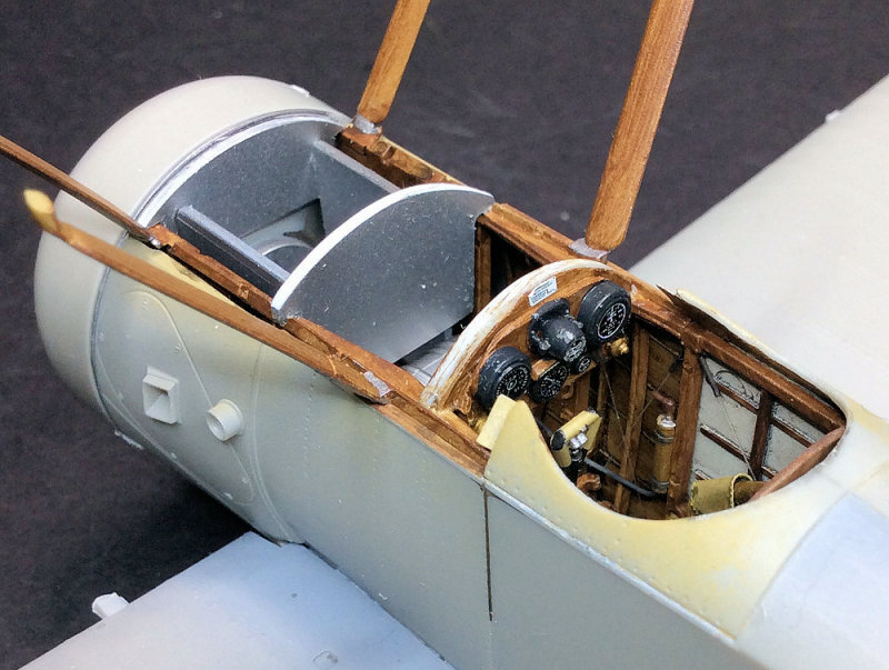

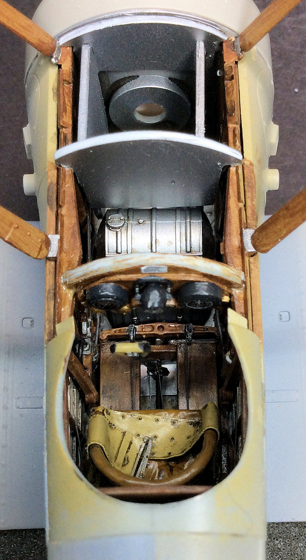

Hi all,
The cockpit so far.
The details of what was done is a bit lengthy to post here.
However, it will all be in my build log once the model is finished.
Basically:
The cockpit decking panel was cut a the rear used to create the new panel.
Instrument panel cut and attached to a plastic card curved former.
A box of two forward former's was made and attached to the rear of the engine bulkhead.
The fuel tank and rudder bar attached to the lower wing.
Foot boards modified with the control column.
Seat frame cut and a 'Barracuda' resin seat attached.
False firewall added behind the pilots seat.
Left cockpit side frame - throttle assembly moved one bay rearwards - vertical and horizontal structure added with plastic rod and strip.
Right cockpit side frame - pressure pump moved one bay rearwards - vertical and horizontal structure added with plastic rod and strip.
Revised fuselage forward decking panel (x2) cut and shaped from 0.2 mm thick plastic card (will be be fitted over the added fuselage former's after closing the fuselage.
There's still other detail to add to the cockpit after painting (wires, cables and pipes etc)
Sopwith 'Camel and Comic' overlay (side profiles).
« Last Edit: January 23, 2022, 08:52:59 PM by Mike 'Sandbagger' Norris »
