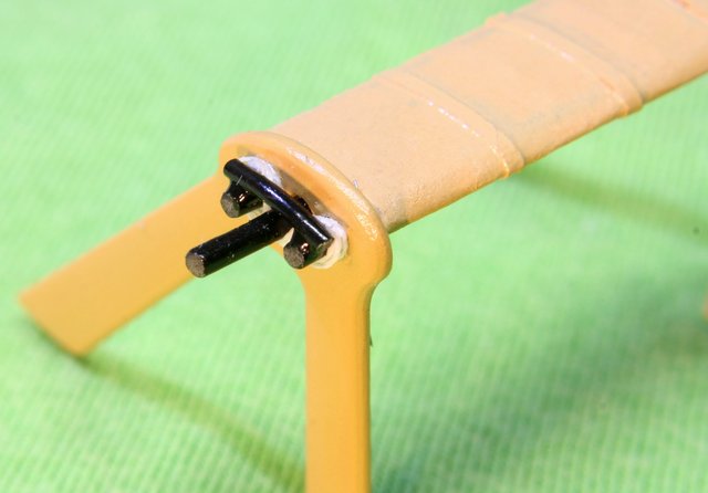

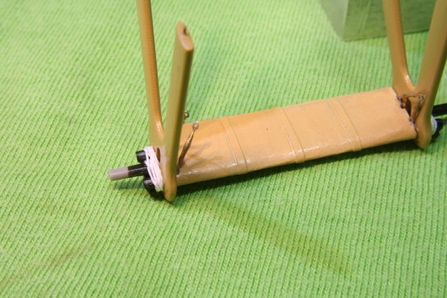

I've tackled the landing gear, but then thought I should deal with the worrisome louvers before attaching them, as they will block access to the lower louvers.  I added white thread for the bungies and tied the lower turnbuckles in using monofilament.
A test fit.  The PE brackets add to the realism.

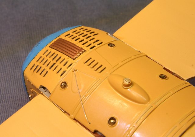

I used oil paint and a fine brush and a steady hand to paint in the openings.  Also did the perforated valve coverings.
Overall washes and weathering still to come.

Excellent painting skills! The openings really look like openings, I think.
Re: Roden 1/32 SPAD XIII - detail added
« Reply #94 on: September 14, 2021, 04:38:24 AM »
Wow, all those vents and perforations look fantastic. I like the idea of using oil paints for this, presumably because you just wipe off errors? I have my note pad out again!

Yes, I chose oil paints for the louvers to have enough time to clean up the errors before the paint dries.  I started with black and mixed in some white and yellow so the color contrast would not be quite so great.
