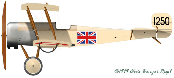

Since I like to have the Union Jack in my cabinet I think I will build this one:
Source: http://www.cbrnp.com/profiles/quarter1/scout.htm
Other references are the Windsock Datafile 44 ...
and of course the great photo collection by Richie on Flickr!
That marking brings up the first question. Many different rotary engine types were used on the scouts, at least the 80 hp types Le Rhone 9C, Gnome 7 Lambda and Clerget.
I have the Small Stuff sets for the Le Rhone 9C and Gnome 7 Lambda, but I think the 1250 was using a Gnome 7 Lambda, according to the picture on page 9 in WD44. Are there any dissenting voices or have I overlooked something?
