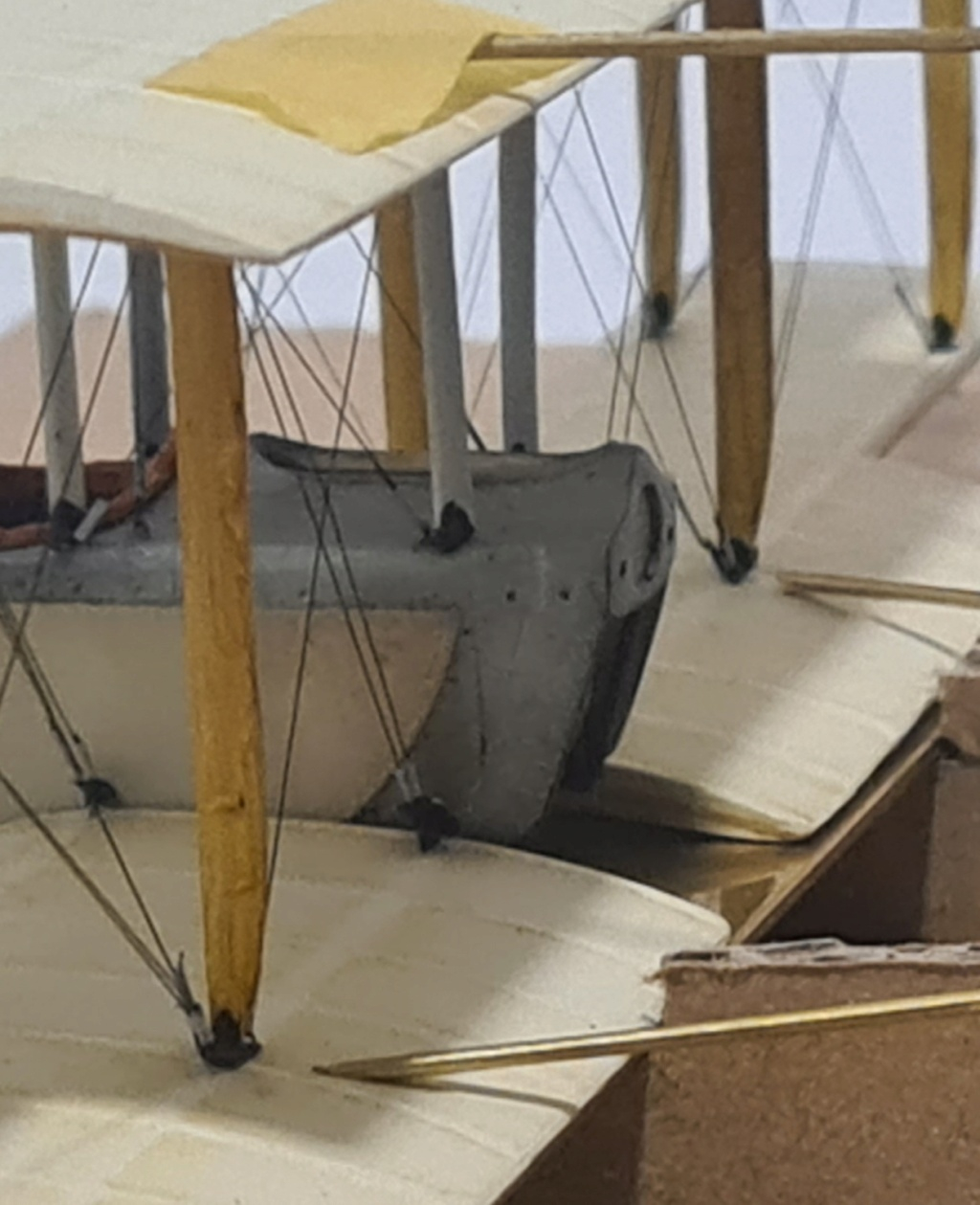

Hello,
Thank you very much!  :)
That's a good step forward!

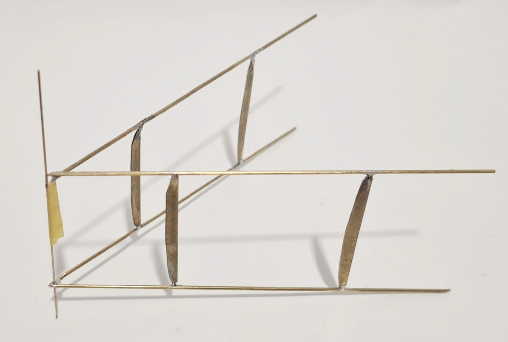

Well, now I'm going to have to peel off the entire tubular structure and redo it entirely.
It's out of proportions... I based it on a photocopy, which turned out to be too small... And I hadn't checked!
Arnaud

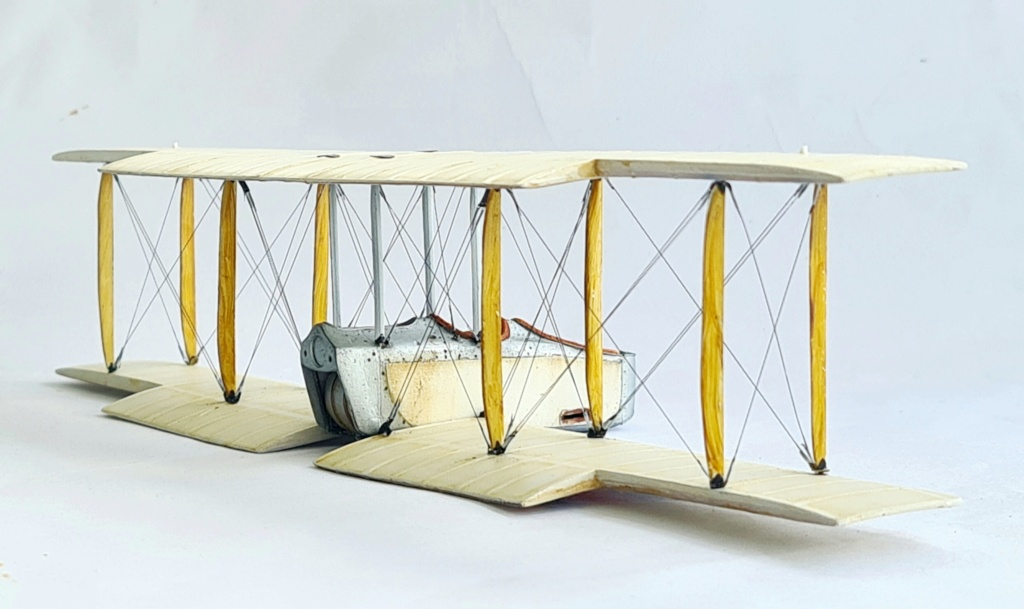

The rigging looks Fantastic! Sorry to hear about the setback on the tubular structure but I know you will get it fixed!

Really nice rigging. Always great to see the double wires.  I have not found a practical way to do this in 1/72.

Wonderful work, your commitment to this shines through.
Re: Vickers F.B.5 Gunbus, Bluemax 1/48
« Reply #79 on: June 23, 2023, 10:59:15 PM »
Wonderful work, everything looks so perfectly lined up. That's so impressive on such a complicated model.
« Reply #80 on: June 24, 2023, 10:22:01 AM »
Looking terrific and I second the call on double wires - wow!!

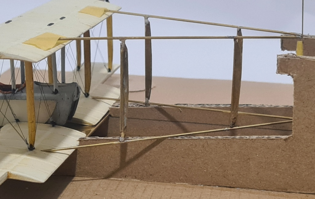

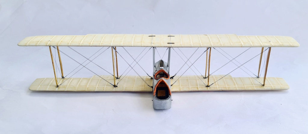

Hello!  :)

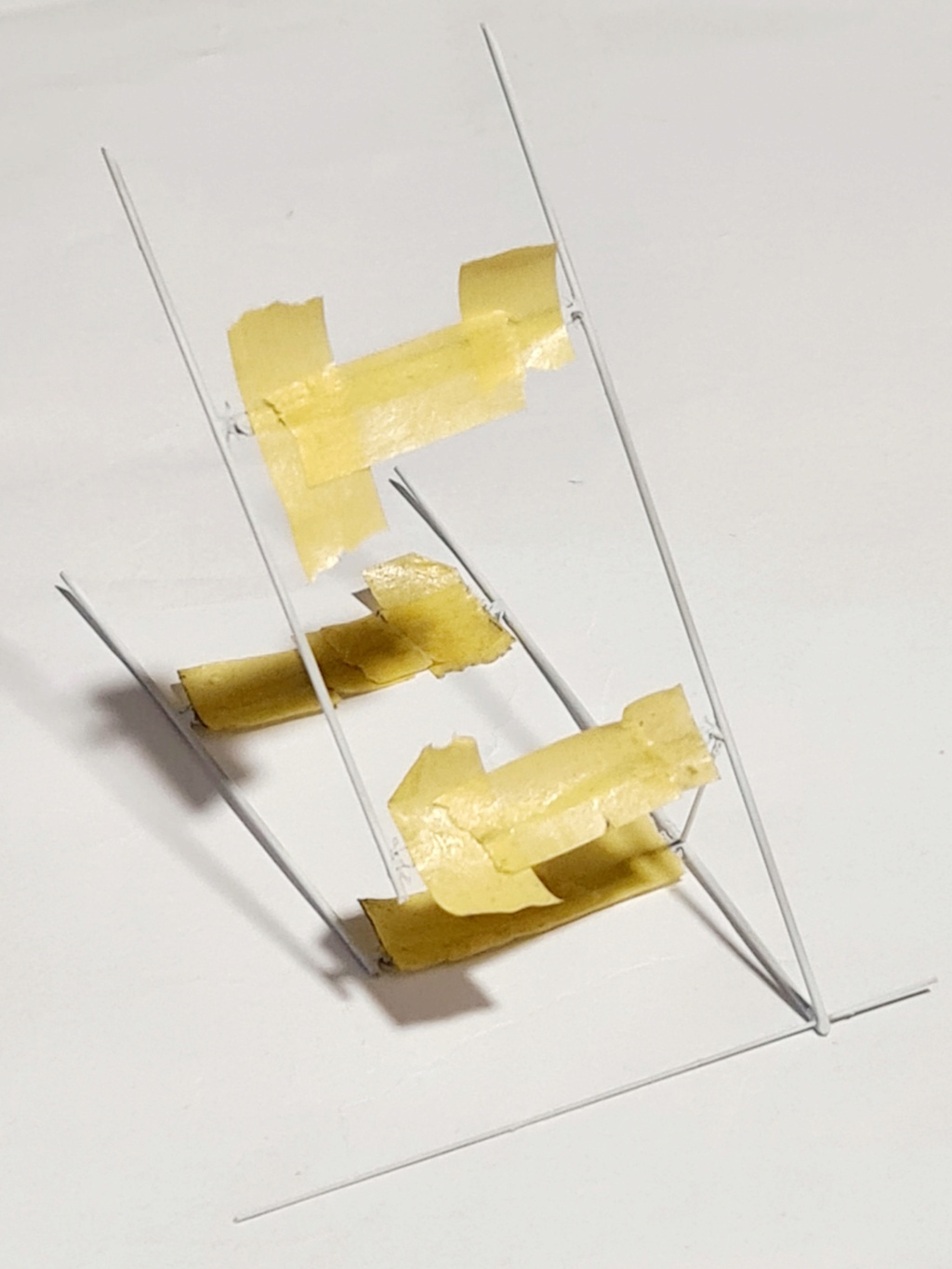

As planned, the structure has been rebuilt.
The main work is done.
There's still some work to be done before painting.
I think I'll finish this part tomorrow.
Arnaud

Wow! That is impressive work! I am equally impressed by Anyone who can scratch build a jig that works like yours  8)

Agreed! Arnaud, I'd love to see the plans for this jig. I'm too scared to start the build of this kit without one!

Hello,
I hadn't made any yet. But it was getting complicated for this stage. I simply took the 1/48 plan, drew a line from the lowest part of the "fuselage, lower wing" area to the base of the structure above the stand. Then I reproduced it on tracing paper, and reproduced it on cardboard twice before gluing it to a cardboard plate.
Just read through the whole thread, that is some stunning and meticulous work!
I think I can now glue the horizontal tail.

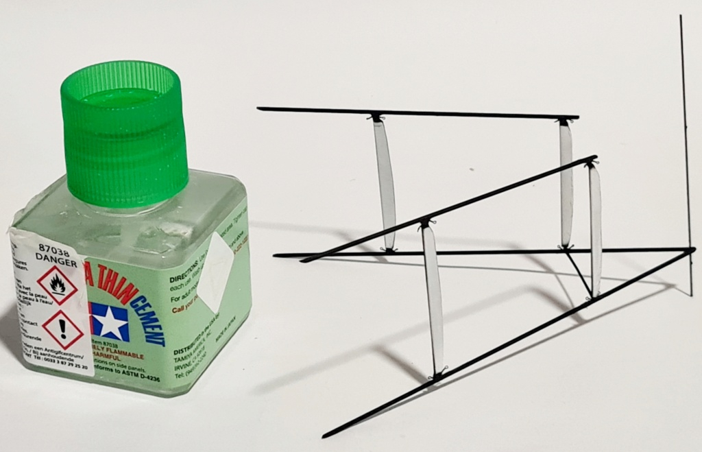

Obviously, Tamiya glue was no help here. This is just to give an idea of the size  ;D
This kit is a real battle, but what fun!  :D
Arnaud

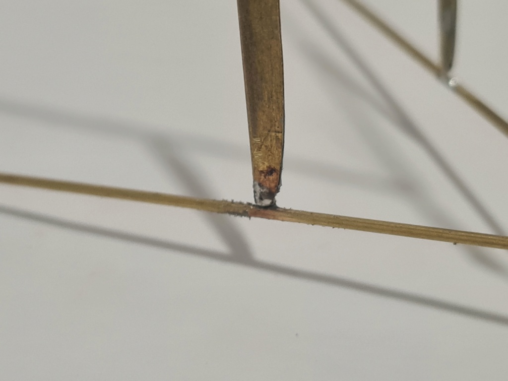

« Reply #87 on: June 26, 2023, 06:00:52 PM »

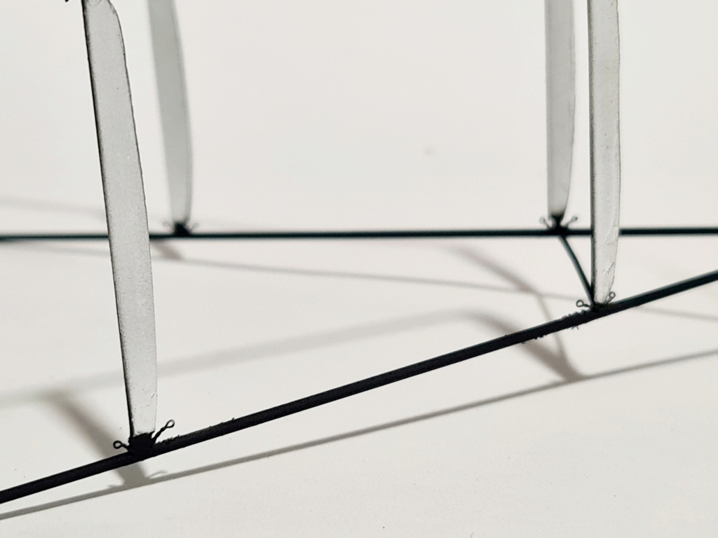

I'm very happy, the proportions are right and the beams are positioned exactly where they should be (without glue for the moment).
I think it's well on the way to being completed fairly quickly.
The landing gear will be the last problem to solve!
This is the most difficult model I've ever made.
Arnaud
