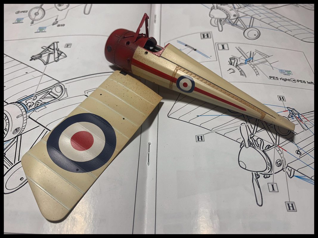

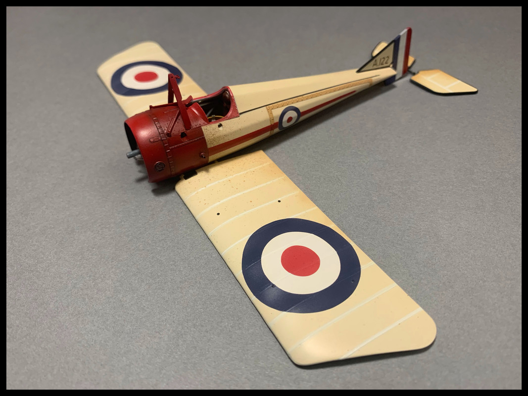

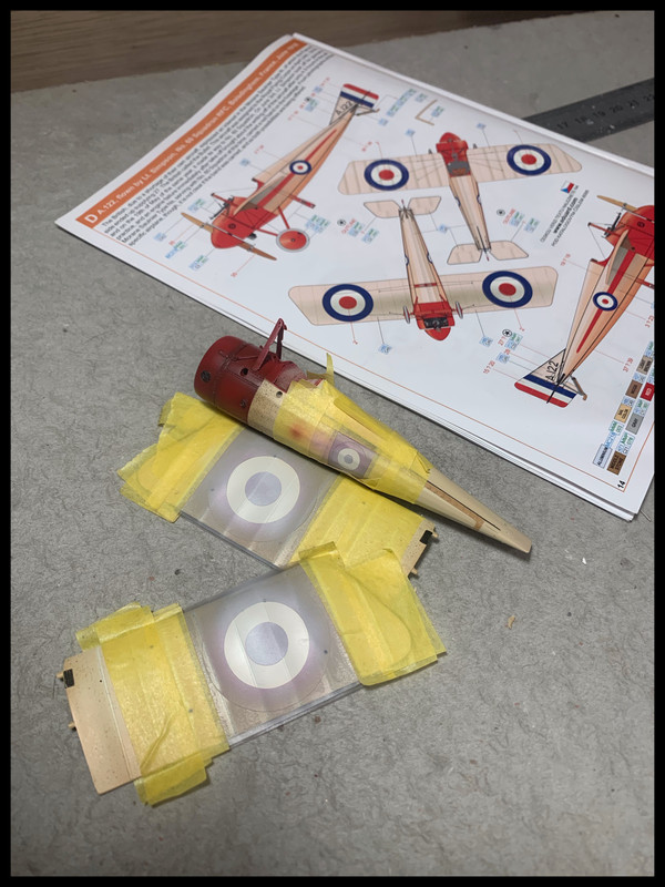

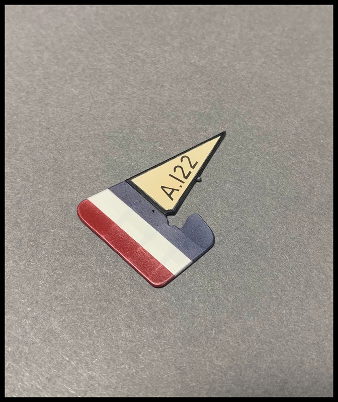

« Reply #42 on: March 25, 2021, 07:16:56 AM »
Thanks Gary & Fredrik,
The Swedish Postal Service came through today  ;D and I managed to sneak some time to use them. All went according to plan, just putting off the wings going on!
I have some Gaspatch turnbuckles on their way too, so I think I’ll have to wait for that if I go down the route of rigging the wings in place  ???

« Reply #43 on: March 25, 2021, 07:37:05 AM »
She looks awesome with the markings in place ! Excellent job on spraying them , very nice clean work !

« Reply #44 on: March 25, 2021, 08:20:56 AM »
Guy,
    I must apologize as I believe I may have given you some bad info. You had asked about the Morane Saulnier logo as displayed on the engine cowling of many of their aircraft. I had said brass on a black background which is true on a black cowling only apparently! I've been through all the refs I have and dug out the decals I was gifted by Des, they are brass design with a clear background. In the references the background is shown as red on red cowlings and so on and the photos , although black and white, appear to support the cowling color as the background for the MS Design.
  The "N" is looking very nice, it's going to be a real beauty when complete.  Hope this isn't too late and again, my apologies!
