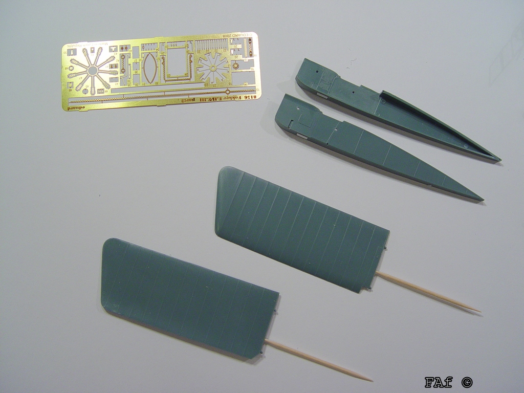

I'm sticking to Eduard and 1/48 scale after my (in the end) quite enjoyable Brisfit build. So far we've passed the stage where everything is up on toothpicks ready for primer, and the drill holes and prep for internal rigging stage.
I saw that there were turnbuckles to tighten the internal rigging and thought I'd use Gaspatch's 1/48 ones... but they were far too large so I made some turnbuckle representations out of white glue.

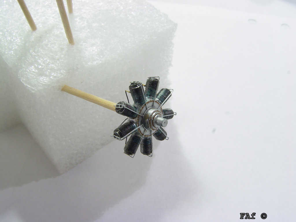

After having started on the wrong engine and almost completed that, this is where the proper one ended up. Nothing fancy except for what was in the box.

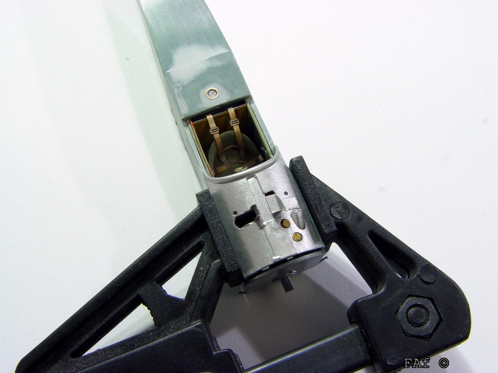

According to the WnW instructions there was a plywood floor and back 'wall', so I went for that. Maybe a little too large too look like 1/48 scale plywood, but it was fun playing around a little with the oils.
And this is where she is at the moment. I've done some dryfitting and worry a little about getting the fuselage together. There might be putty on the horizon...

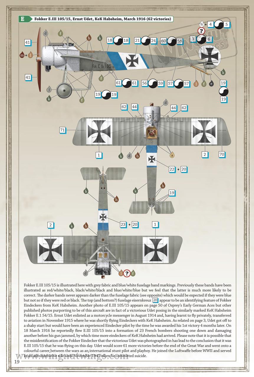

Terri: I've been looking a little at this scheme from the WnW boxing (Image linked from WnW website.)
But, I saw that there is an update to this profile where they suggest that the blue should be grey instead... I might go for blue anyway.

Further progress has been achieved... a little bit of one step back and two steps forward or the opposite in some cases.
The fuselage was closed, but needed quite a lot of filler, as I feared. The good thing about that is of course that once done you end up with a nice smooth surface.
PE stitching included in the box was attached. This time I simply placed it on the plastic and then ran liquid cement along it. Works just fine on flat PE.
When attaching the top cowl the fuselage needed a little persuasion in order to end up where I wanted it to be.
