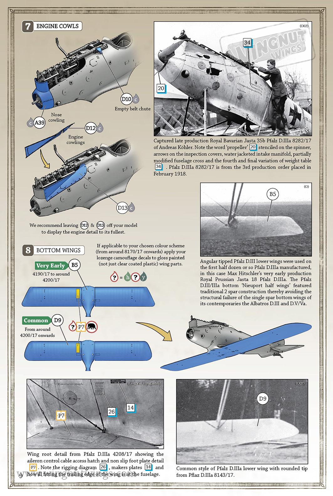

Does anyone know the serial numbers for the Pfalz D.IIIa with the early lower wing and serial numbers for the late lower wing?

From the Wingnut Wings limited edition Pfalz D IIIa instructions (still available to view on their website)

Comparing D.III and early D.IIIa photos, it seems that machines up to 4203/17 had the pointed ends. More may have had them, but I haven't seen photos to confirm.
