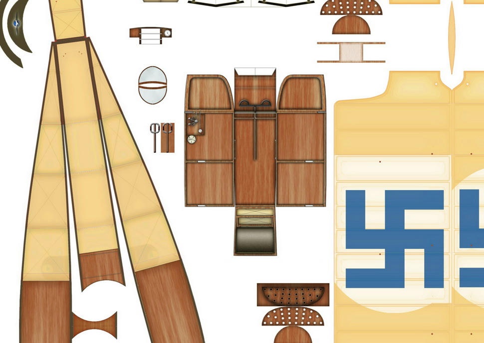

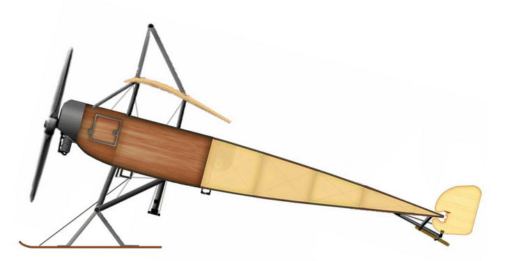

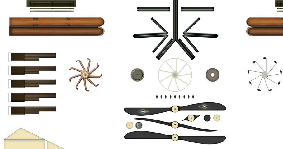

Look what I found on an old hard drive,
the finnish MS-Thulin typ D F1 in 1/48.

Marco, I will do my best with undercarriage and wing struts! ;)  Your 1/48 Finnish Parasol is lovely.  Your finishes are very realistic and appealing to me.  Thanks for sharing that.
