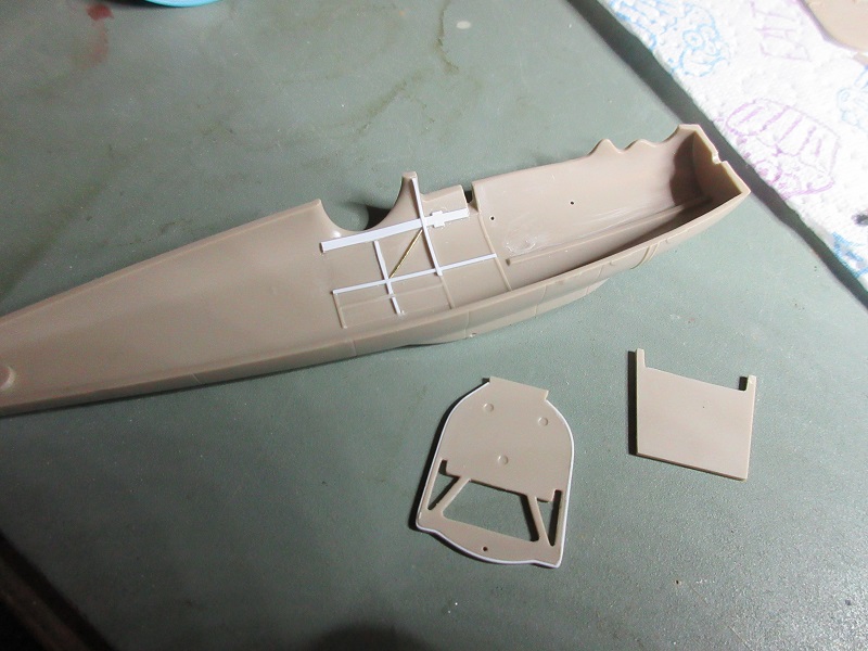

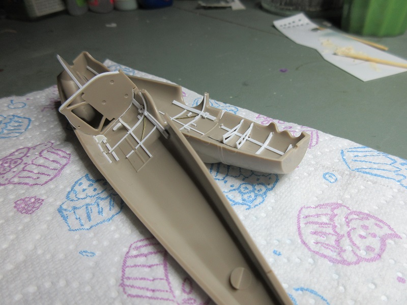

Still somewhat paranoid about misaligning the engine and/or Spandaus...I check about all I can check.
Found (part of?) the problem!
The frame in between the magazines and (missing) fuel tank is too small.
When you glue it to one side...there will be a gap on the other side...and the magazines will be off centre.
Easy to overlook...easy to fix also. A 0,25mm thick strip of Evergreen wrapped around the frame and it will fit like a glove.

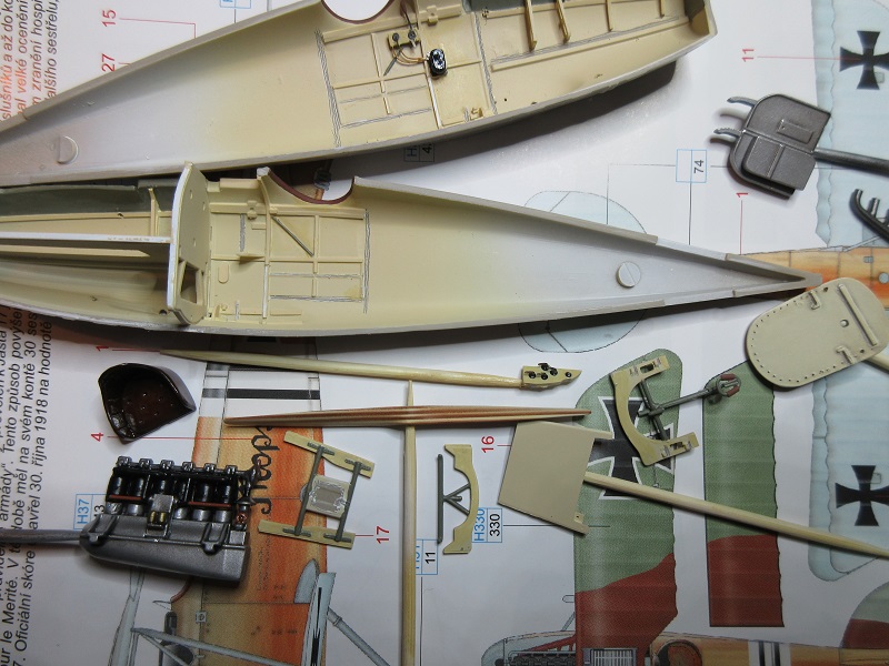

Ready for paint now...
Some extras, but most important...all the frames are now centered and "touch" both sides of the fuselage.
Endless dry fitting and many thin strips of Evergreen to get it all in line. Eduard...pffff. ::)
Okey...let's say the build starts...now. :)
Robin

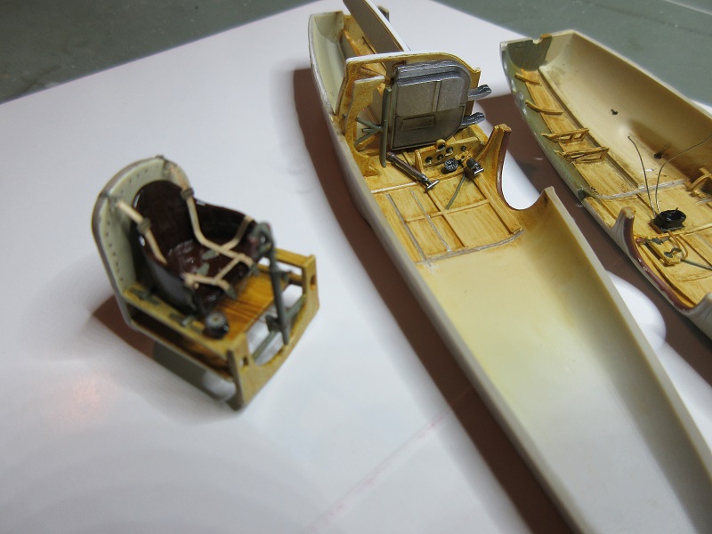

« Reply #22 on: December 29, 2019, 08:07:49 AM »
Thanks milady, thanks guys.
Threw some paint on here and there...
Interior ready for oils now.

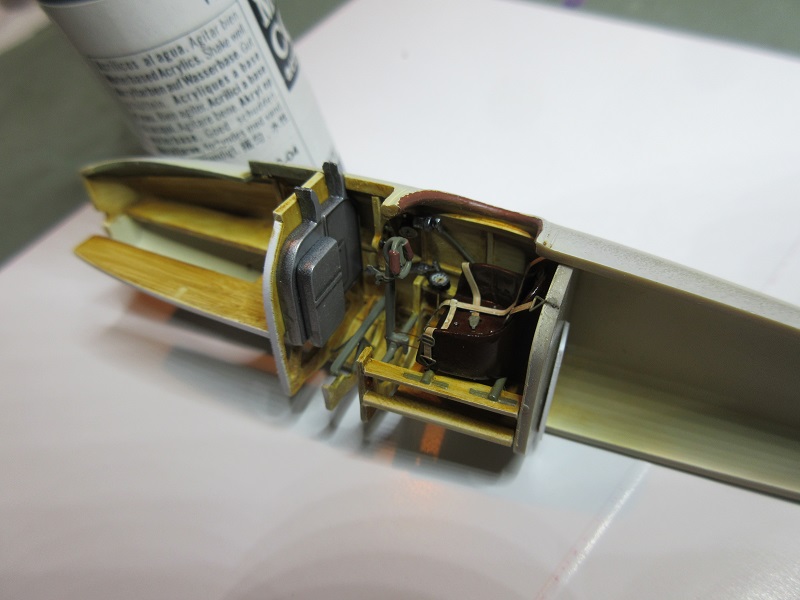

« Reply #25 on: December 30, 2019, 04:07:47 AM »
Thanks T. and Rick. :)
Almost finished the pit.
A couple of wires and the fuel tank to do before I can close the fuselage.
More soon,
