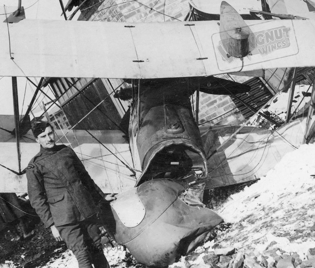

Well, I'm disappointed in you all. No-on spotted that between this:
and this:
the cockpit gained a linen back behind the seat. It had been bothering me, and I found a picture on the ever useful WNW site:
Fortunately, it wasn't hard to fix  ;D
Richard
Either looks great but for the record the AMC D.H.2 (Scout) spare parts booklet lists this item as "Part No. 4241... ...Back for Pilot's Cowl" and it was made from "Ash & 3 Ply". Not linen. This part is also shown as wood in the excellent article in WW1 Aero#146 from 1994.
The spare parts list also confirms "Part No. 4482... ...Flooring" was made from "3 Ply".

I'll get my paintbrush out
Richard
And thanks for the info on the floor

I was wondering if the panel behind the seat was linen covered ply? (as opposed to just linen).
