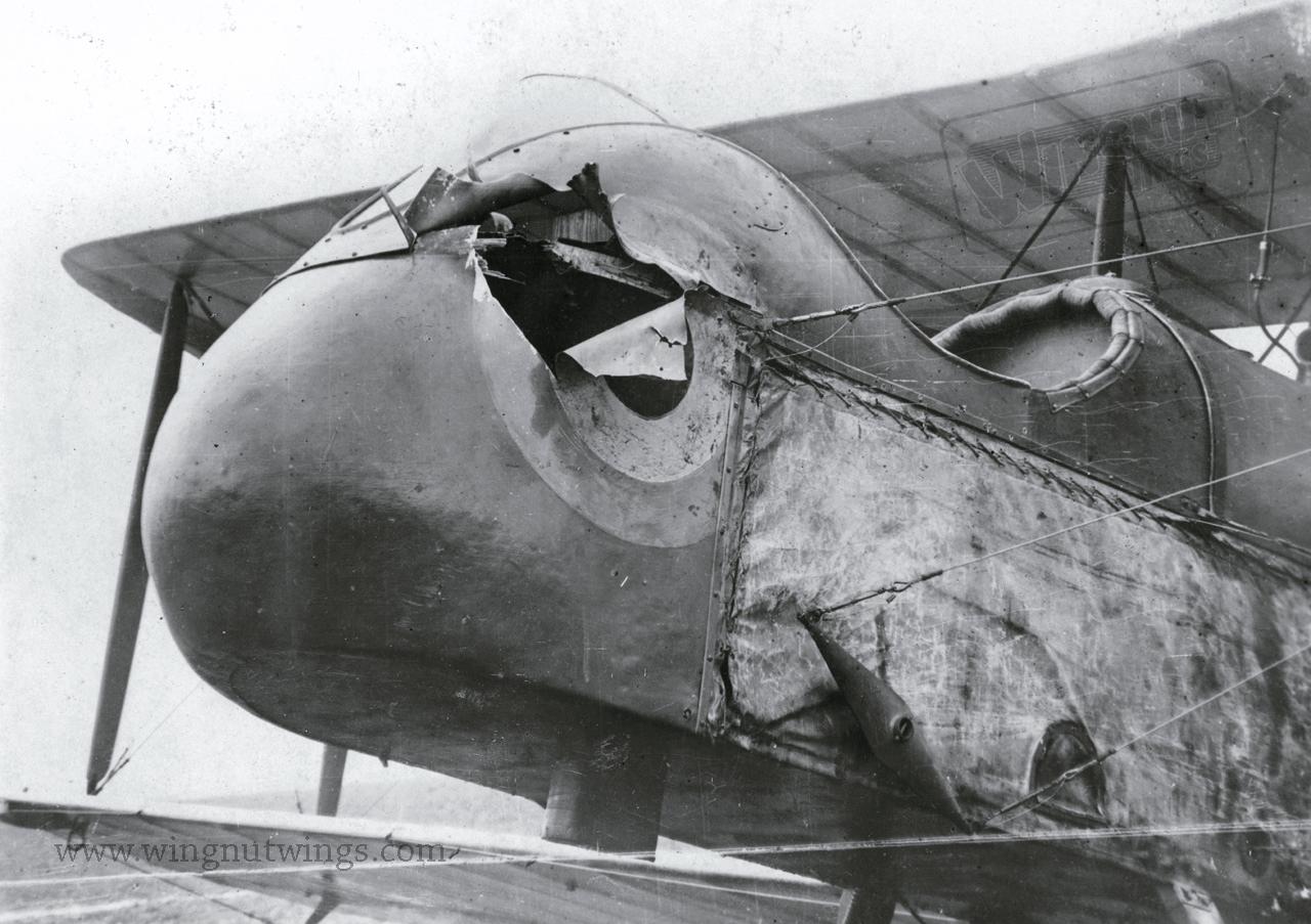

Nacelle bottom - Plywood, braced in the front with wood and cable in the rearmost bay.
Nacelle front and top - Thin aluminium.
This is the bit that doesn't seem to show up on pictures of the exterior of the aeroplane. I cannot find a picture that shows a joint between the metal front and the base. I can find pictures that seem to show thin material screwed to the longerons
Right, forget that - here's the joint:
From WNW: http://www.wingnutwings.com/ww/productdetail?productid=3038&cat=1
You can see where the metal front overlaps the floor
Excellent - I now know how to paint the underside
Richard
