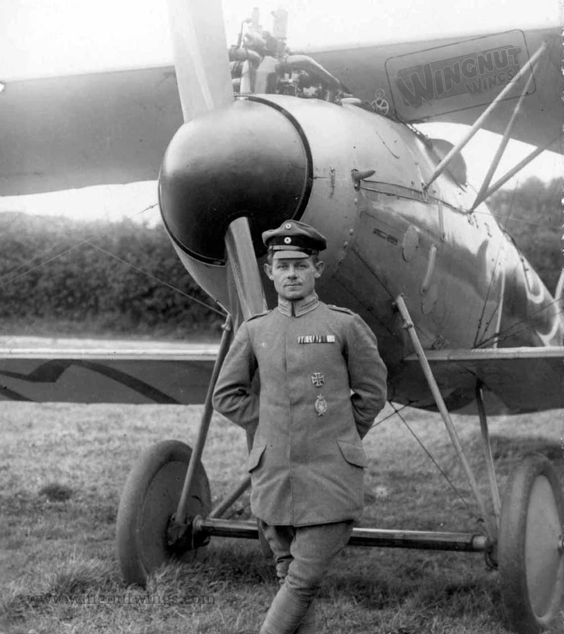

hi!
Im going to build the 1177/17 form WnW Von Richtofen kit.
From previous posts it looks like it has the early style nose panels.
Any more info on this? I haven't ever noticed it.
I have to trough my Windosck pubblications, surely there's something there, but anything in the forum?
Thanks
Andrew

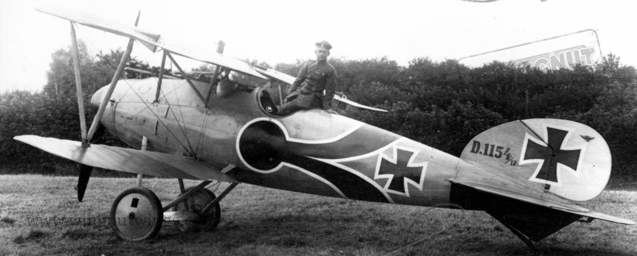

I have received some info on the panels from Bo. Seven planks  so combined with the photo I think I can estimate where to locate them. He has also mentioned that the Oil Pump access hatch needs to be moved so now I must puzzle through that one!

Final note on this one. Seven planks and the Hatch in question for an early Mercedes DIII powered DV is Molded in the correct position as is!
Re: Albatros DV lower fuselage nose panel question.
« Reply #10 on: June 20, 2019, 12:15:50 PM »
I am going to assume that by moving the panel lines I drew in on my build log a tad upwards that the other Plank is going to be straddling the center line.
correct ... they all appear to be about equal width, with a panel on the center line and three flanking.
Another detail difference on the very early Albatros D.Vs -- characterized by the big headrest and the longitudinal fore-aft under nose planking-- is former #5 describes a complete oval (not cut off at the top, like later versions) with holes on either side for the MGs. not sure if it applies to 1187, but my guess is it would.
I'll be modeling all of this stuff -- fore-aft planking, early "big" headrest, alternate former #5 -- for Aircraft in Pixels, so stay tuned for pix. Info based on factory photos kindly supplied by Jim Miller.
