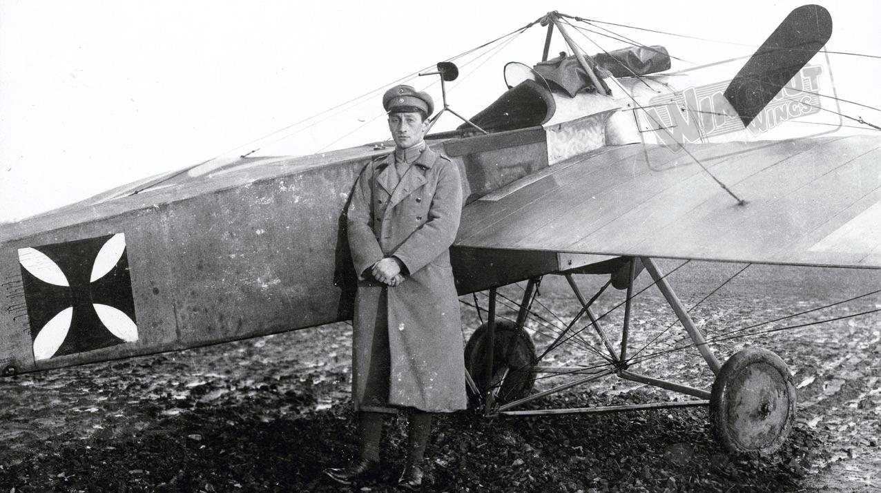

I agree. That's one reason I am interested in his method. I dug around in Wingnuts Wings reference photos and found this one of Von Althaus' plane. It's hard to find a decent closeup of the wing rigging with turnbuckle.
http://www.wingnutwings.com/ww/vCBAA8476/www/products/model_kitsets/32018/archive_photos/Fokker%20E.II%2036~15%20Ernst%20Freiherr%20von%20Althaus%20(0443-019).jpg
There is a definite eye-to-eye connection between the turnbuckle and the warp wire, something I can't see being able to duplicate with his method.
