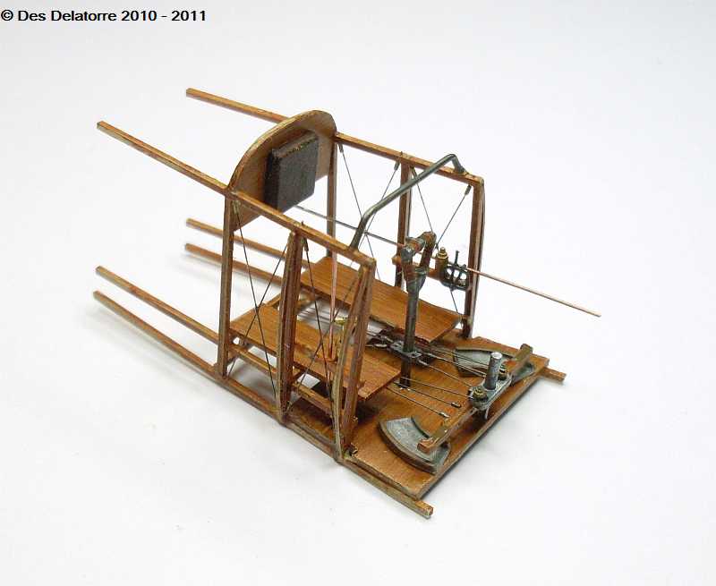

Re: Academy 1:32 Sopwith Camel
« Reply #34 on: May 11, 2013, 07:08:02 AM »
  Erik,
I believe Scott's on to something here my friend.
This is what I did.
 Sorry to have highjacked your thread a bit.
« Reply #35 on: May 11, 2013, 08:17:48 AM »
This is what I made to fit my Academy Sopwith Camel, as most of the inside is not seen once the fuselage is closed up I didn't make the entire fuselage framework, just what would be seen. Using Evergreen strips I ended up with a very strong assembly, and being made to measure it fitted perfectly.
Like Gregory, I'm sorry to jump in on your topic but it might give you a few ideas.

« Reply #36 on: May 14, 2013, 02:21:48 AM »
Thank you all for the great help !
Making the cockpit from scratch was a sort of last resort, anyway. Guess I'm at that point, now. Still, Part offers a lot of nice PE parts
that I still want - and going - to use.
Those Evergreen strips aren't much stronger than those PE parts but at least I can GLUE them properly with styrene glue !  |-)
