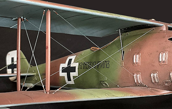

Teeny lettering was a bit of a trial Stephen  :P
The lettering came from an old Pegasus sheet which are handy things to have if you are a bit of a rivet counter and can't bring yourself to use a 'similar' number for effect

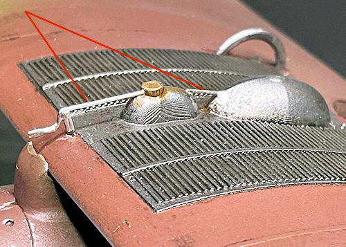

Woke up early the last few mornings and decided to get something useful done on this one. Much fiddling and I eventually sorted a way of making the fairleads for the elevator cables behind the rear cockpit. After trying stretched and non stretched tube paired together and drilling stretched sprue :o I eventually settled on making a single tiny hole in a scrap of sprue and then giving it a final sand when in position - Still a bit overscale, but better than nothing.
Tail and fin are just pushed into place to check the holes all line up (they didn't but, do now)  ;) Everything looks okay so just need to notch the extreme end for the rudder post/tail support and I get make that up and then get everything glued.
Here's the underside to give you an idea

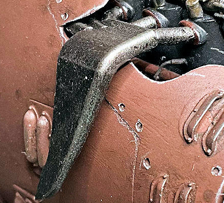

One small thing, on page one you mentioned exhausts. Rotaries didn't have exhausts, they vented directly to the atmosphere. What you refer to are the inlet ducts.
