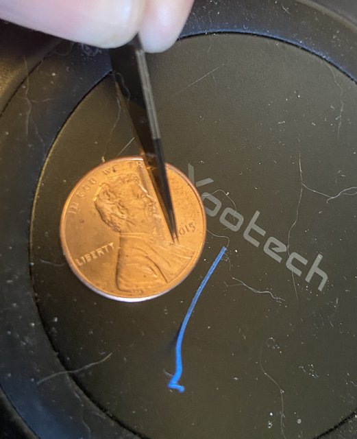

Hi Tim. It depends on how crazy you want to get with dimensions, but I've had some success with super-gluing two X-Acto blades together face-to-face, the slight offset of the blade tips (visible by the date on the penny) gives you a strip of whatever you're cutting that ends up being about .6mm wide:
It's an old trick from the days when graphic artists (we were "commercial artists" back then) had to actually cut & paste the art together to get it camera-ready. And if you really want to get involved you can shim the blades with paper or thin sheet stock.
Might be worth a try.
