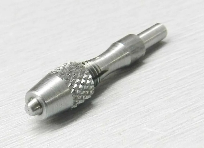

I have a Proxxon Micromot 230/E. The smallest collet is too wide to take very small drill bits (0.3 mm). Does anyone know of a third party brand collet that fits the 230/E?
I realise there is a big chance of breaking the small drill bits in a high speed devise, but I have some upcoming work fir which I want to use the 230/E in combination with the Proxxon cross side table:

Use .3mm bits from DBU. All the shafts are a uniform size (~1/8”) and will fit in any drill collet. I would not use a .3mm HSS drill bit in a machine, ever.

« Reply #8 on: October 05, 2023, 02:30:58 AM »
Thank you all guys.
I finally found what I was looking for in this older thread:
https://forum.ww1aircraftmodels.com/index.php?topic=13745.15
via the link in Reply #24 by Berman.
I fear Steve is right but I'm going to try it anyway  ;)

« Reply #10 on: October 06, 2023, 08:33:29 PM »
Ian, I have the same problem with the link. When I posted it, it worked just fine. What I make of it, the offer has ended. Sorry abour that.
However, I did find exactly what I need: a chuck for my Proxxon Micromot.
Again, closer to home than I thought:
https://www.proxxon.com/en/micromot/tools-accessories.php?search#28941

« Reply #12 on: October 13, 2023, 03:32:06 AM »
Late to the party - sorry.
I have one of the chucks pictured, but the quality is not where it needs to be - bits are off-centered.
That being the case, I use the carbide bits in a mill or drill press whenever possible.  Use a high speed and don't drill in too far each stroke to prevent breaking the bits.

« Reply #13 on: October 14, 2023, 02:31:58 AM »
This came in the mail today. It goes on my Proxxon Micromit 12/E.
It is mounted with a regular chuck still in the shaft. The new chuck has a spring system that closes the claws of the chuck as it is screwed on:
My 0.3mm drill bit fits snug between the claws. In this picture the drill is spinning. It is perfectly centered and doesn’t wobble:
Here is a setup ready to go:
I managed to drill a 3 mm hole in this brass plate. Gently easing down in several strokes, every time a little further.
I was expecting (as Steve did) that the drill would break instantly but to my surprise it didn’t.
This went much better that I anticipated and I am very pleased with the result:
The only issue I have with Proxxon tools is that the pins of the connector tend to stay in the power supply when pull it out….:
But overall, I’m a happy man!
