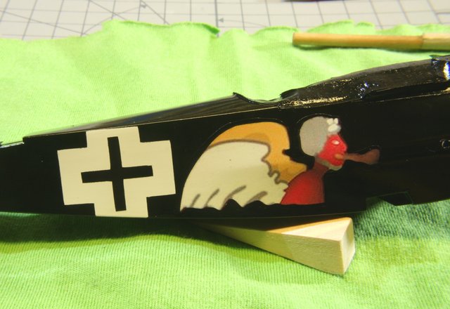

One way I overcome this limitation with inkjet printed decals is to paint a white background.  I have a Silhouette cutter that makes this somewhat easier.  For example:
In this case, the decal is printed with a black edge to hide any inaccuracies with the outline shape.
