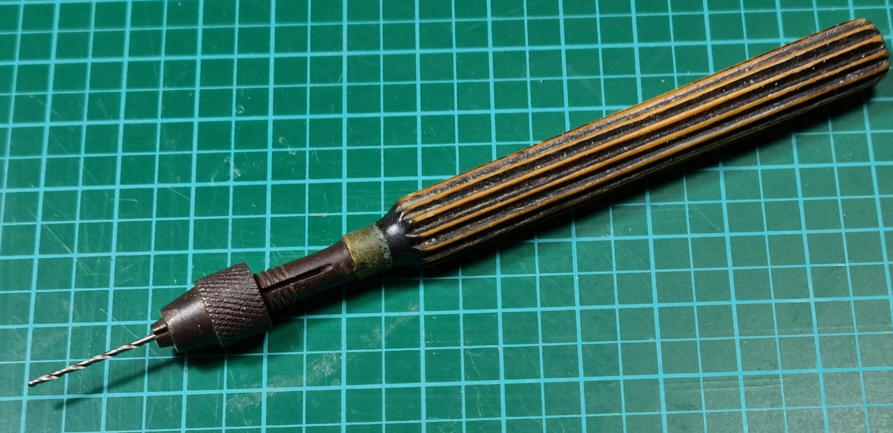

Hi all - every time I buy a pin vice, the chuck is off centre (see attached picture).
This makes it very hard to drill fine holes without constantly breaking the drill bit, or the bit shifting on the surface, due to the off-centre rotation.
Many years ago I had my old 'trusty' which was nicely centred, but it's worn out over time and will no longer hold the very small drill bits needed for rigging holes.
Where can I find a decent quality pin vice, with a centred chuck, and some good quality and durable drill bits (~80 size)?
Thanks in advance,
Brad

Interesting problem Brad. My pin vice is ancient, literally 19th Century inherited from my grandfather who used it for jewellery and watch making use.
I have some newer pin vices too but find the oldest one is still the best. With that in mind perhaps it's worth finding out what type of pin vice jewellers and watch maker/ repairers use today and source it from their source?
I think Tamiya do one too which may have a better centred chuck?

I have the same problem, not an off center vice, but one that cannot hold very thin bits as the hole doesn’t tighten well.
After some thougts I found that by inserting a strip of aluminium (I get my source from mayo tubes) in the vice, thus reducing the diameter of the hole, I can use also the thinnest bit....
may be you can give it a try...

Tamiya is spot on.
I own 2 and both are aligned perfectly in the centre.
Good luck!

My problem was that all the readily available pin vices were too big to hold a 0.3mm drill and the bit kept siding into the chuck. My problem was solved at SMW 2019 when I bought a Starrett pin vise.
 It comfortably and securely holds a jobber type 0.3mm bit and I love it. Highly recommended!

seconded, i bought my Starrett pin vice used on ebay. it's ancient. it's great, it's my favorite way to break drill bits.

I must just be lucky, this is a problem I have never experienced - even after buying more pin vices than I can count.
The current batch below - none has an egocentric hole, all work well, even the cheapies from ebay and flea markets!
