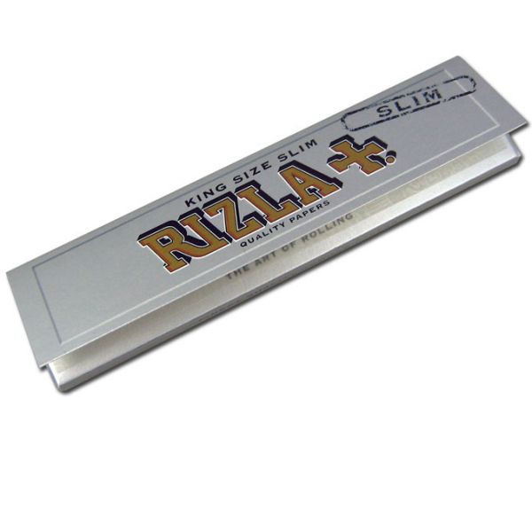

Hi Bill,
 I replicated the tape by cutting a thin strip from the gummy part of a cigarette paper. No need for glue, just spit 'n go!
vB
Offline Jeff K
  • Posts: 702
Re: Pfalz D.III/D.IIIa question
« Reply #6 on: January 30, 2018, 08:17:18 PM »
Hi Bill,
vB
cool idea. however, 'cigarette papers' are a pretty exotic material to me as a lifelong nonsmoker. any particular brand or type to look for?
« Reply #7 on: January 31, 2018, 12:43:46 AM »
   I actually used a length of Bob's "Strippers" on my D.XII, sanded down slightly it worked beautifully!
« Reply #8 on: January 31, 2018, 03:17:32 AM »
Hi Bill,
vB
Rizla Ultra thin Kingsize.
I gave up smoking 27 years ago, but I did roll my own back in the day, hence my understanding of the merits of fine papers  ;)
