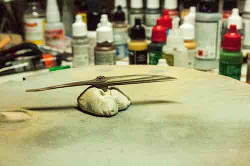

Hello Everybody,
in recent days, I finally came to the workbench again.
In the plan, the decals were to get on the wings.
Since this was new territory again, it was quite difficult this to get it. In addition, more of fright when you've done it the plasticizer, which then form the folds.
Unfortunately, some have remained few get, but I can live with.
Then I looked to my next "nemesis" in the eyes. The propeller! At first I was going to buy me a matching wooden propeller. But since there were problems with order, I have
opted for the propeller Template by GB Productions. The result can be seen in the photos.
The eyelets were prepared then be next. The holes drilled on the wings a little and then placed the eyelets. Thus, the stress is getting closer, because the rigging is coming nearer. But now I'm already
come this far, so I let myself not be beaten!
Thank you watching and leaving a comment.
I wish you all a nice time before christmas
Kindly regards
Jörg

Jörg,
the eyelets must be smaller in diameter. Use 0.09 or 0.10mm wire and wrap the wire around a 0.2mm drill.
try it
The prop is nice!
Your wing-lozenge is not bad - BUT beware, the lozenge on the lower wing is too near to the fuselage - there is no lozenge on the wooden wing stubs.
Sorry for the small criticism!
Greetings to Berlin!

« Reply #48 on: December 06, 2015, 06:29:35 AM »
Hi Bertl,
criticism is welcome. So i can learn. ;-)
mmh, i use a 0,1 mm drill ?! ::)
And your are right, i have to change the lozenge at the wing stubs.
Thank you very much for the hint.

« Reply #49 on: December 06, 2015, 06:32:15 AM »
Jorg
Overall nice work. Bertl is right about the fabric. Theres a line on the wing which is where the wooden stub is. the fabric should stop there.
On the eyelets I use Stainless steel braided hose from flexible water pipe, I cut them up and unravel the thin steel wires. The reason I use this is the steel is incredibly strong and thin. I use a small fishing hook fixed into a dowel or piece of sprue... remember to snip the barb off though :o to twist the wire tight.
Nice work and I jope the tip helps.
Keith

« Reply #50 on: December 06, 2015, 06:37:21 AM »
Oh - sorry Jörg, I meant to wrap the wire around a 0.1mm drill.
Twist the wire slightly narrower.
It goes relatively easily when the wire diameter is smaller.
