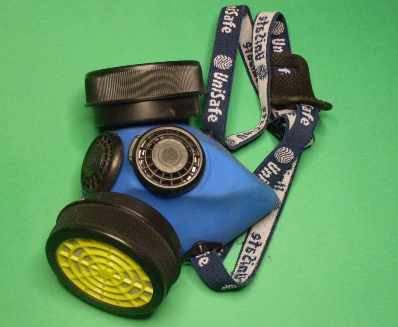

  Just to add to what Des said the respirator he's referring to is the cartridge type. If you plan on getting one of these make very sure you use the right cartridge for the job at hand,the wrong one is as good as not having one at all. If you're using or plan to use lacquer thinner or lacquer based paints the respirator really is a must if you value your liver. Thanks Des for bring up the use of a respirator.

This is the repirator I use, it has twin filters which are rated to keep out all chemicals, when I'm spraying lacquer I don't get any fumes through the filters at all, they do a great job. From memory, with the correct filters it cost around $60.00.
« Last Edit: June 15, 2012, 09:18:45 PM by Des »

My solvent for enamels is lacquer thinner for the most part, with Testor's thinner as the backup. I've got a dedicated modelling area with a window, so I can vent fumes from my paint booth directly outside. And yes, I use a mask that looks much the same as the one Des uses.

I've actually got a respirator like the one Des has, used for something else. Wont be using lacquer at the moment anyway.
