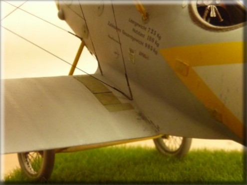

« Reply #9 on: July 23, 2014, 06:45:34 AM »
This is what AWG 29 polyamide looks like on .14mm graphite line (top) and .12mm maximal (bottom)
Bertl has pix on LSM of what he uses, of course it looks better but the above even is pretty microscopic.
OD of AWG 29 is .4mm (.0158")
