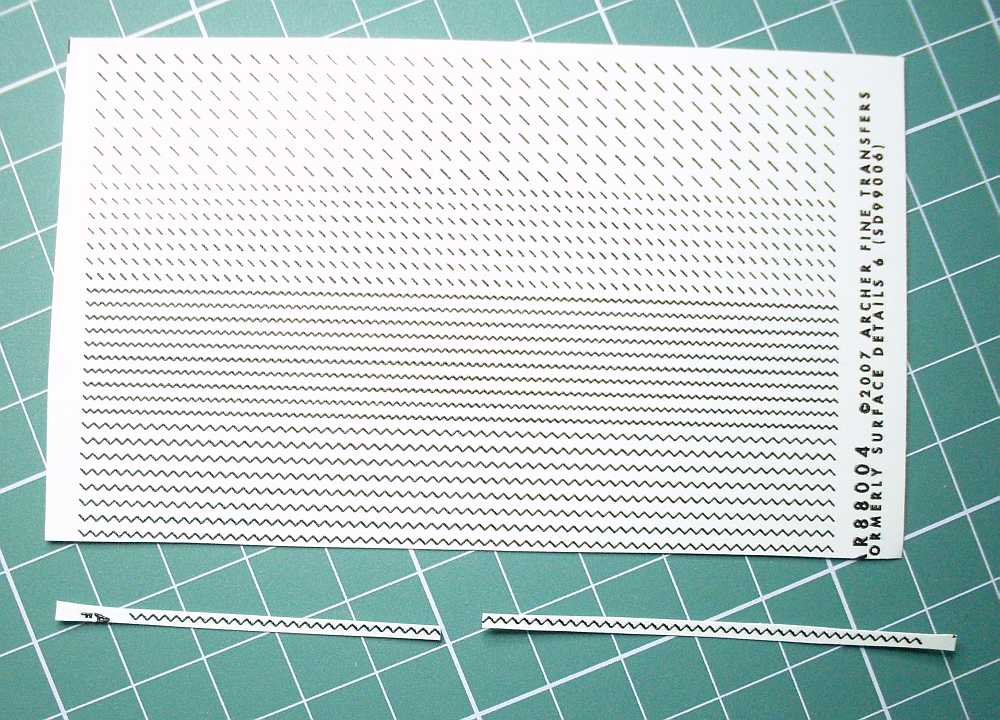

Resin Tape and Stitching - 1:32 scale WW1 Rib Tapes and Stitching - Product No. AR88044
Resin Armor Treadplate - Generic US Treadplate Pattern - various scales - Product No. AR88008
Resin WW1 Stitching - WW1 Stitching in 1:32 and 1:48 scale - Product No. AR 88004
Resin Tape and Stitching - WW1 Rib Tape and Stitching 1:48 scale - Product No. AR 88045
Resin Weld Beads - Perfect Weld Beads .015, .025, .030 and .040 inch wide - Product No. AR 88005
Resin Panel Lines - Raised Panel Lines Various Scales - Product No. AR 88013
Generic Placards - Black on Brass Dry Press On - Product No. AR35210X
Each card is enclosed within a plastic bag protected by a stiff card backing, instructions are also included with each pack. A stapled on label gives the name of the item, product number, price, the back of the label states the guarantee and gives contact details.
Opening each packet revealed very well cast and detailed resin on a clear decal film. The instruction are very easy to understand and include a link to a video tutorial which is very comprehensive and informative, well worth watching for anyone using these products for the first time.
For review purposes I will be selecting and applying items from the cards and fixing them to a sheet of white styrene sheet. There will be no preparation to the styrene sheet apart from washing in warm soapy water to remove and oil or grease residue. I cut strips off the card using a pair of scissors as recommended by Archer, try to cut as close as possible the the resin casting. A good sharp pair of scissors are needed to give a nice clean cut.
I cut my decal in half for ease of handling. Cut through the decal film with a sharp knife, I used my scalpel, make sure you do not cut through  the paper backing. The small section left is used for holding the decal for the next process, I used a pair of self locking tweezers to hold the decal but any type of self locking tool would perform the same job'
