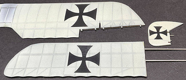

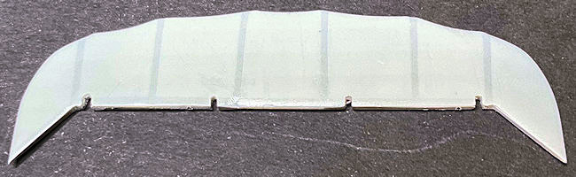

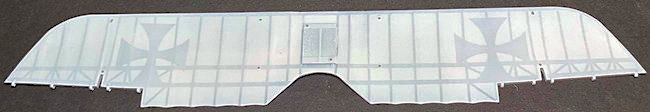

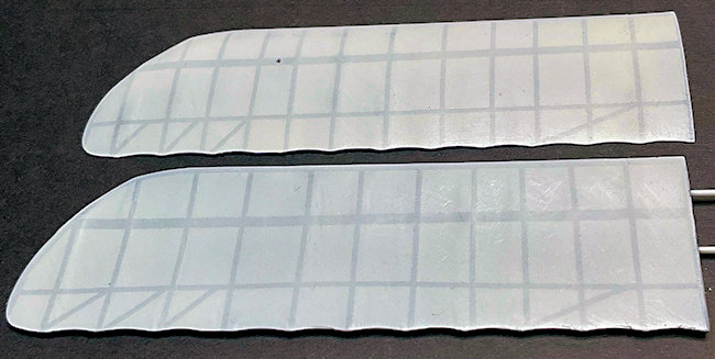

Hi all,
The basic flight surfaces are done.
Airbrush base coated with MRP Khaki Green 3/G3 (MRP-333)
Masked off internal structures with 1.0, 2.0 and 3.0 mm strips of masking tape.
Airbrushed first coat of MRP Clear Doped Linen (MRP-256)
Masking removed.
Airbrushed final coat of MRP Clear Doped Linen (MRP-256) to fade back the internal structures.
Aviattic Off White on Linen (ATT32241) decal applied to all surfaces.
Airbrushed a sealing coat of Tamiya Semi-Gloss (X35).
Kit decals not used for crosses as they are translucent and a bit fragile.
Instead I cut and used masks to airbrush the crosses with MRP Night Camouflage WW1 (MRP-255).
Now it's onto photo-etch parts on the wings before assembly and weathering starts,
« Last Edit: July 25, 2026, 01:26:06 AM by Mike Norris (UK) »

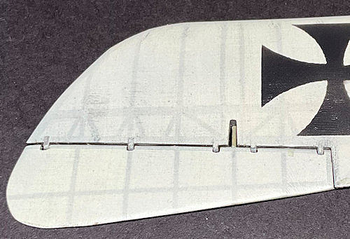

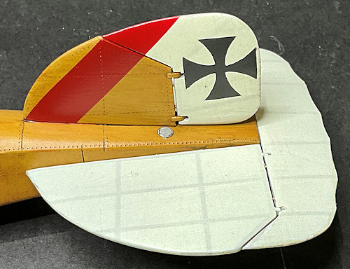

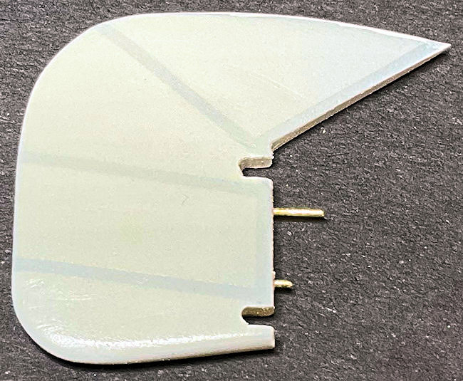

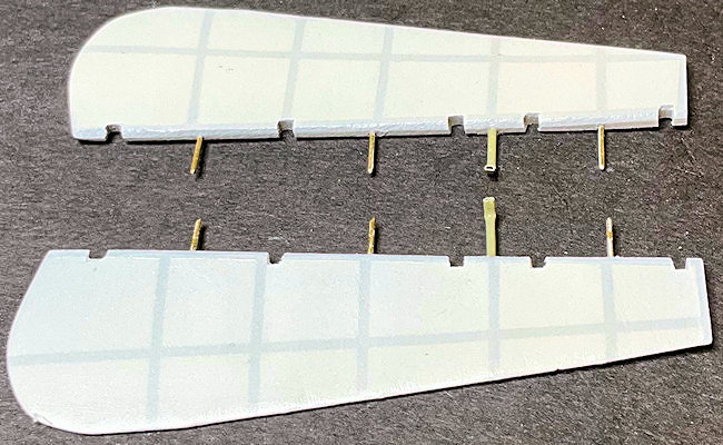

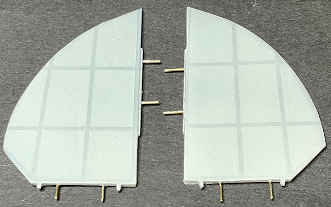

Hi all,
Just a few of updates.
The photo-etch access panels on the lower wing fitted.
Also the radiator brackets at the rear of the radiator on the top and underside of the upper wing.access
The rudder, tailplanes, elevator and ailerons fitted.
Also painted the red stripe across the fin and rudder.
Next step is to weather the flight surfaces,
