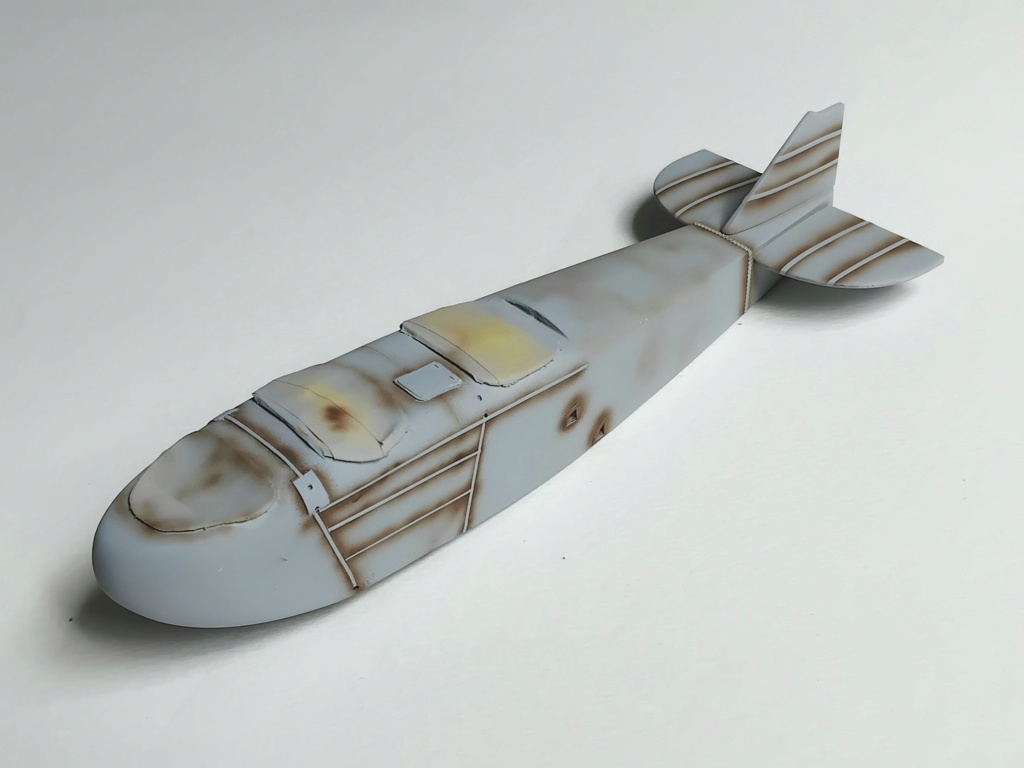

OOEFFAG D.III - WORKSHOP UPDATE
Painting the Panels and Leather Cockpit Rim
Work on the interior of the fuselage continues. Obligations still make it hard to stay as engaged as I'd like, but I've set a goal: to finish the interior before joining the fuselage halves. Day by day, I managed to push things forward.
This time I focused on separating the engine access panels and preparing them for painting. Everything got a black primer coat, followed by surface modulation using a mix of colors, then silver, and finally chipping and wear. Doesn't sound like much, but masking four fuselages and rotating the paint stages took me several evenings. Luckily, I'm satisfied with the final effect - just one last step before simulating the wood grain.
Next came the leather cockpit rim. Access to this area will be limited once the fuselage halves are joined, so I decided to paint the interior portion now. More masking - time-consuming, but not difficult with some patience. After applying a dark brown base color, I added highlights and cracking using the dry brush technique.
Wood Grain Painting
Time to simulate wood. I used oil paints - artist-grade, which have worked well for me in the past. To introduce some visual variety, I opted for two wood tones: a slightly mahogany one around the engine section and a more classic tone for the rest. Not much of this will remain visible, but since I'm taking photos anyway, I couldn't leave it half-baked.
The resin-printed surface turned out to be a bit different from plastic - less smooth, which affected the brushwork when simulating wood grain. This required a slight adjustment in technique, but the results are satisfying. Now it'll sit for at least 24 hours before I apply a protective varnish coat.
If you'd like to see a video of this stage, it will be up soon on my socials. As always, links are in the footer.
That's all for today!
Lukasz
